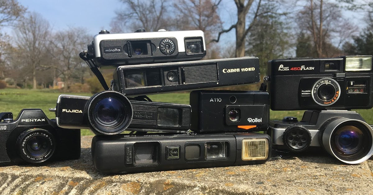

The Ektramax definitely looks interesting. It has a max shutter speed of 1/125 unless you can find 400 speed film as it uses the cartridge speed to determine exposure settings. w iso 400 film you get 1/350 to 1/30 in 4 steps.
The Rollei A110 gives you 1/400 sec to 4 seconds steplessly, automatically. It is also much smaller than the Kodak, and much nicer built out of metal instead of plastic.

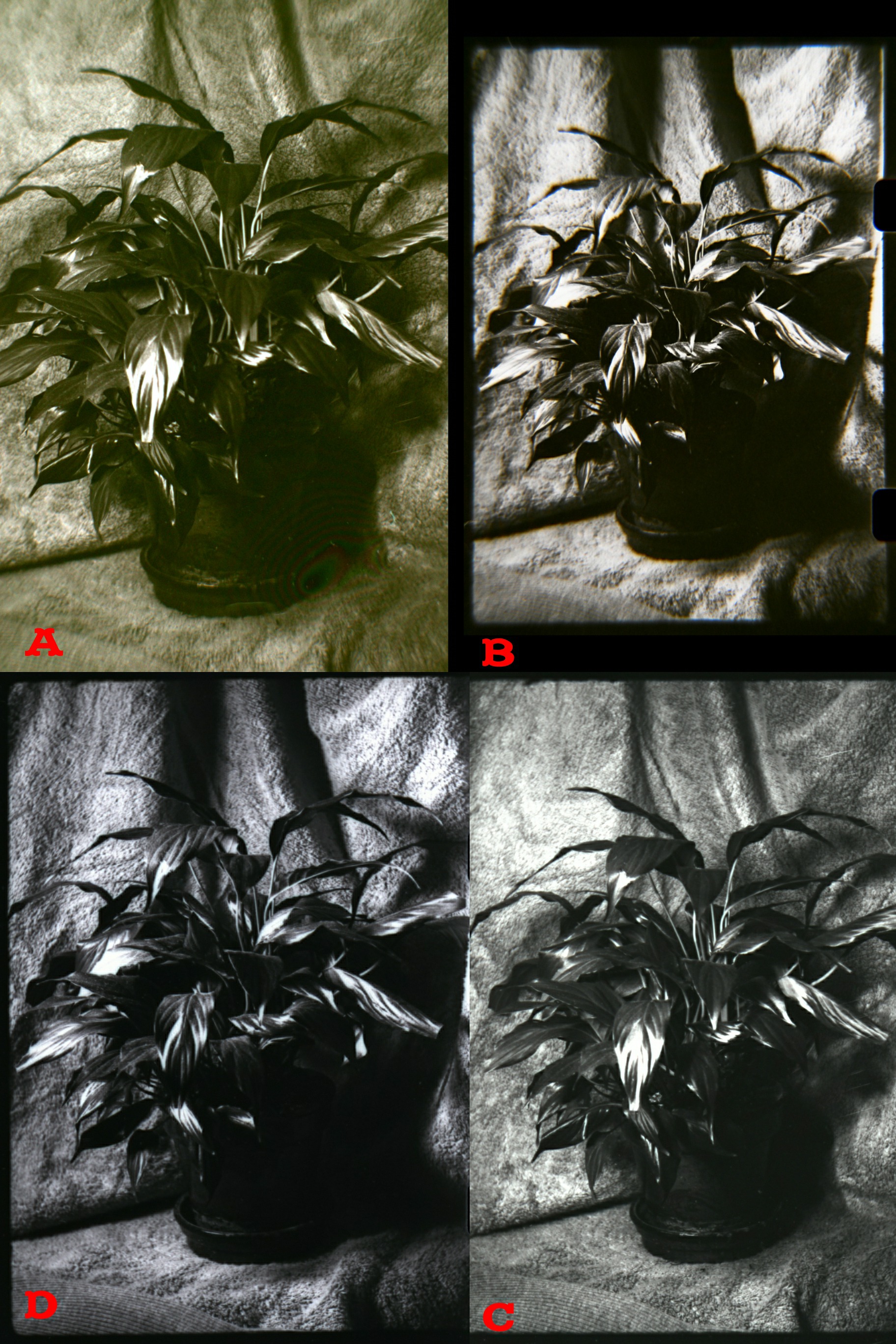

I've discovered two convenient configurations using a Nikon 1 body (a V2 in this instance) to digitize variously sized 16mm/110 frames. In both cases, the camera lens/hood is in direct contact with the glass on top of the negative so alignment is simple.
Mamiya 16 De Luxe
FPP Sonic 25, DK-60a 1+3 9'
A - 18.5mm f1.8 on 16mm of extension tubes w/ lens hood at closest manual focus gives a minox-ish size crop from a 10x14mm frame. Newton rings!
B - 11-27.5mm@11mm f3.5 on 10mm of extension tubes at infinity focus. Covers 10x14mm pretty well and probably 110 with a slight crop.
C - V800 scan 2400 DPI. Same frame as A.
D - V800 scan 2400 DPI. Same as frame B.

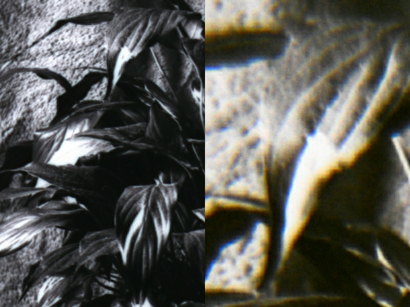

And of course 100% crop from the V800 and the V2.

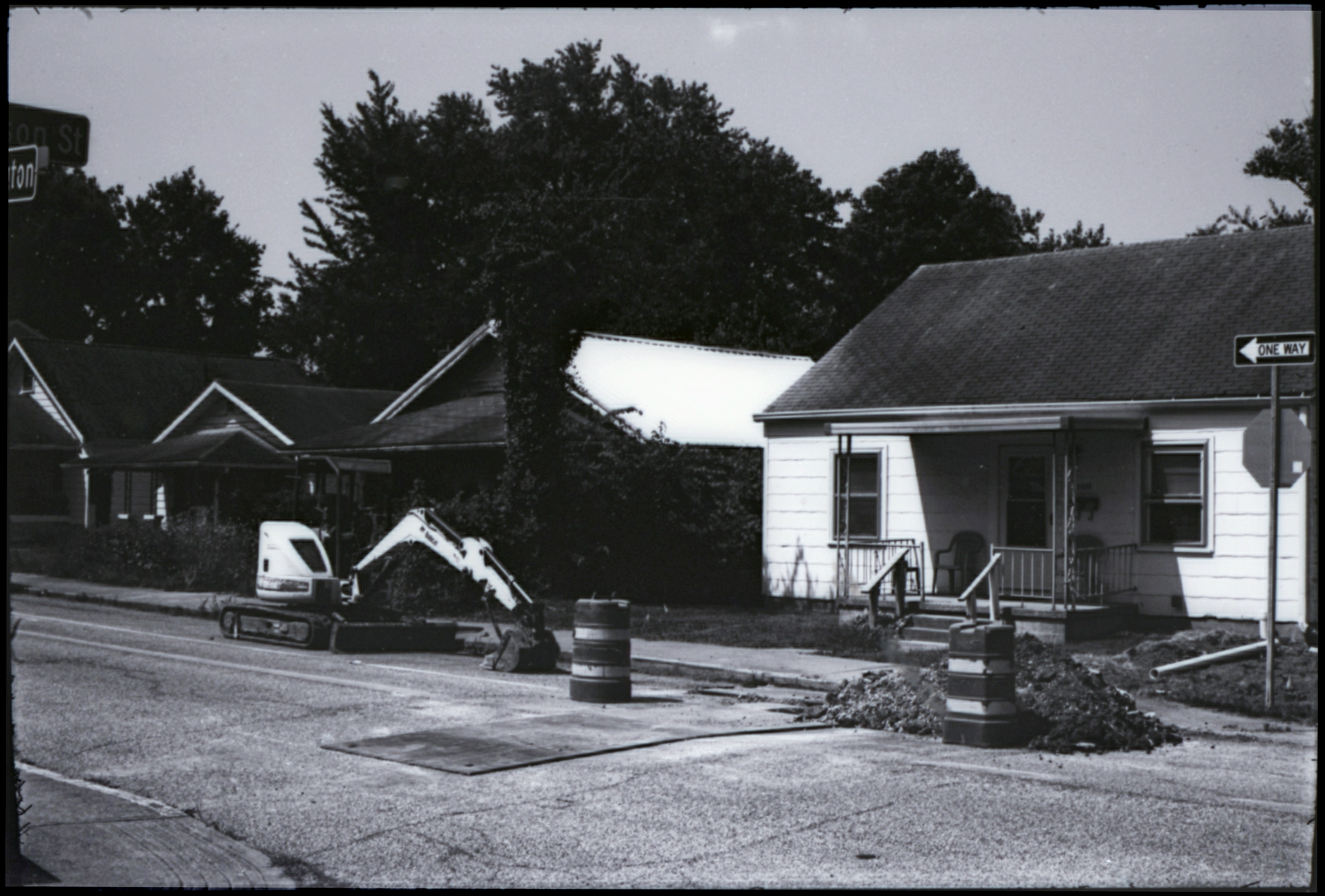

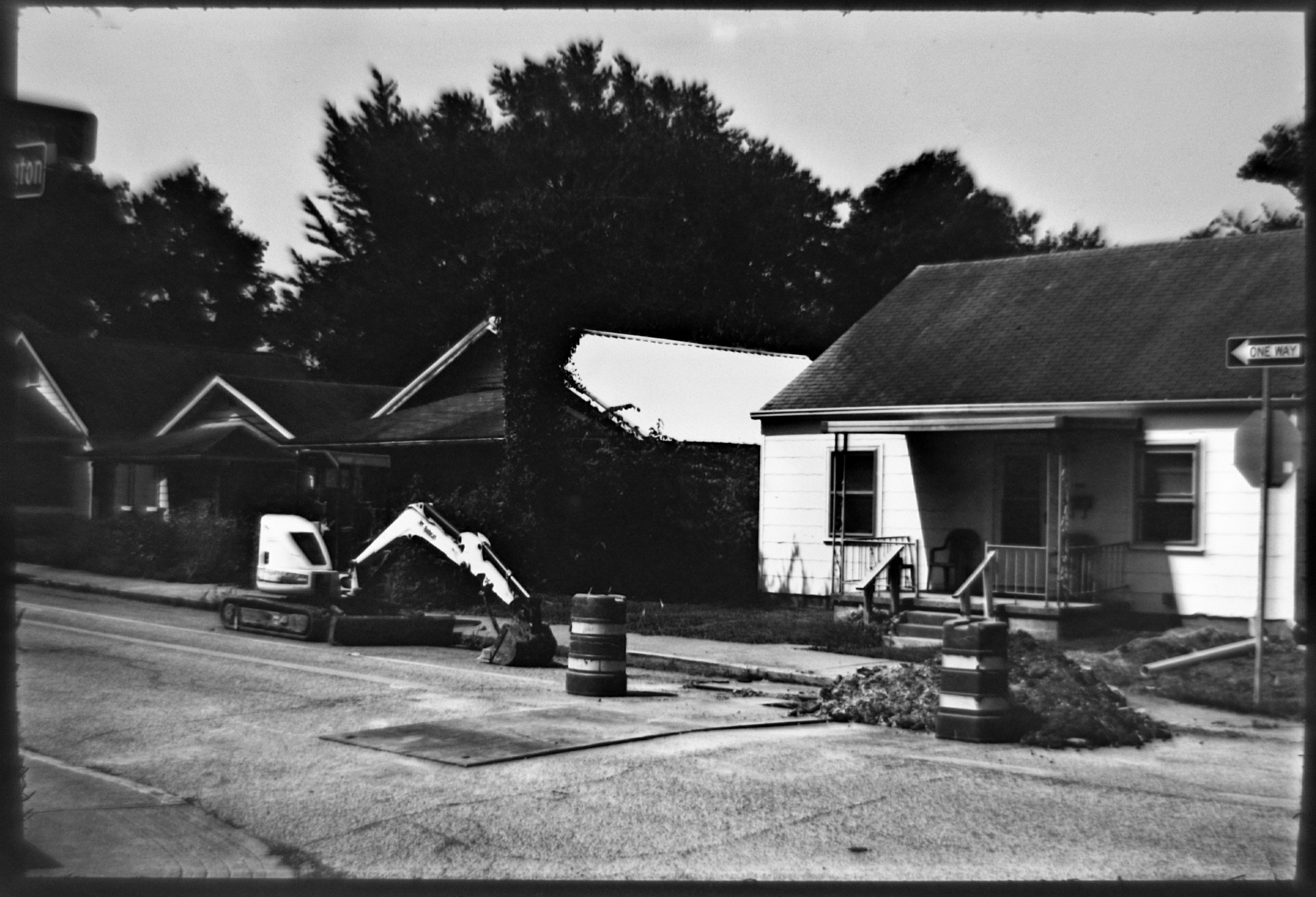

Minolta MG-s, shutter priority
FPP Sonic 25; D-23 stock 8'
V800 scan & J5 digitization
First attempt with this combo to see the effect on contrast / density. Not as contrast-taming as I'd hoped, some uneven development (I'm looking at you, yankee clipper), and shadow speed suffers as well. Great middle tones though. The house and adjacent roof blew out much faster than the blue sky, which is odd. Maybe I need a UV filter.
