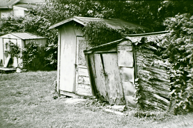

The grain & tonality remind me of a panchromatic version of FPP Sonic 25 (3378) which I've been shooting as of late. I've mixed up stock solutions of D-23, DK-60a, and D-19 to go along with last year's champion, a new gallon of Xtol, in hopes of squeezing flatter negatives out of this film. Great stuff if you can deal with its ortho-ness; a yellow filter might help.
Minolta MG-s, shutter priority
FPP Sonic 25; D-23 stock 8'
V800 scan & J5 digitization
View attachment 309767View attachment 309768
First attempt with this combo to see the effect on contrast / density. Not as contrast-taming as I'd hoped, some uneven development (I'm looking at you, yankee clipper), and shadow speed suffers as well. Great middle tones though. The house and adjacent roof blew out much faster than the blue sky, which is odd. Maybe I need a UV filter.
A yellow filter might help but I think it's just the nature of this film, it just is like this. It's really not made for what we're doing with it. Either you're getting the shadows or the highlights but never both.

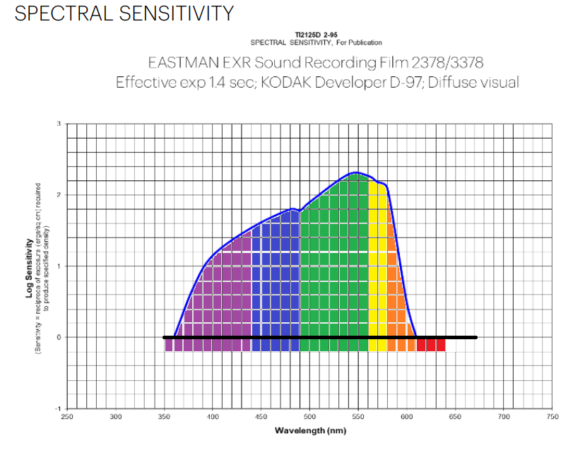

Yeah, the characteristic curve is pretty steep, even steeper than Fuji x-ray film. The best bet for 'normal' contrast is probably overexposing at 6 or 12 ISO and using a super dilute compensation developer, ala your rodinal stand.
The datasheet confirms my suspicion of violet sensitivity, although the peak is clearly green.
The sensitivity curve is also a snazzy hat.

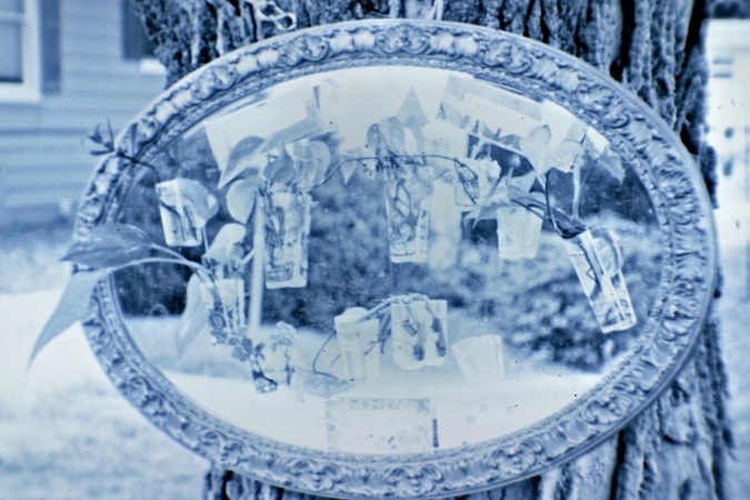

Chiyoda Minolta 16
FPP Sonic 25, DK-60a 1+3 8'
DK-60a generates decent negatives when bracketing some exposures a stop or two down. Great with Double-X as well.
Okay, if you used real density figures, I'd have no argument then. Worst case, if your working solution differs a slight bit from mine, you'll have to adjust the development time a little.

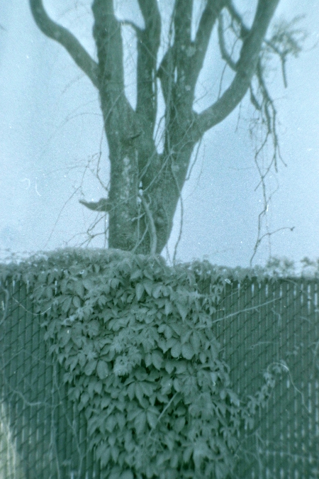

Tried out the Caffenol-LC+C earlier and its quite promising despite a high base fog... but ooo that smell. It was overcast today and I suspect FPP 25 doesn't lose as much speed as my meter thought. There were a handful of well-exposed frames, but most were blown and I had to bleach & re-fix to get an image. The well-exposed negatives are good candidates for printing. All camera scanned with the J5 (i.e. minox-ish crop from a 14x10mm frame; edge distortion is due to the J5's lens, not the mamiya's).
Mamiya 16 De Luxe
FPP Sonic 25; Caffenol-LC+C 15'
Unbleached
Dilute copper bleach ~2', re-fixed. This eliminated the base fog (and probably a bit more) and appears to have copper-toned the remaining silver.

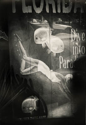

One developer I wouldn't mind trying again is Beutler's. It was a little too contrasty at regular strength, but maybe diluting it would make it decent for those high contrast films. Here is a scan from a print with Kodak RAM developed in regular Beutler's. Not too shabby.
Here is an image on Kodak RAM developed with Caffenol CL-CN. Holds up pretty well. It might have been a little underdeveloped but this is a straight scan on a flatbed. I don't recall what the neg looked like offhand.

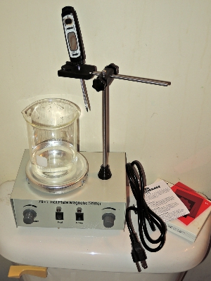

I finally redeemed my long-suffering Amazon(R) Reward Points(TM) to upgrade my darkroom. Dissolving borax? No problem...
