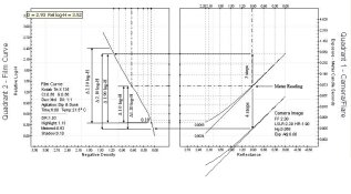

Okay, there's just a little more that I didn't get around to showing. The two quadrant example shows in graphic form how Zone System in camera testing works. The idea is to meter a grey card and stop down four stops to find Zone I.
As you can see on the camera image / flare curve, the affects of flare are minimal at the point of the meter reading (Zone V). And that is with a full range subject. A grey card has only a single tone. This means that there will be almost no flare at the meter reading.
Stopping down four stops shifts the camera image curve down 1.20 log-H units. You can see that the exposure will fall below 0.10 Fb+f on the film curve (assuming the test is at the film's ISO). In tone reproduction theory, the shadow exposure falls even lower down on the curve, but flare will bring it back up to around the 0.10 Fb+f density point.
For the Zone System, with it's no flare in camera test, the EI is adjusted in order to bring the Zone I shadow exposure up to 0.10 Fb+f. The difference is about 2/3 of a stop. This is why most people find their personal speeds to be 1/2 to 1 stop below the box speed with Zone System Testing.
This 2/3 stop added exposure is important in the negative density part of the Zone System test. Once you have your personal film speed, the next step is to find the aim negative density range for the processing. According to the Zone System, this is done by metering a grey card and opening up 3 stop to Zone VIII. The exposure range from the Zone System with the Zone System test now covers 2.10 log-H units from Zone I at a density of 0.10 Fb+f to Zone VIII which is around 1.15 to 1.25 over fb+f. That represents the exposure range for a subject with a 7 stop luminance range.
But a seven stop luminance range will produce flare in the camera which will bring effectively change the exposure range from 7 stops to around 6 stops. This will translate to the highlight falling at a point lower on the film in normal shooting conditions as opposed to the testing conditions.
This isn't going to change the resulting negative in anyway. Basically it's a numbers game. Adams found the right processing to match the film to the paper, but he is using a different set of variables. Variables that didn't correctly define the actual conditions, but ones that will produce the same results. Personally, this is what lead to my confusion why two stated NDR aims still printing well on the same grade of paper. The reason is that one of them isn't the one that you will get in actual shooting conditions, it's the one that works for the test.
The second attachment shows the two sets of variables on the same curve. The highlight densities on the curve are read at different places on the same curve. That means that for whatever the scene photographed, it's going to reproduce the same. The reason why it is possible to be able to come to this conclusion between two different testing methods (in camera and sensitometric), is by finding the variables common to the two methods and to applying them.
The Zone System has a seven stop luminance range for the test with a aim negative density range of 1.15 to 1.25. Tone Reproduction has a 7 1/3 stop luminance range for normal with a negative density range of 1.05. The subject luminance range becomes the log-H range along the x-axis of the film curve. The negative's density is plotted alone the Y-axis. From this we can calculate the slope or gradient of the film curve. Slope is a number indicating how steep the curve is and can be used to determine the output value expected (density) from the input value (exposure).
Slope = RISE (Density Range) / RUN (Exposure Range)
Zone System variables as stated in book, The Negative:
1.25 (NDR) / 2.10 (7 stop exposure range) = 0.60 gradient
Tone Reproduction variables
1.05 (NDR) / 2.20 (7 1/3 stop exposure range) - 0.40 (flare) = 0.59 gradient
The two gradients deduced from the different variables are practically identical. That means if either of the two methods are followed, they will produce the same negative.
As flare exists in the real world, we can assume the resulting negative density will not be 1.25 but 1.05. The big question is why do people believe the Zone System method produces a 1.25 NDR when it is in fact producing a 1.05 NDR? My guess is that few follow up and check the negatives produced in normal shooting conditions. They do the test and move on happy to have a good working negative. Second, even if some attempt to read density range from a negative shot in the field, it's there are many potential difficulties. What was the actual scene luminance range? How much flare was there? Zone I to Zone VIII do not represent the complete subject luminance range. There is always accent black somewhere and specular highlights. This can confuse the Zone to density relationship. You might be reading a density produced from a Zone VIII exposure. Finally, as the Zone System uses two points of density and not a negative density range, any changes in exposure will increase the highlight density but not the density range. The increase in overall density can easily be mistaken for an increase in the density range.

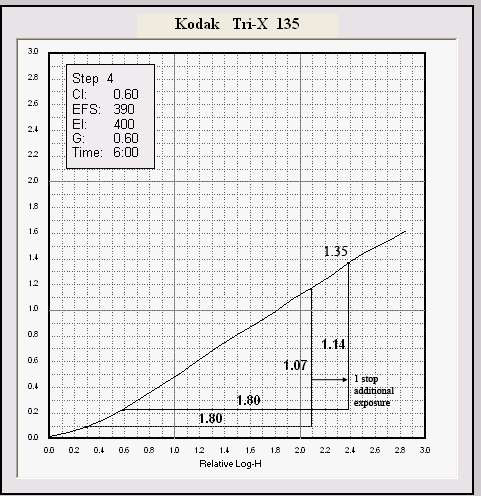

The last attachment shows how additional exposure shifts the entire exposure range to the right. While there's a slight increase in the negative density range from the shadows moving off the toe, it is essentially the same. However, if you to only read the highlight density, you can easily assume the NDR was 1.25.
Here's the kicker. As I have shown, the Zone System method consistently produces personal film speeds 1/2 to 1 stop below the ISO rating. This is less about your personal conditions and more about them being two different testing methods. If you were to have identical processing conditions, the resulting film speed values will still fall 1/2 to 1 stop apart. Again, the reason for this is flare.
So while the adjustment in the EI with the Zone System method is necessary to bring the exposure up to produce a negative density of 0.10 Fb+f in the test, flare from the actual shooting conditions will add to the exposure. Technically, the Zone System testing method will over expose the film 1/2 to 1 stop when the personal film speed EI numbers are applied in the field.
So if every step is properly followed in the Zone System testing, the placement of the exposure on the film will be closer to exposure B than exposure A. And that is a possible reason why it's possible to confirm the 1.25 negative density range while it continues to remain a ~1.05 ish density range.
To finally conclude, let me just say, that there's nothing wrong with any of the results obtained from Zone System testing. There's nothing wrong with the actual NDR just the perception of what it should be. The example at the beginning of the thread was kind of a trick. All I did was to present two identical conditions in different ways.
There's also nothing wrong with the slightly greater exposure. Not only doesn't it hurt quality but it can actually improve it by allowing for greater shadow separation as they move off the toe. Remember that film speed were a stop slower before 1960 and that didn't hurt quality. The difference in film speeds before and after 1960 also is proof that the Zone System method does lead to some over exposure. The 1960 change was do to a change in the way speed was determined. Partly because of the introduction of lens coating, and improvements in exposure meter accuracy, a one stop safety factor was eliminate from the standard. Films like Tri-X went from having a 200 ASA to a 400 ASA.
While the ASA standard changed, double the b&w film speeds, the Zone System method didn't. The one stop safety factor from the pre-1960 standard essentially masked the fact that the Zone System didn't factor in flare. When the standard changed and the Zone System remained the same, this difference became noticeable as personal film speeds suddenly were different from the box speed.
BTW, all the graphs come from plotting programs I've written. While there are a number of plotting programs on the market, none of them offered the tools to allow me the degree of analysis I wanted. I've found my programs to be an essential tool in helping me understand tone reproduction and exposure theory.
Thanks to those who patiently stay with me on this.
Bill Burk
Feb 9, 2010
9,482
Max and Paul have expressed very well thought sentiments. The zone system is a tool that will be of limited use to most, and of limited interest to many.
I was going to say the same using words that have a subtly different connotation: Many photographers understand the Zone System, to a limited extent.
It is _easy_ to get your head around the Zone System to that limited extent.
Simplified to ignore flare.
Flare is not necessarily desirable but (if I get it right) tends to cancel out and it tends to work in your favor as it varies. Getting your head around flare takes some work but I enjoy trying to get deeper understanding.
Bill must have been using reversal film! :D No latitude. Also, working at Kodak, he must be a very lonely person nowdays.
PE
Ha,
I use TMY-2, you are right, I don't have to use any system. At Kodak, I work in the graphic-arts side with a small group of very talented people.
Photo Engineer
Apr 19, 2005
29,018
Rochester, NY
Well Bill, I was thinking of all of those deserted empty parking lots along Lake Ave. They used to be full and have a waiting list for prime parking spots.
I remember also the 3M and Dupont graphic arts coating plants off Mt. Read.
PE
MattKing
Apr 24, 2005
55,377
Delta, BC Canada
It's funny, but I find that if I struggle with some of the most technical of these threads and thereby begin to understand the issues at least slightly, I also gain an improved intuitive understanding about what I want and intend to do.
Maybe that is because I'm the sort to wonder: "why did that work the way it did"
Thanks Stephen and everyone else who contributes.
Photo Engineer
Apr 19, 2005
29,018
Rochester, NY
Matt;
You have offered a very good perspective on the use of the zone system and threads like this.
PE
Bill Burk
Feb 9, 2010
9,482
I finished my tests and chart for TMY-2 in D-76.
Now if I accept and adopt the Kodak CI chart - I can be done testing. For any paper, I can get its LER. For any subject brightness range I can get a recommended CI. From my charts I can interpolate processing time for that CI.
So to translate my lab results to Zone System...
Assuming Grade 2 LER 1.05, diffusion enlarger.
Adopt 7 stops = N, because Minor White says so. Zone I to VIII
N+1 = 6 stops SBR, CI 0.75 = 16 minutes. EI about 440
N = 7 stops SBR, CI 0.62 = 13 minutes. EI 400
N-1 = 8 stops SBR, CI 0.53 = about 11. EI about 320
N-2 = 9 stops SBR, CI 0.46 = about 9:30. EI about 320
N-3 = 10 stops SBR = CI 0.40 = 8 minutes. EI 200
http://www.beefalobill.com/imgs/Sept9TMY2.pdf
Stephen Benskin
Jan 7, 2005
2,743
Los Angeles
Bill, what are you basing them on? They seem a little high if you are only using the two variables 2.1 and 1.05. Are you planning on plotting a Time / CI curve to extrapolate the processing times?
Bill Burk
Feb 9, 2010
9,482
A Time vs CI curve is a great idea.
If the times seem long, it might be because I hand develop in small trays with CompnTemp control.
I usually hit ASA around 13 minutes, so these results are consistent with my usual Time/CI.
The CI choices are based on 6 (1.8), 7 (2.1), 8 (2.4), 9 (2.7) and 10 (3.0) stops subject brightness range from the Kodak chart across from 1.05.
Stephen Benskin
Jan 7, 2005
2,743
Los Angeles
Right. Would now be a good time to talk about the pros and cons of a fixed flare developmental model compared to a variable flare developmental model?
Bill Burk
Feb 9, 2010
9,482
And don't forget the "practical" flare model too. I suppose a "real" flare model should be discussed, with examples. Example deep forest with sunlight breaking through => more flare than SBR alone would indicate.
By the way. Do you know which model is used in the Kodak CI chart?
2F/2F
Apr 29, 2008
8,031
Los Angeles,
I hate to say this, but over the last 60 years or so, I have known literally hundreds of "famous" photographers and truth to tell, not one of them used the zone system to my knowledge. And, when it gets down to it, the zone system is a reduced form of Densitometry and Sensitometry. Nothing more than an H&D curve with a glorified name.
I've said this before in other posts. Sorry. I probably should not say it here and I will take a lot of heat over this.
PE
I am with you...but it really sounds like you don't hate saying it at all. Nor should you.
Stephen Benskin
Jan 7, 2005
2,743
Los Angeles
Damn, looks like I need some new material.
Actually, the deep forest scene might have less flare. Large amounts of dark with small amounts of light.
The CI Chart was given to me by Dick Dickerson. It's uses the fixed flare model. I have to assume it still applies to the rest of Kodak. Interesting enough, pushing for speed has the same or almost the same CIs as the variable.
To me, the fixed is too extreme on the ends and the variable has the potential to be too little. The practical model is just right.
Bill Burk
Feb 9, 2010
9,482
Well I guess the fixed flare model is better than no flare model, right?
The Time / CI chart is done. But the answers are the same as my guesstimate.
I'm sure it will come in handy anyway.
Stephen Benskin
Jan 7, 2005
2,743
Los Angeles

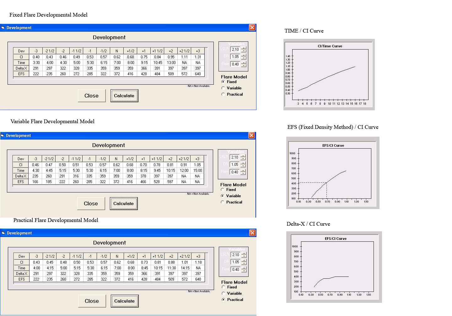

Look this over and decide which looks best for you. They are based on LSLR 2.10, NDR 1.05, and 0.40 Flare.
  • Developmental Models for 2.1, 1.05, 0.40.xls
Stephen Benskin
Jan 7, 2005
2,743
Los Angeles
Bill,
This example has the processing times, EFS, and Delta-X speeds using the three different dev models.
Bill Burk
Feb 9, 2010
9,482
Thanks Stephen,
From the spreadsheet... N and N-1 are the same in all models.
N+1 recommends slightly less development practical vs fixed.
-I might stick with fixed flare model times for plus development because, by the time I identify a neg that needs more than N development, the more the merrier.
N-2 and N-3 recommend slightly more development practical vs fixed.
-I might take the practical flare model times for minus development times to avoid short development times that lead to uneven development.
I have some paperwork to do (find the LER I really want to target).
Stephen Benskin
Jan 7, 2005
2,743
Los Angeles
That's how I like to do things too. Know what the facts are and then make the decisions that work best for you.
I'll send you some more comparison stuff on the different models. As you saw, the differences start to show in the the further out from normal. If I remember correctly, a +2 with the fixed density has the same CI as a +3 with either the variable or practical. That's when the differences become more significant.
Stephen Benskin
Jan 7, 2005
2,743
Los Angeles

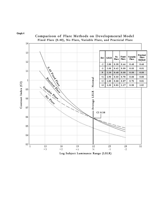

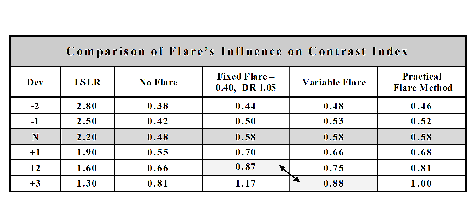

Bill, I've attached a few more things. The pdf file is of an unpublished paper I wrote which is basically about this very subject. The other two files are a chart and a graph from the paper.
The graph is a plot of the CIs produced with each flare model. The variables were LSLR 2.20, NDR 1.05, Flare 0.40 (at 2.20).
The chart are the CI values from the graph in a nice little table.
This a continuation of one of the themes of this thread and that is the importance of having a testing method that reflects the conditions of the real world as well as able to accurately predict the results obtained in real world use.
Which flare model is most accurate? Which one will produce the best results in the highest number of cases? There are times when the question can be more than just an academic one. Look at the difference between +2 Fixed Flare and +3 Variable Flare.
Something else to think about concerning the topic of what best reflects "reality". Take a look at the speed values from my last post's attachment. There are the results from two different speed determination methods. The speeds were derived from the same set of data. They only difference was how that data was interpreted. Unlike with the NDR example, the difference in speeds isn't an illusion. The one labelled "EFS", effective film speed, uses the fixed density method where the exposure is calculated at the point on the log-H curve where the negative is at 0.10 Fb+f. The other method is the Delta-X Criteria which is a simplification of the fractional gradient method. The ISO speed determination method is an example of the Delta-X criterion.
The two speed/CI curves show the results of the two methods in graphic form. The differences in results between the two methods raises some interesting questions about what we think we know about film speed.
  • What is Normal.pdf
