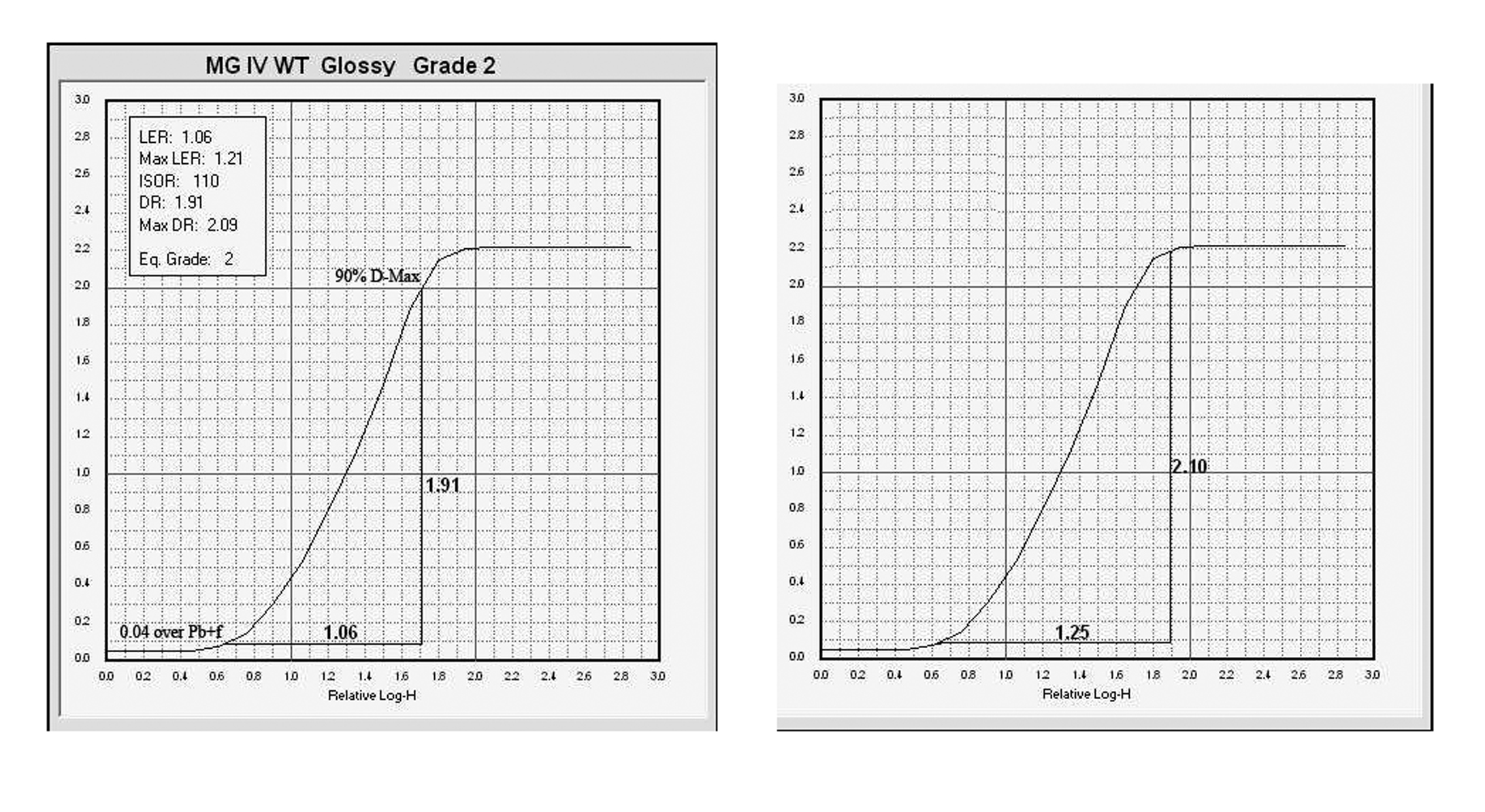

Mark, you are bang on in framing the problem! The average LER for a grade two paper is 1.05, as is shown in paper curve A of the "LER examples" attachment.
On page 220 of The Negative under the heading "Normal Development" Adams writes, "We must first establish the "normal" before we can depart from it in a useful way. Testing procedures given in the Appendix, or similar methods of determining optimum processing should be carried out and the results applied in practical photography to confirm their effectiveness. In general terms, I have found that approximate values for normal negative densities are about as follows:
Diffusion enlarger
Value I 0.09 to 0.11
Value VIII 1.25 to 1.35"
As the negative density range becomes the LER for the paper, the density range for normal conditions is from 1.15 to 1.25. I'm using the higher range in this thread.
Curve B in "LER Examples" illustrates how a NDR of 1.25 will print on a grade 2 paper with an LER of 1.06.
Obviously it doesn't fit. The print will appear dark and contrasty.
According to Loyd Jones, "the procedure followed in obtaining a relationship between DS (read NDR) and log ES (read LER) may seem forced and artificial. This we grant, and it must be borne in mind that the print quality obtained by its use will not be the highest possible quality. But what other course is there to follow? Either we must make the best of a somewhat imperfect relationship of face the prospect of having no criterion whatever for choosing the paper contrast grade."
He's saying that the matching of the NDR to the paper LER doesn't mean that you will have a perfect print. It's a very interesting topic in its own right and it has to do with psychophysics. Can an imperfect system of measurement be the answer? No. Even if it was a factor in this case, the difference between the two aim NDRs falls outside of the imprecision tolerances of the LER system. So even though the process doesn't guarantee the highest quality, it doesn't account for choosing such disparate values.
Therefore, a negative with a density range of 1.25 will simply fail to make a satisfactory print according to the LER criteria.
Problem solved. Question answered. Except that people aren't producing dark and contrasty prints with the Zone System criteria. And people aren't producing light and flat prints using the paper LER criteria to determine the aim NDR. They both seem to work.
How is this possible? How can this large of a discrepancy between the two aim values be reconciled with the all the supporting evidence that they both produce high quality prints?

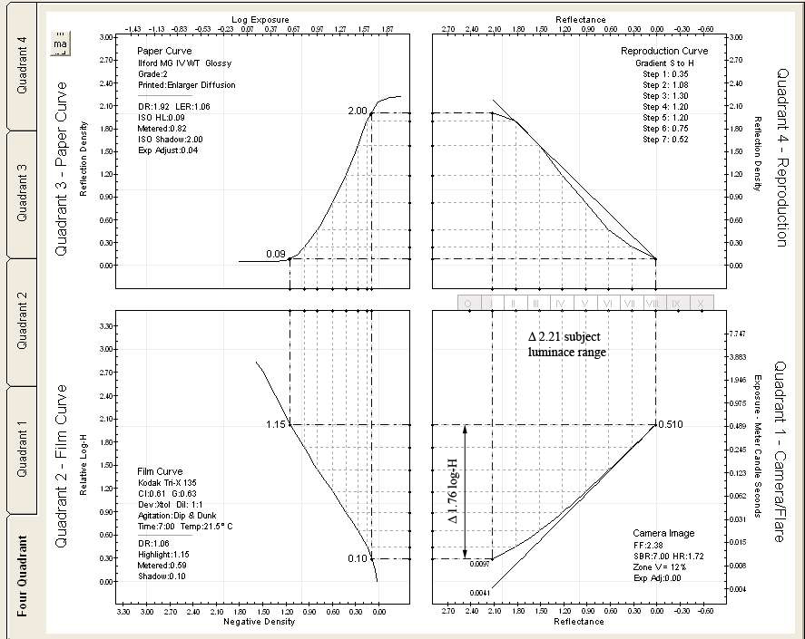

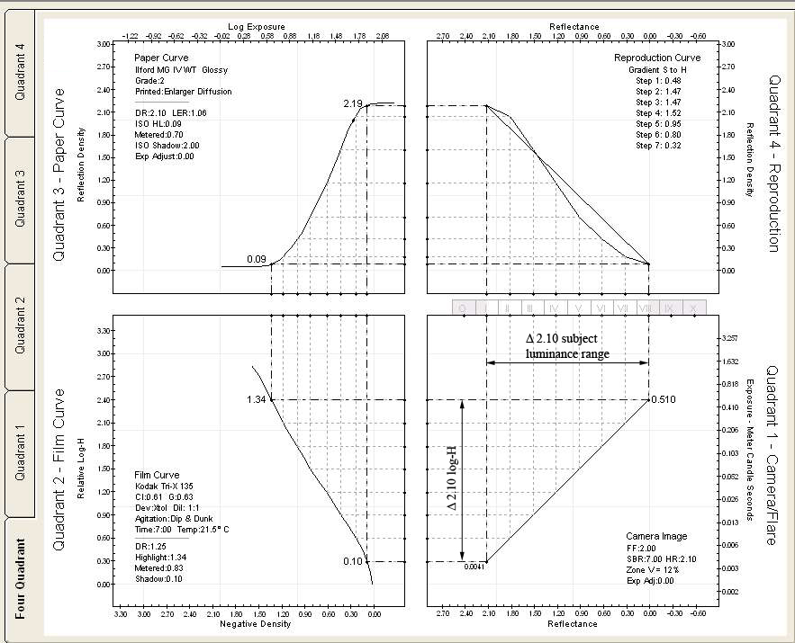

Okay, time to bring this to a conclusion.
CI or any average gradient simply tells you want the film is doing. It’s about input and output. A CI 0.50 says that if one unit goes in, ½ unit comes out.
It’s importance in this thread is that it is a different way of approaching the problem. Just having a NDR doesn’t tell you anything about the shooting or processing conditions. If you have two of variables, the third can be determined.
It’s easy to extrapolate the average gradient for the Zone System variables. The Zone System provides the NDR 1.25 and the SBR of 7 stops (2.10 logs).
1.25 (NDR) / 2.10 (7 stop SBR) = 0.595
The importance of Kodak’s CI chart was that it provides all three components involved in the CI equation to practice with, input, output, and gradient. The reason why I added the Xtol pamphlet was to provide an example of what Kodak considers to be the CI for normal. They had it as 0.58. On the Kodak CI chart, that fell under a 7 1/3 stop SBR and a 1.05 LER.
1.05 / 2.20 = 0.48
As that doesn’t equal 0.58 there must be another variable involved, and that variable is FLARE. Now much flare:
1.05 / 2.20 – 0.40 = 0.58
People forget that there are four different elements of "contrast" to consider in the photographic processes. There's the Log subject luminance range of the original subject, the negative density range, the print LER, and the exposure range of the camera image. What the film sees it the camera image, not the tones of the original subject. The input is the combination of the affects of flare on the SBR and not the SBR alone.
Flare is the answer to this thread.
Curve A is the correct representation of reality in that it incorporates how flare changes the log-H range. Otherwise the two examples are the same. They will produce the same negative density range for the same subject. The way we know that is because of understanding how gradient works and not relying only on the negative density range as an expression of the conditions. NDR is only half of the gradient equation. Alone it tells you nothing about the film process conditions or the shooting conditions.
So, the answer is
Zone System:
1.25 / 2.10 = 0.59
Tone Reproduction:
1.05 / 2.20 - 0.40 = 0.58
The two examples are the same. The only difference is one is misinterpreting the data.

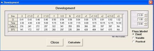

The Kodak CI chart show one of the advantages of using average gradient. You can easily determine the all the processing aims simply by input a few variables. Together with a Time/CI Curve, it’s a great tool (Development chart attachment).

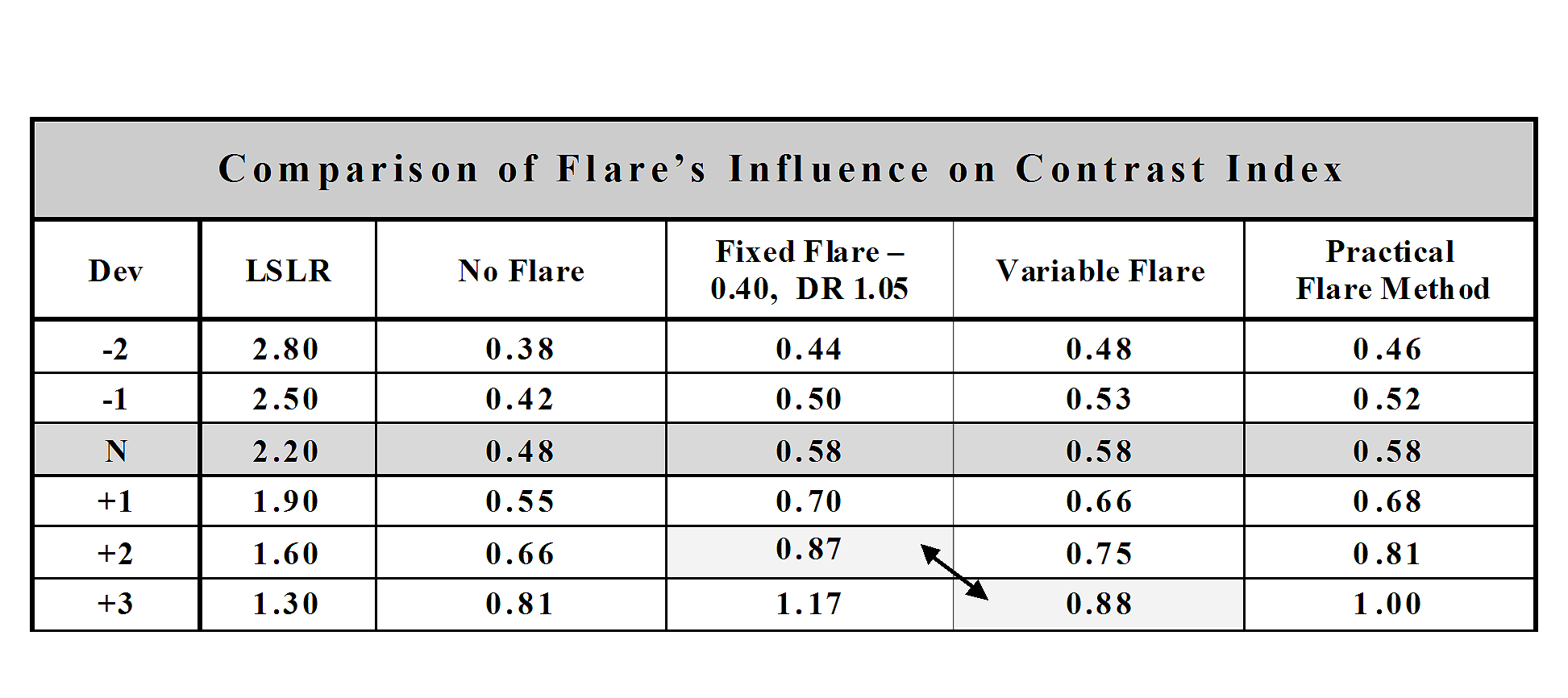

Keeping with the topic of understanding all the variables and the advantages of correct interpretation, is the idea of the type of flare model to use. There are fundamentally two different models. The fixed flare model which the Kodak chart uses, and the variable flare model where the value of flare changes as the luminance range changes.
The fixed flare model is easier to generate, but the variable flare model is more representative of shooting conditions. In general, as the luminance range increases, so the level of flare. As the luminance range decrease, so does the flare factor.
With a fixed flare model, the CI indication tends to be excessive with + 2 and +3 development, and quickly flattens out with -2 and below. This isn’t the case with variable flare, but according to psychophysical aspects of tone reproduction theory, the perception of quality in the extreme processing ranges could still be a problem.
According to Jones, “Our analysis of the statistical print judgment data revealed that for maximum yield of high quality prints a surprising rule should be followed: For the soft papers, the density ranges of the negatives should in most cases exceed the sensitometric exposure range of the paper (read LER); whereas, for the hard papers, the density ranges of the negatives should in most cases be less than the sensitometric exposure range (read LER) of the paper.”
Because of this I came up with a third model which I call the practical flare model. It basically splits the difference between fixed and variable flare models.
I’ve attached a chart comparing CIs for various models. Sounds to me like all this technical stuff can give a person some serious creative control over their materials.

Anyone notice the CIs in the development chart for Xtol don't equate with the CIs in Kodaks CI chart? Did you know that it because there is a difference between "pushing for speed" and "pushing for contrast"? The tell as to which approach they are using is the EI column in the Xtol chart.
Xtol Kodak Chart
0.52 0.50
0.58 0.58
0.65 0.70
0.75 0.88
0.85 1.17
The reason is that rating the film at higher EIs underexposes the film shifting everything to the left and lowering the effective NDR. Increased development shifts the shadow densities approximately 1/3 stop to the right per stop push. That means that the a one stop underexposure will only be a 2/3 stop underexposure so the processing needs to be at 2/3 stop and not 1 stop for a one stop speed push. A two stop underexposure requires only a 1 1/3 stop push in development. Compare the Xtol numbers to the numbers on Kodak CI chart for the 1.05 LER. You will see this progression.
Two simple sets of numbers in the Xtol development chart tells me so much and gives me insight into the thoughts and intentions of the people who put it together, and that puts me in control.
