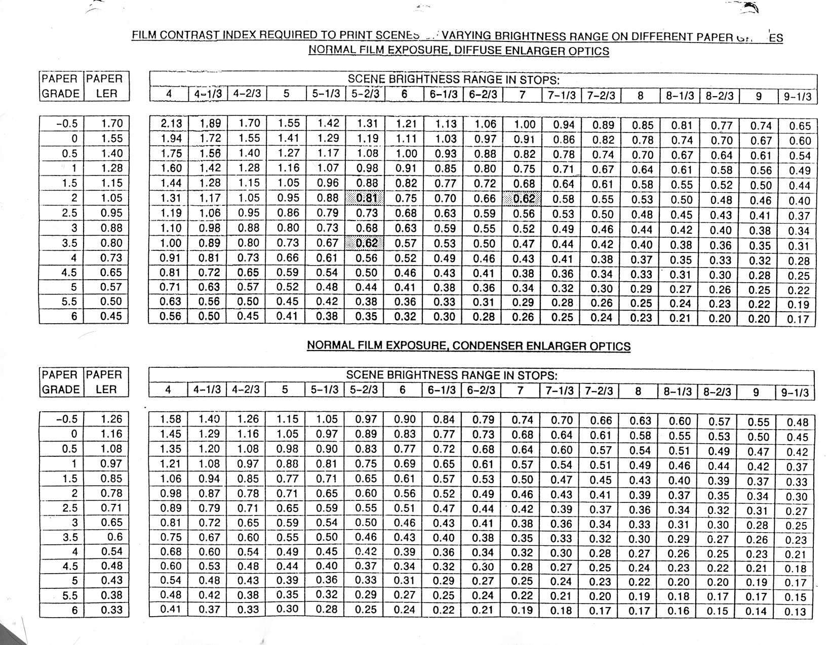

If you distill down this thread into a practical testing procedure, then I would have to say, when doing in camera Zone System testing for contrast determination, meter Zone V and open up two stops. Find the exposure that falls 1.05 to 1.10 over 0.10 over Fb+f. Or know that if continue to use the traditional approach where you open up three stops and use 1.25, that it will still give you the correct contrast for the film, it doesn't represent the negative density range that will be produced.
If there is no difference between a zone and a stop, then there is no reason to use the word zone. If you want to talk with precision just stop using the word zone.
A stop refers to a specific exposure change, a zone a specific exposure level. Zones are a stop apart.
Could you point me to a documented example?
Personally, I don't like using Zone terminology as a general rule. I kind of had to in this thread. Yuck.
First when I said common usage, I meant something more along the lines of common vernacular. Anyway, I've attached two documents that I think is what you are asking for.
One is a page from Photographic Materials and Processes by Strobel et al. The other is an internal CI chart from the R&D department at Kodak.
As the CI chart is sort of connected with the concepts of this thread, I have a challenge to present. Anyone know how the CI values were produced? What were the factors involved? Bonus points for an analysis of any strengths or weaknesses of the model.
I can give a strength of ***this model*** that I bet you never thought of. I graph my curves on paper. And I use a CI transparency overlay to read the graphs.
With more sensitive film, the sensitometer tends to "overexpose" the film being tested when using a 21-step test wedge. Any faster than 400 and I won't have a toe on my graph and I may not even have an 0.1 density reading to gauge speed by.
But my CI index will fit nicely on the graph. So I will know my CI.
***Thought you were talking about CI 'per-se'.
Now that I've printed the chart I know you are talking about something else.
This is same as Zone system except not using Zones at all. Not using N+ or N- either. Just tells you what to develop to if you want to get a print matched to the negative based on your meter reading. Nice. I was going to extrapolate something like this anyway since it is easy for me to develop to a CI.
When I take a paper with LER 0.9 (Galerie 3 in my hands) and follow the 0.50 CI curve on paper from 0 to 7 stops (Zone 0 to Zone VII at N), I arrive at my LER 0.9 in 7 subject light meter stops.
But on the chart, that isn't where 0.50 CI is prescribed, it's 2/3 stop to the right at 7 2/3 subject light meter stops.
0.56 is the prescribed CI.
Oddly (or not - depends how you see things), <N> that I wrote on my graph, is on the 0.56 CI curve where it crosses Zone VII. I put that <N> there after working with you to incorporate flare.
Flare, eh? :wink: And...
Check out the CIs from the processing tables in this Kodak Xtol data sheet. They start on page 6. What does it have as Normal? Where does that fit into the CI chart? Don't try and figure out the pluses and minuses they have for Xtol just yet. It will just confuse you as they don't match up with the Kodak CI chart. Bonus if anyone can figure that one out.
I hope you see where I'm going with this. This is not trick. It's like I said earlier, the key is in the interpretation of the data, and a large part of that is having a good grasp of certain principles and asking the right questions. Hint: How is CI calculated?

So using the method for determining CI found in Kodak's Sensitometry Workbook the curve used in the examples has a CI of 0.58. Close as I can tell.
The placement of the zones can be determined by the paper's range, if the papers printable range is 1.05 then B should print the zones as expected and A would end up clipping.
Am I missing something with regard to the paper's characteristics?
