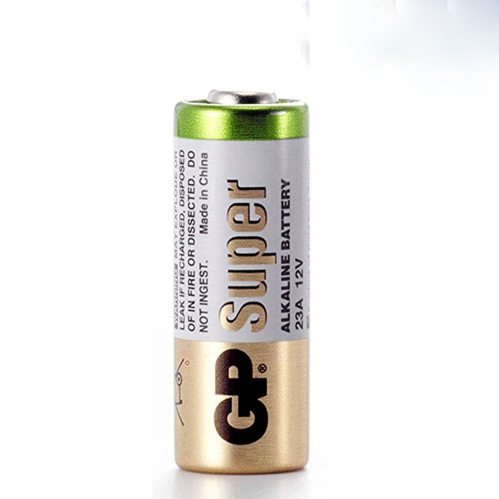

Hi. If your Tilt-A-Mite's capacitor still works and you just want a battery that's cheaper than the 15v, one solution is a 12v 23A battery:
https://www.ebay.com/sch/i.html?_fr...p=15&_osacat=0&_odkw=23+battery+-cell&LH_FS=1
Dimensions are 28 x 10 mm, but if you add the battery holder (outside dimensions 34 x 12 x 12 mm) then you're fine.
The holders cost $0.99 for 5 of them, free shipping:
https://www.ebay.com/itm/5Pcs-23A-A...443348?hash=item3b36fa4b14:g:Y9YAAOSwWkxdTTms
and you don't even have to solder them to your flash, just add a thin piece of metal so contact is tight (use thumbtack heads after removing the pin, or anything else).
Hope this helps,
Cheers

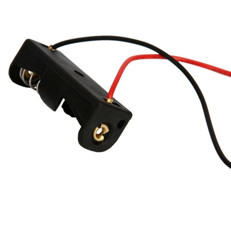

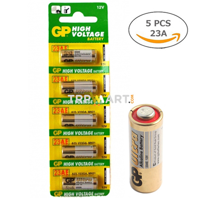

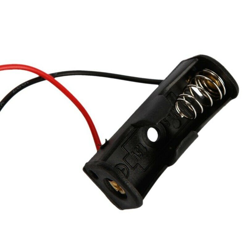

Hi again everyone. Update on 12volt A23 battery instead of the original 15v battery.
I just got my 12 volt batteries and battery holders in from China and tested them on 3 different BC flash guns: Nikon BC-7, Tilt-a-Mite II, and Sunset BC 1500.
I have the pleasure to confirm that it works on all of them.
The holder is exactly the same size as the 15v 504 battery, so no need to solder it to the flash, I cut the 2 wires off and just added a bit of aluminium foil on both ends for good snug contact. The advantage is the price: about $3 for 5 x 12v batteries and $1 for 5 holders, free worldwide shipping, take a look:
https://www.ebay.com/sch/i.html?_from=R40&_trksid=m570.l1313&_nkw=23a+battery+5pcs&_sacat=0&LH_TitleDesc=0&Product%20Type=Battery&_sop=15&Type=23A%2FMN21&_osacat=50602&_odkw=23a+battery&_dcat=50602&LH_FS=1
and:
https://www.ebay.com/sch/i.html?_from=R40&_nkw=5Pcs+23A/A23+Battery+Holder&_sacat=0&LH_FS=1&_sop=15
So for a total of $4 I can replace 5 x 15volt batteries, that's 80 cents for 1 Flash Gun, compared to the $14 (+shipping) here:

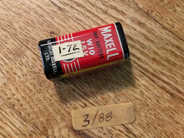

The other day I dug out a non-digital multi-meter which I hadn't used in eons. Normally they contain a battery or two for making resistance measurements and I suddenly had a sinking feeling that I had probably left the batteries in it for two or three decades. As a time reference, Lafayette Radio, the company that sold these, went out of business in 1981 -- I've had it for a while!
Yes, there were batteries in it, an AA cell for the lower resistance ranges, AN-N-ND, a 15 volt battery like in the Tilt-A-Mite for the highest range! Remarkably, while the AA cell had leaked, the goop seemed to be relatively clean looking transparent crystals that cleaned up easily and didn't appear to have done much damage. More amazingly, the 15 v looked unscathed and carried a label "1972" that I apparently stuck on when it was last replaced. What really blows my mind is that it still showed an open circuit reading of 10 volts! I immediately recalled this thread.
(the "3/88 " fell off the ugly AA cell.)
