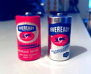

Question 3: Were there really “Photoflash” batteries back then? How were they different from other batteries?
Yes, I own examples of both photoflash and regular versions of batteries from that time period. This was the time before alkaline cells had hit the market. Photoflash batteries were identical in shape but used different chemistry than regular batteries at the time. The photoflash batteries were formulated for short bursts of high current, while regular batteries (commonly called “flashlight” batteries) were formulated to provide longer life of constant use at a lower current. Once the far-superior alkaline batteries became readily available in the late ‘60s and early ‘70s, the special “photoflash” batteries disappeared from the market. Incidentally, the older photoflash and regular batteries of the ‘50s are far lighter in weight than modern alkaline batteries of the same size. So when we think of putting two C cells in a flash unit and consider it to be somewhat heavy and clumsy, in the old days these would not have been as heavy as we would think them to be.

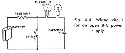

Question 4: What is the wiring diagram of a B-C flash unit?
There were two common types of B-C flash units in use at the time, one called the “open B-C system” and one called the “closed B-C system”. The open system was more popular and was set up like this:
In this system the insertion of a flashbulb into the unit would initiate the charging of the capacitor. The current through the flashbulb was kept low by the size of the resistor in the circuit.

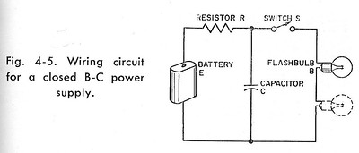

The closed system was wired like this:
This system was less widely used because of the issues brought up in this forum: the battery would continuously charge the capacitor, and if the capacitor had any faults it would slowly discharge the battery over time.
I do not know which system the Tilt-A-Mite uses.

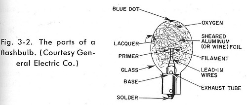

Question 5: How does a flashbulb actually get fired?
The business parts of a flashbulb are the wire leads, a filament, primer, and the combustible material. The filament is designed to burn out almost instantly once a current is passed through the wire leads. The sudden high heat generated by the burning filament in turn ignites the primer on the wire leads, which kicks off the main flash process. The primer is typically zirconium paste which is coated on the wire leads. It ignites in one or two milliseconds after the current is applied to the filament, producing an intense heat and exploding particles of ignited paste in all directions inside the bulb. In Class F bulbs the primer provides ALL of the light for the flashbulb. In standard bulbs the primer touches off the burning of the main combustible material. The amount of primer and the size and quantity of combustible material are held to very close tolerances so that the time-light performance is consistent from bulb to bulb.
