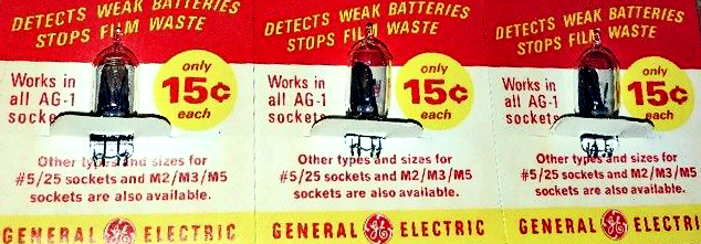

Dave, you're absolutely right, but I've only started all this few days ago. First I tested the Walz flash with an AG1 test bulb (not a real AG1 flashbulb, see picture, which is fine because Kodak Brownies only shoot at 1/60s, so you can still see the light glow), then at higher speeds with real bulbs on Nikon SLRs, and now the next step will be to test with film, at different speeds, with my Nikon F. I will do that whenever I find the time, and I'll let you know. BTW, the CR123 Panasonic alkaline battery I'm using is rated 3volt, 1400 mAh.
Cheers

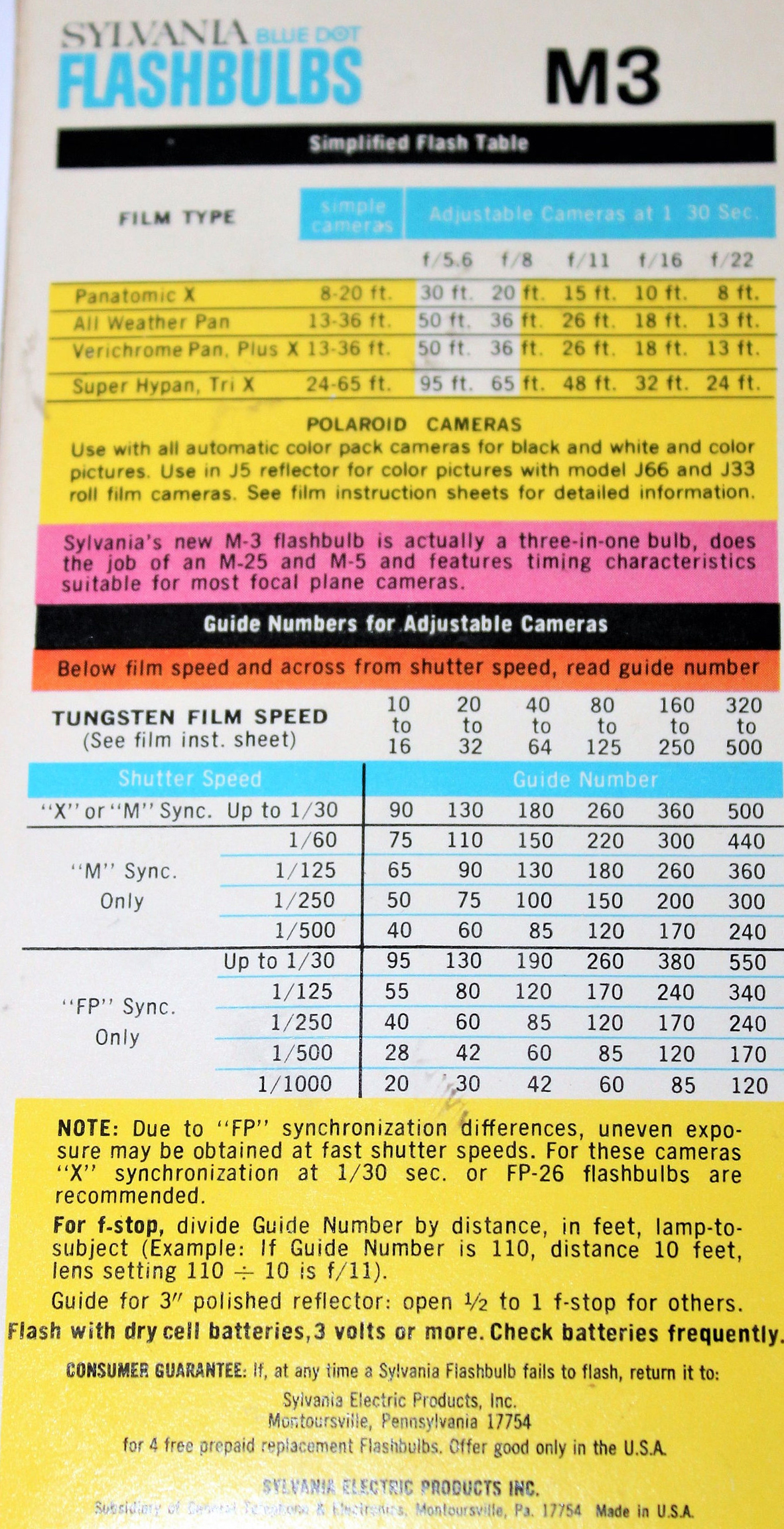

BTW Dave, look what's written on the box of Sylvania M3 bulbs I'm using for testing with film (in yellow under the charts): "Flash with dry cell batteries, 3 volts or more". Now these are M3 bulbs that can be fired at up to 1/500s according to the manufacturer's charts on the picture below. If there was a sync problem at 3 volts, I guess the manufacturer would have known. But I will film-test anyway and show you the results.
Cheers
I know the bulbs will fire on 3 volts, the (non-capacitor) flashgun for my Argus C-3 uses 2 C cells in series to fire M5/25 bulbs, but C cells can supply a significant current (multiple amperes) for short bursts. It could also be possible that the later, smaller bulbs were able to take advantage of more precise manufacturing techniques to have more sensitive firing. Anyway, it all may be fine. The capacitor based guns were to allow using small lighter batteries that can't really supply much current, but the stored juice in the cap could deliver a short, heavy burst for ignition.
The "fired at up to 1/500" I don't believe is all that significant. For flashbulb M sync, the contact closes about 20 milliseconds ahead of the shutter opening. That timing likely holds regardless of shutter speed, so the bulb gets time to respond. My (likely misplaced) concern is that if the battery system was marginal, a slow ignition start might delay the peak of the flash output a few milliseconds which could be past the shutter opening at the shortest exposures. As it is, the exposure is unable to use all of the bulb's output on faster speeds because the "burn" time is far from instantaneous. Of course all the older shutters did that sync timing with some sort of mechanical magic, so none are likely "digital precision!"
The aforementioned Argus C-3, a circa 1957 sample, has X sync so, as in your chart, they tell you to shoot at 1/25 or longer exposure so the whole bulb firing can fit in.
Anyway, have fun! :D

Well friends, the final test has spoken.
Here are the pictures.
Camera: Yashica Mat 124G
Flash: Tilt A Mite, no capacitor, 3 volt CR123 battery instead of capacitor
Film: Ilford Pan-F 50
Bulbs: Sylvania M3
Pic #1: 1/60s at f/11
Pic #2: 1/125s at f/8
Pic #3: 1/250s at f/5.6
Pic #4: 1/250s at f/8
Pic #5: 1/500s at f/5.6
Pic #6: 1/500s at f/8
Conclusion:
My little 3 volt combo syncs at all speeds (previous problems came from focal plane cameras), as already specified by the bulb manufacturer ("Flash with 3 volt or more", bottom of last pic attached, in yellow)
Recommandations:
Just follow Sylvania's instructions on the box of M3 bulbs (bottom of last pic attached, in yellow) which are:
1- with focal plane SLRs, 1/30s max
2- with leaf shutter cameras, M sync and any speed up to 1/500s
Thanks everyone for your input and guidance,
Cheers

Seeing the corrugated cardboard flashbulb cartons in your pictures, I now understand your interest in this exercise. What I have left from the good old days is more like a few sample bulbs.
Dave, I have a large amount of bulbs of many types and brands, so why not use them.
I feel pretty good about this experiment, it went according to my first intuitions, hope it will allow people to use their old flash again.
