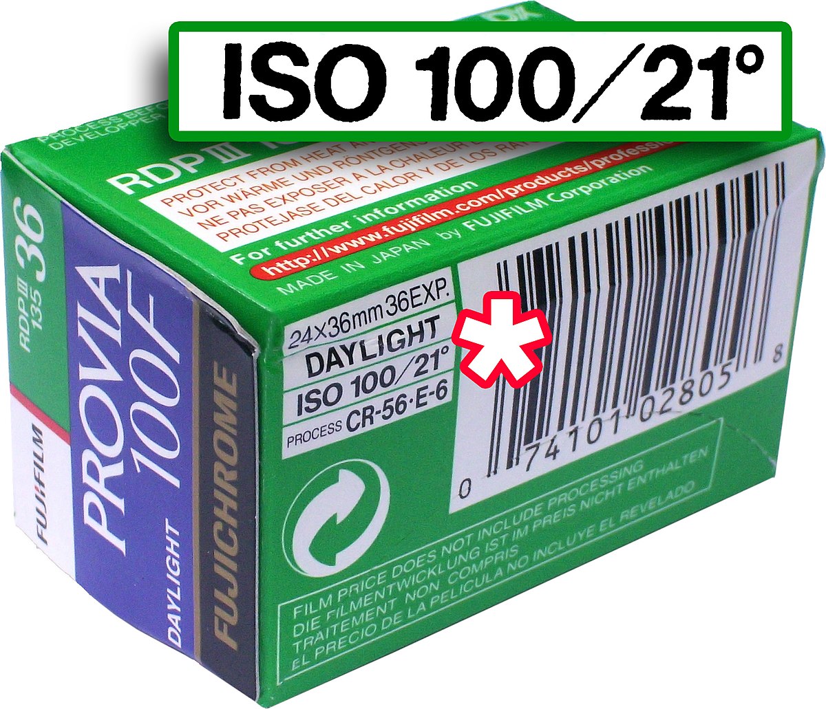

Actually, it was 1974 when the ASA speed was incorporated into the ISO speed.
At that time the ISO designation was just the combination of the ASA and the DIN designations into one new designation and omitting "ASA" and "DIN", but using "ISO" instead.

I recall in the UK, when I started in the late 70s films were sold and described with ASA speed ratings, and sometimes the ISO rating which gave both ASA and DIN (eg 400/27). I recall visiting West Germany in 1987 and the local supply of Agfa C41 film was labelled in DIN with the ISO combination in the small print. Sometime in the 1980s the combination arith/log ISO was used on pretty much every film box in the UK.
By the end of the 80s, I think everything moved to ISO ratings without the DIN incorporated, ie just the arithmetic scale. By the time I started spending considerable lengths in the USA in the late 90s....nobody seemed aware that the arith/log ISO had ever existed and still referred to ASA.

I think ASA speeds are the same as ISO, DIN numbers are very different.
There are 2 kinds of ISO disignatons:
-) consisting of both, the arithmetric and the logarithmic designation
the current one
-) consisting just of the arithmetric one
