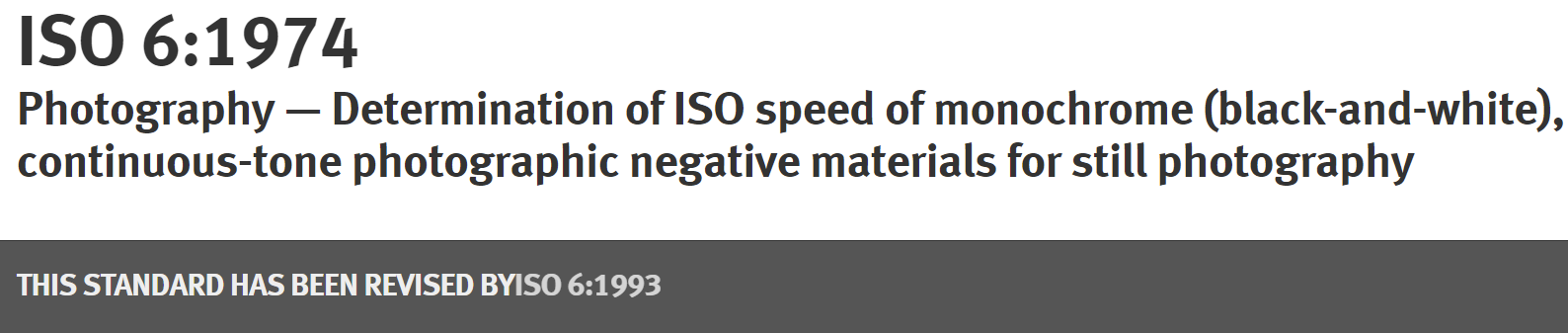

The confusion arises because ISO, DIN and ASA are both - they are labels on the box and they are standards as well.
The standards coalesced in 1974, all under an official rubric of ISO certification.

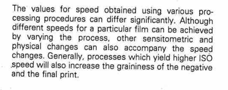

The ISO document allows the film manufacturer to specify their own developer and development conditions. Different developers and development conditions can change the ISO. A manufacturer could could change a film from ASA 100 to ISO 125 with different development conditions.

Problem is that the ASA standard was continued after the introduction of the ISO, making it not easy to say for sure when which regulation was introduced where without having all standards issues at hand.
ASA PH2.5-1960 was an effort towards international agreement. The Fractional Gradient Method was too complicated and prone to experimental error for some. I believe only BS had adopted it. PH2.5 maintained the accuracy of the fractional gradient method as well as included the ease and repeatability of a fix density method through the use of the Delta-X Criterion. It also reduced a safety factor which adjusted the EI of film speeds by 2/3 to 1 stop. ISO 6:1974 is essentially the same as PH2.5-1960, or more precisely ANSI PH2.5-1972.
ISO 6:1993 made changes to better reflect actual use. The primary changes were to hold times, the elimination of the standard's developer in favor of actual commercial developers, and the method of development. It kept the Delta-X Criterion. From what I understand, the introduction of T-grain films was the motivation for the revision. Apparently the standard's developer produced speeds that didn't reflect the speeds that were produced with general purpose commercial developers. When T-Max 100 and 400 films were initially on the market, they only had EI speeds.

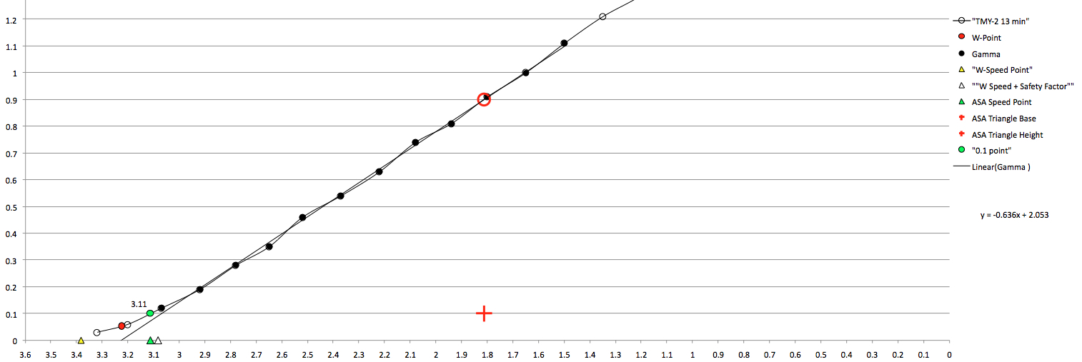

Has anyone has posted a good spreadsheet to find the delta D. Since it is dependent on first finding the 0.1 point, you can't apriori know where the datapoint will be (to get it to fall exactly on a step of the stepwedge when doing the sensitometry exposure). Therefore, it will most likely fall between two points. Easy if drawing the graphs by hand. Also, didn't someone once offer to make some lucite "Speed Meter" overlays to place on the hand-drawn H&D curve?
My current spreadsheet is still a little lacking in Delta-X as it only automatically draws the single Delta-X condition of Delta D = 0.8.
In spite of what I wrote above, sometimes the Delta D is on a datapoint (red circle), as in the case below, but many times it is not, and therefore, would need mathematic interpolation.

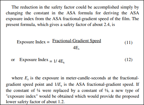

Let's look at the Eastman Kodak 7th edition (1st printing 1958) of Kodak Films for Black and White Photography. It lists Panatomic-X as having an Exposure Index of 25 for daylight, 20 for tungsten. But they are to be used on meters marked for American Standard Exposure Indexes. But note the rather confusing statement that the indicated exposure measurement will result in negatives about two times the minuimum exposure needed. In another thread, we had a long give and take about when meters were changed to give the optimum exposure and not two times. Anyway, ASA and DIN numbers were not yet used in this book.

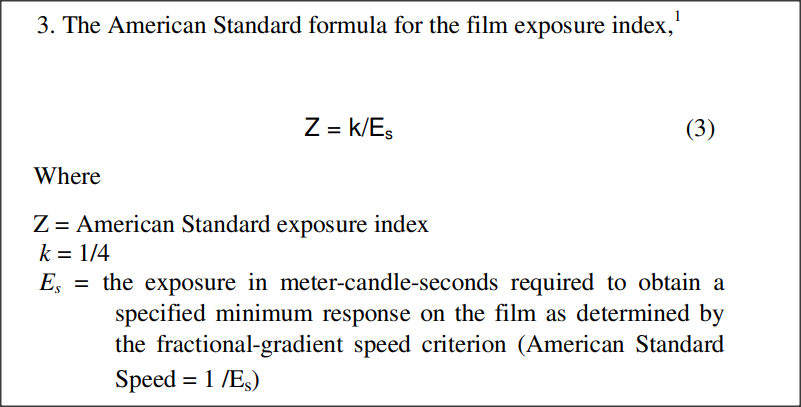

That's because this is how the basic EI was derived. From the 1960 paper Safety Factors in Camera Exposure.
The implication is that the factional gradient speed is THE film speed. As the current ISO uses Delta-X, which is a method of finding the fractional gradient speed point using a fixed density method, where ΔX is always 0.297 log-H to the left of the 0.10 fix density point when ΔD = 0.80, it effectively makes the current ISO speed an EI.

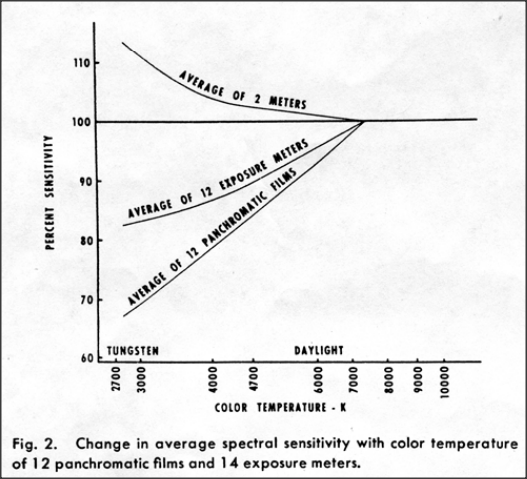

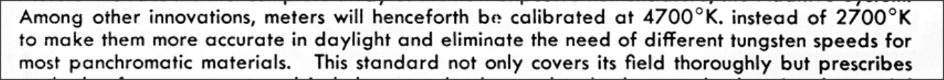

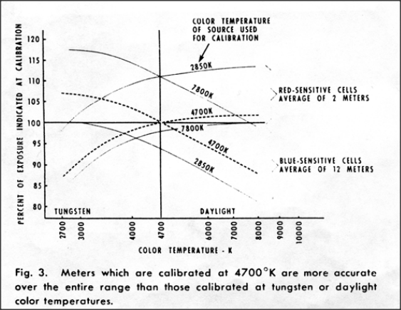

The different EI ratings for daylight and tungsten is mostly due to the color temperature used in the calibration of exposure meters. Here is part of the abstract from the 1962 paper An Interpretation of Current Exposure Meter Technology.
5.4.2 Processing Specifications (ISO)
The change in the ASA component of the ISO standard to allow the film manufacturers to specify their own developer was at the request of Eastman Kodak. Tmax 100 could not achieve 100 ASA in the specified ASA standard developer, by then Kodak were using a Phenidone (Dimezone) Ascorbic house developer for their in-house testing, PE - Ron Mowrey mentioned this in several posts.
That makes no sense, it just means the meter is more accurate in daylight. It's only in quite recent years that manufacturers stopped listing both the Daylight and Tungsten films speeds.

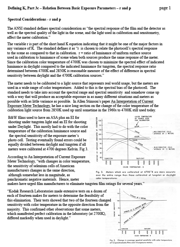

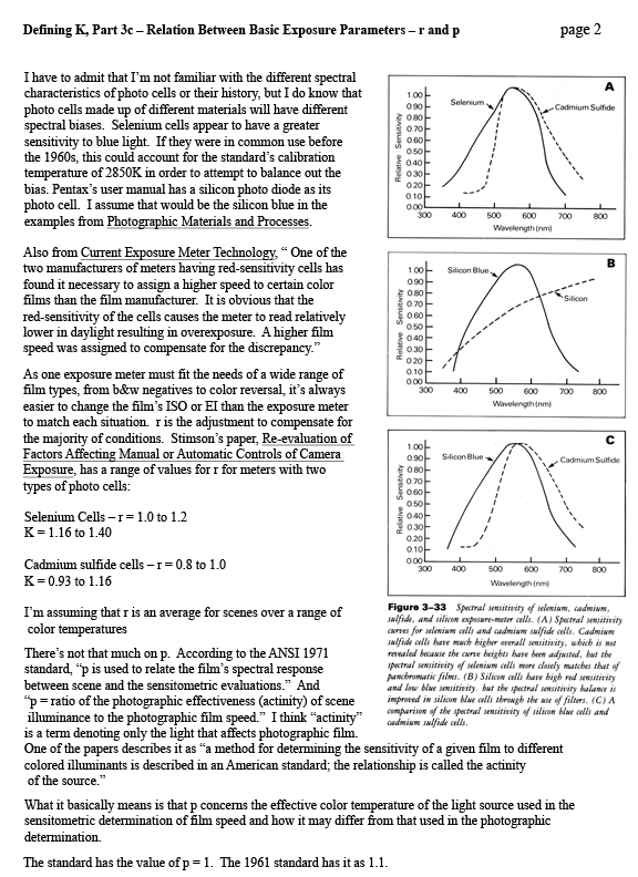

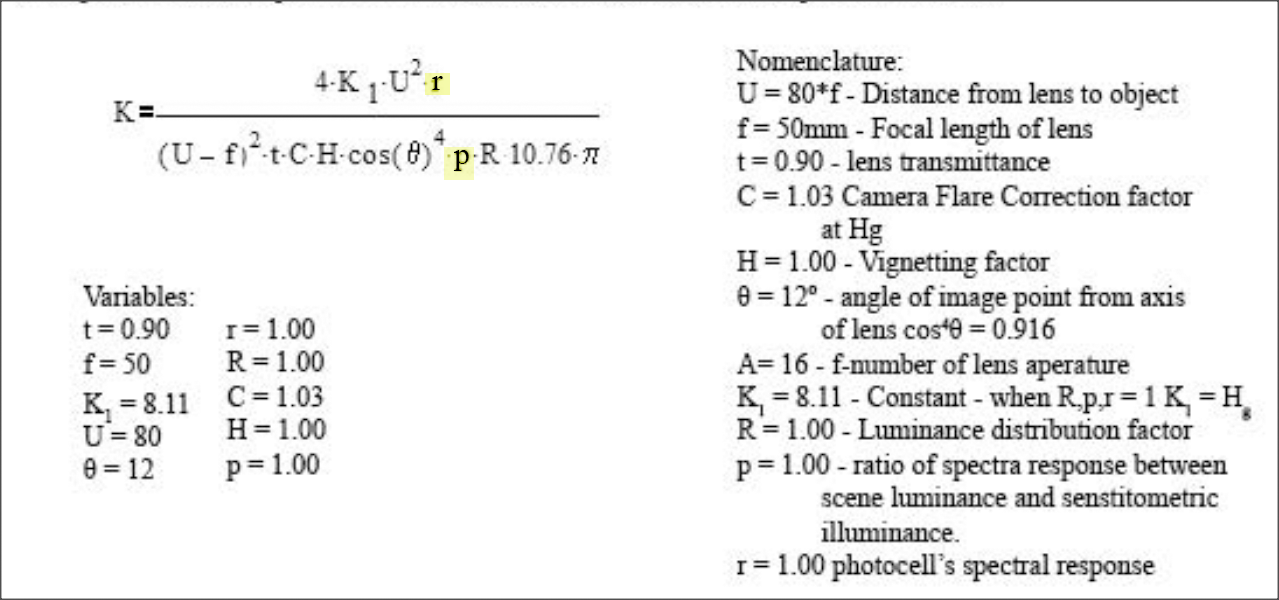

Do we know, then and now, what meters are color biased red- vs blue-sensitive? Or is that a characteristic of the cell type: selenium v CDS v Selenium blue, etc? I’ve never noticed color sensitivity in the spec sheets (and never really noticed a difference in day-to-day use of 1960-2000 meters)
r and p are variables in K. Below is a section from something I cobbled together a number of years ago.
