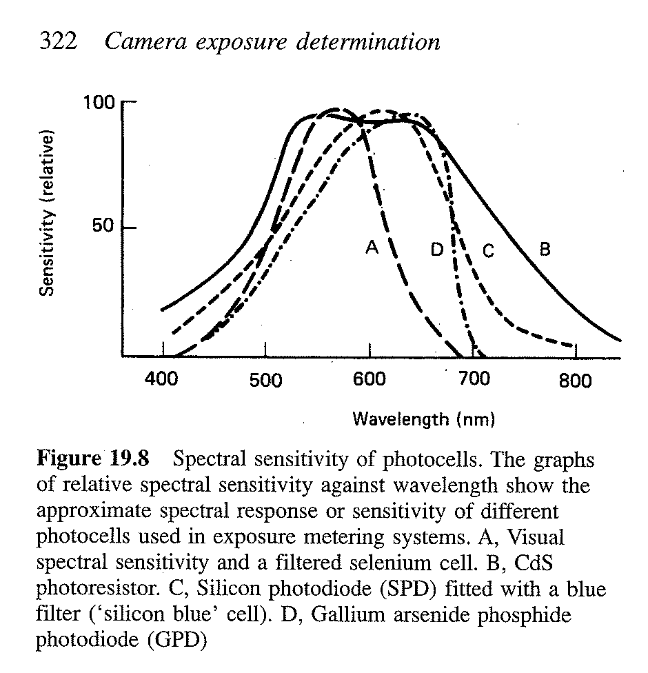

My ancient Knight Kit CdS light meters came with a pale green filter. Explained by the above notation that CdS is more red sensitive.

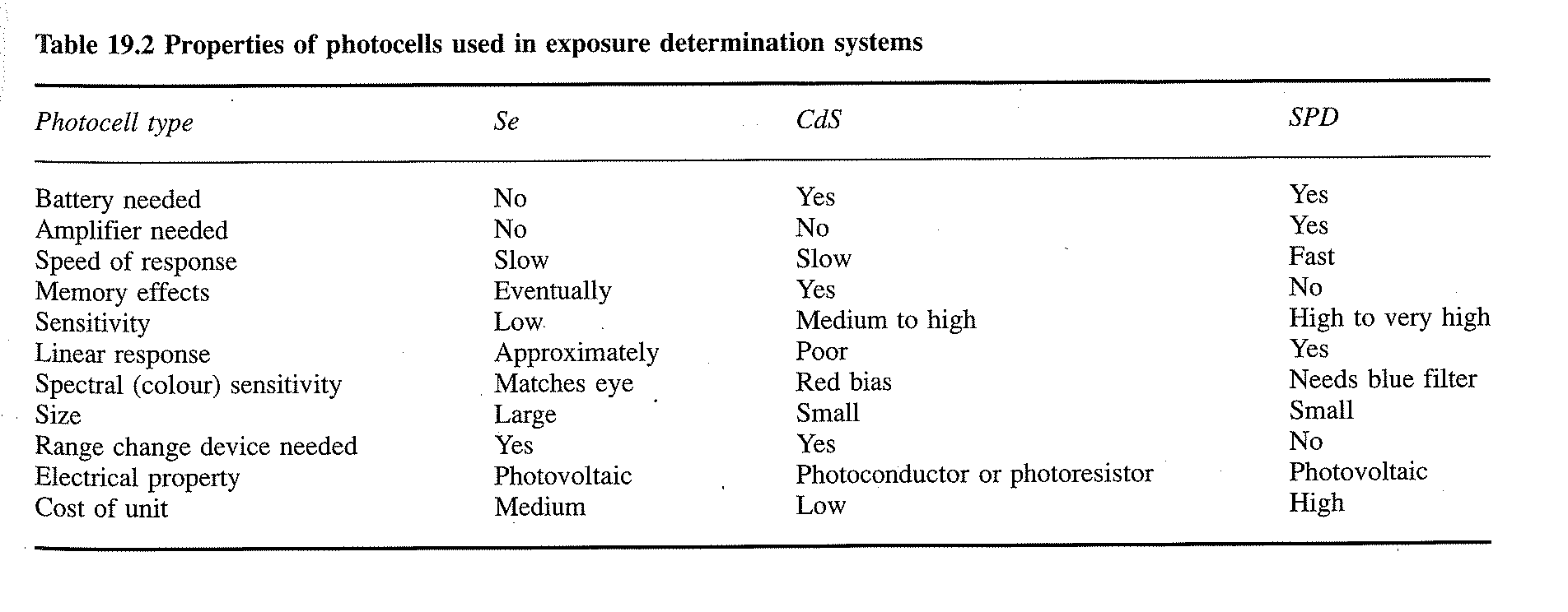

SPD cells are not photovoltaic, but a semiconductor.
I'm sure the book just didn't have enough space on the table for a complete definition. I don't have the book in front of me, so I don't know if it was more specific in the text, but according to Wikipedia:
… but that’s picking nits and not really pertinent to the discussion.
Good point !
I understood "photovoltaic" in this context as meaning that the cell produces electricity itself, in contrary to the other two cells. That is why I found it not apt using it for the SBC cell. Actually I considered it just as an error at the lay-out stage.
(In Germany "photovoltaic" generally is used in this meaning.)
Well, if one understands "photovoltaic" as light affected semiconduction, then indeed it applies on both, the Selenium and the SBC cell.
But then on the CdS cell too....
In any case, I learned of an another meaning of this term.
I got a great amount of light meters. And even more built into cameras.
I did not come across a green filter on a CdS cells so far. But an interesting observation of yours. Maybe I should check again...
