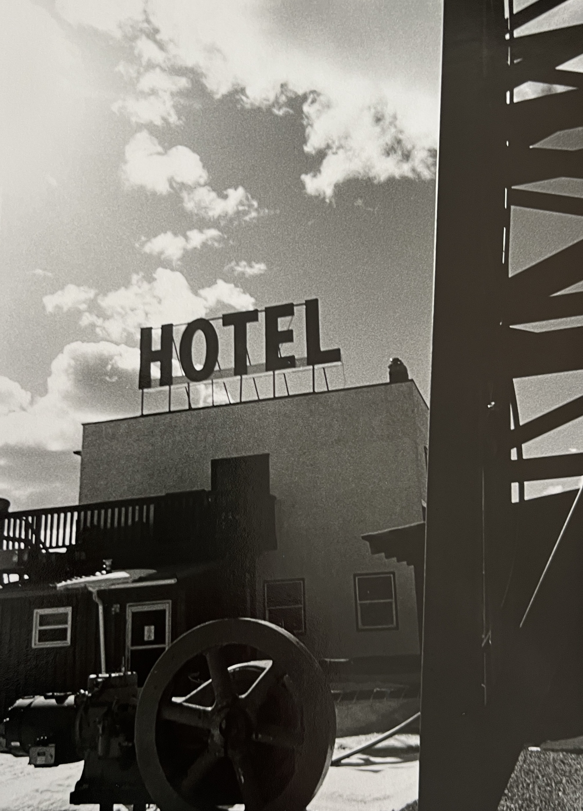

Leica CL, Canon 28mm 2.8, Tri-X in Pyrocat HD. Print on Ultrafine Silver Eagle FB
