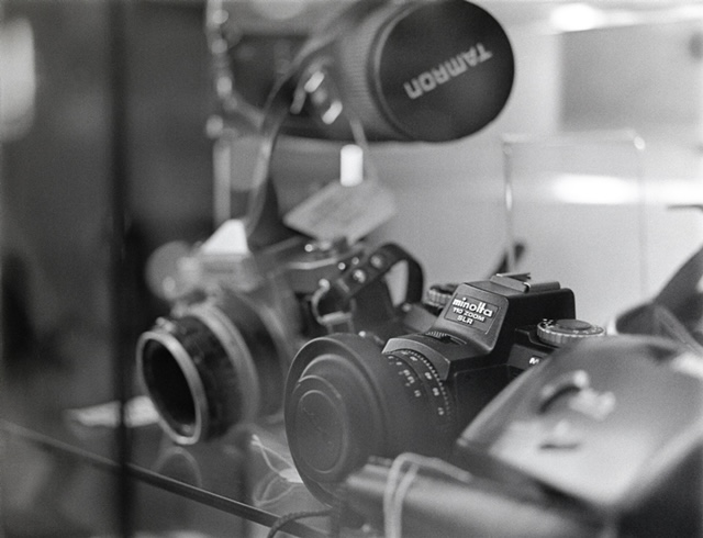

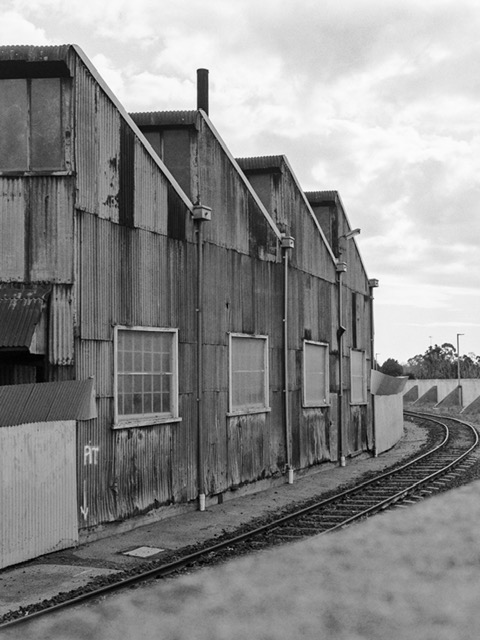

Bronica ETRSi with AEII prism, 50mm MC f2.8 for the building shot, 100mm E-II f4 Macro for the other two.
Kodak Tri-X that expired in 2011, shot at ISO320 for, I don't know, some weird reason I had in my head at the time.
Semi stand developed in Paranol-S for an hour, with a bit of a shake at the half-hour mark.
Last shot was taken in my local camera store, just after putting money down for a nice Olympus Pen FT, lol...

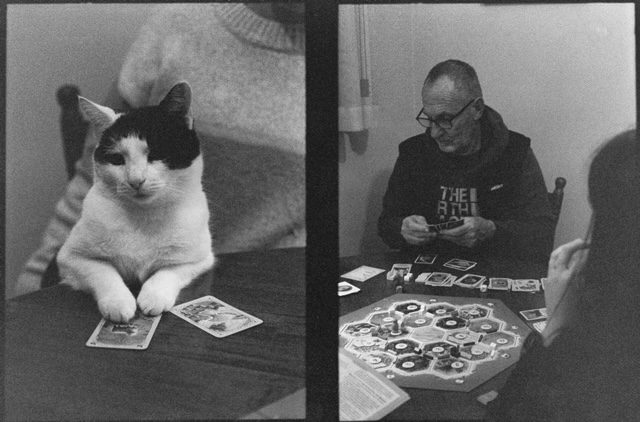

Roll each of FP4+ and Tri-X (both expired) in Bronica ETRSi, dev'd in Paranol S 1:25.
And two rolls of what I was told was bulk loaded Tri-X in 35mm, but one roll actually turned out to be FP4 too. Which would have been great had I not rated and dev'd (again, Paranol S 1:25) it at 800 ISO :-/ bit under exposed and cooked. Shot on Nikon FM and Olympus Pen FT.
