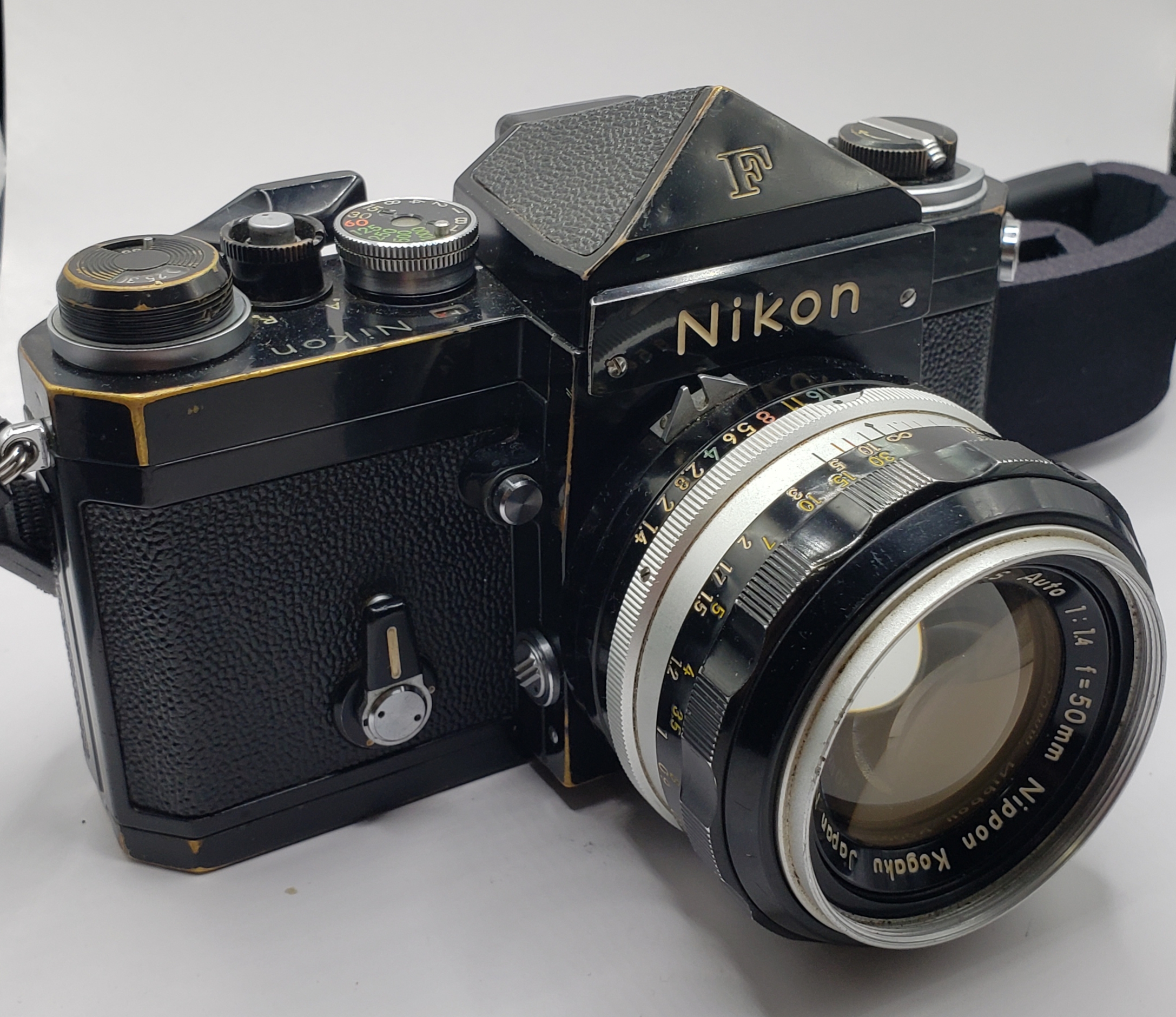

Nikon F, Micro Nikkor 55mm f3.5, Kodak Tri-X 400, Clayton F76 (lab processed and scanned). This was my first roll through the recently acquired Nikon F, certainly a nice camera and enjoyable to use. Love the sound the shutter makes, very cool, also happy with the Micro-Nikkor.
