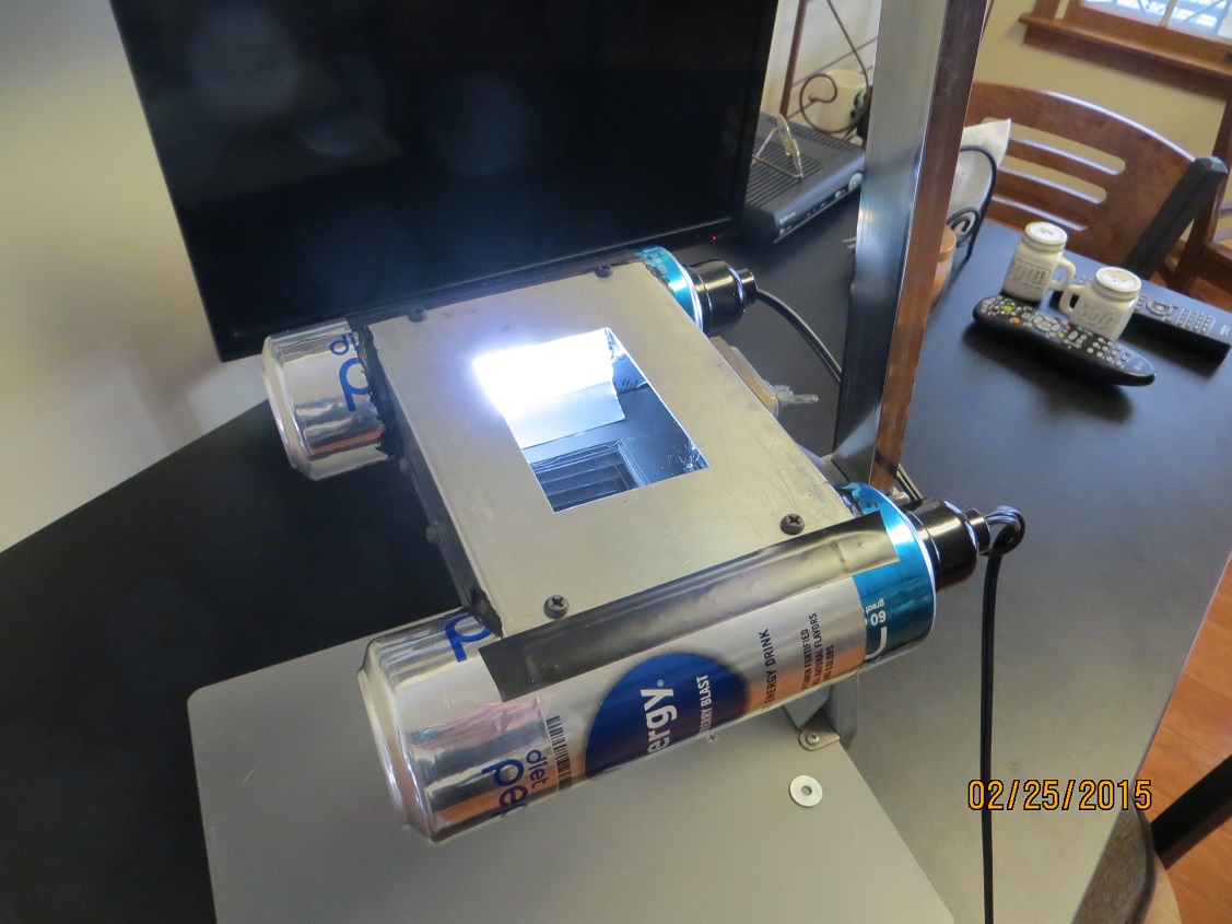

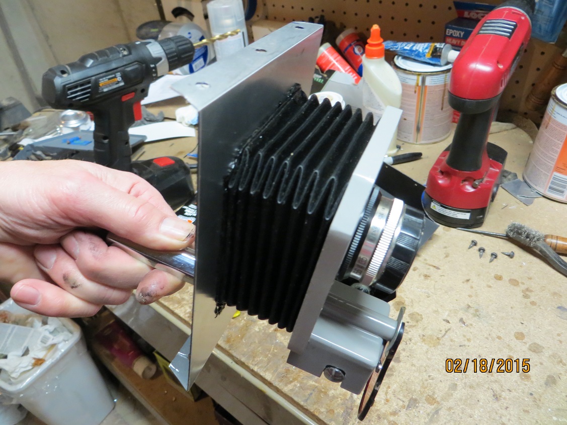

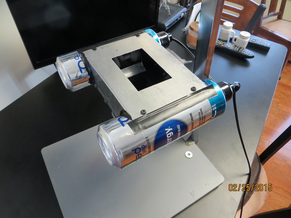

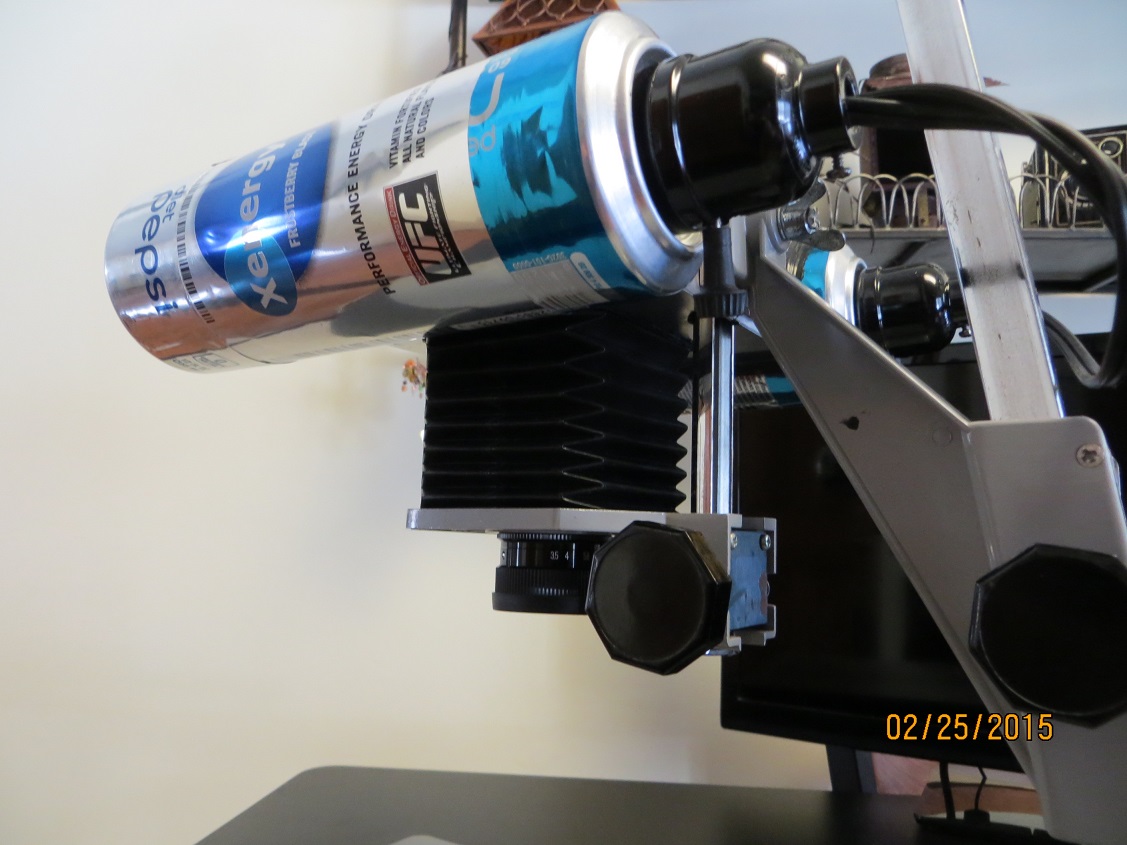

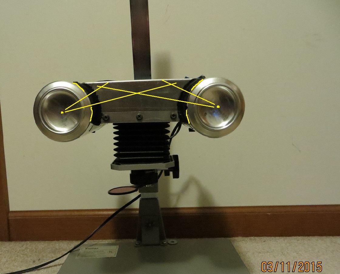

I put together a paper negative enlarger which I documented here on the forum last spring. Works amazingly well. It's muck like an opaque projector. Now I've just got to shoot more paper negatives!
enlarger 2.jpg enlarger 3.jpg enlarger frame 3.jpg front view.JPG enlarger 1.jpg
The thing w/ darkroom stuff is that it's pretty easy to make most of it. If you buy it, the price per piece w/ shipping can cost a fortune! Trays can be found at Walmart or even the Dollar Tree, safelights are either a $5 red bulb from Freestyle (order it when you do your chemical/paper order and avoid shipping costs) or bike LED taillights w/ some extra Ruby lith just to be sure, gloves can take the place of tongs, cut down plastic jar lids or mat board can be used for lens boards, a 135mm or longer camera lens makes a surprisingly good print focuser, $4 glass thermometer can be used for film or prints, and mat boards or most anything can be used for neg carriers on most enlargers. If you print RC papers, all you need is a piece of string and clothes pins to dry them.
I have a frosted house bulb in the enlarger that I took the writing off w/ alcohol, and while there's a proper enlarger bulb coming, I think the illumination on this one w/ a diffuser enlarger is quite good. If you look in thrift stores you can find 11x14 picture frames w/ backs that have tabs that hold the picture in (like the one below) simply by twisting them. These make great print easels, as you take the back off, place your paper in the frame emulsion side up, put the back on, and twist the tabs closed. When you flip it and place it on the enlarger base you have a nice, flat paper, and the frame gives you a small border on the print.
