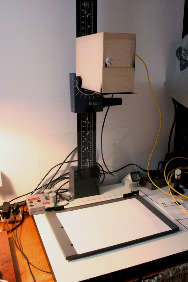

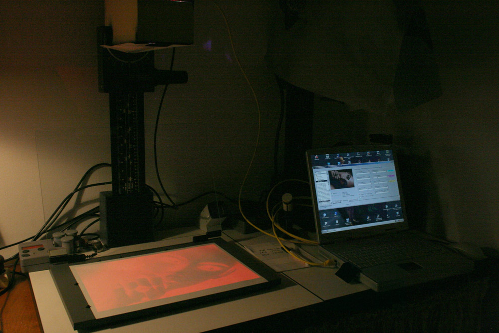

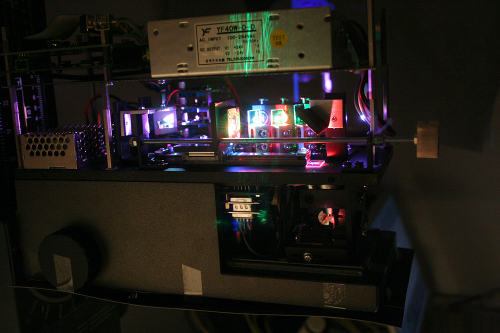

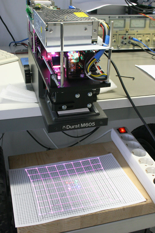

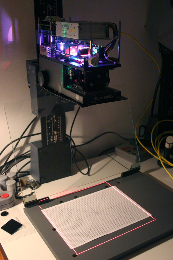

Home made "Lambda" printer.
Not for enlarging film negatives, but also (my) darkroom eqipment.
The developing process of RA-4 in the darkroom is the same like with optical enlarging.
IMG_4695_web.jpg IMG_4708_Montage_web.jpg IMG_4687_web.jpg IMG_4714_web.jpg Geometrical_Setup.jpg IMG_4691_web.jpg
View attachment 151557 View attachment 151558 View attachment 151555 View attachment 151559 View attachment 151554 View attachment 151556
So you ended up going with an enlarger head set up?
I don't see a theta lens but it looks like you modified the input to compensate?
Mine has been put on hold while sourcing some parts!
Now to commercialise it :D

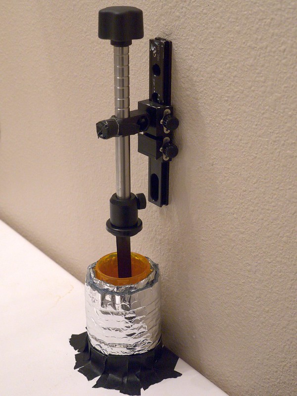

Here is an apparatus I built for conducting clip tests of unknown or found film:
The goal was to provide a means of lowering a strip of film into the developer in a sequence of controlled steps, while in the dark. In the picture you can see the strip of film attached to the lower end of the rod assembly, just starting to contact the developer.
To provide some feel in the dark for how far the film was being lowered at each step, I cut a series of evenly spaced grooves in the rod which act as detents for the ball-tipped thumbscrew which holds the rod in place. The spacing I chose provides a total of 7 steps for a strip the width of 120 film. By mounting the assembly on the dovetail rail attached to the wall I get a great deal of vertical adjustment range, which is convenient for accommodating different depths of developer or different lengths of film. Using the knob at the top I can even rotate the rod to provide agitation during development.
As you can see in the picture, my development "tank" for this contraption is really just a small plastic pill bottle! I figured that since my test strips were so small I might as well keep the tank small too and minimize the volume of developer required. The tank is wrapped in insulating material to help maintain temperature when performing cold developments, and sits in a crude masking tape "cup" which I added to help keep the tank centered in its place below the rod.
