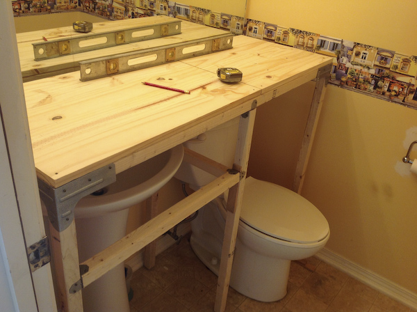

I decided to quit whining to myself and started working on moveable components for our 54" square powder room downstairs. First item was a work surface. The table in the photo is 18" x 49" x 41" tall. It is mostly finished but I need to put adjustable feet on the bottom. The garage floor is level, the bathroom is not. It's not square but it should suffice, I'm considering a way to put a small (~.5") lip on the top to use it as a secondary containment for fluids; and with a drain.
(Photo Coming later, needs to be resized for upload)

Crud! Missed the edit deadline
