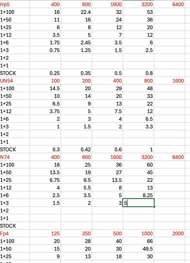

I don't have any dev times for rodinal. I have pushed un54 in the past successfully but didn't like the results beyond 200 ISO. It gets very contrasty very quickly.
I mean, I like contrast...
also, the film's got similar dev. times to hp5 so I could use that as a starting point.
(hp5- 6 min 1:25, UN54- 6.5 min 1:25)

A general "rule of thumb" for "push" development is 1.4 x normal development time for a 1-stop push, and doubling the normal time for a 2-stop push.
YMMV, of course.
Rodinal isn't considered a particularly good "push" developer, but... grain your goal is, grain get you will. (with a tip of the hat to Yoda)

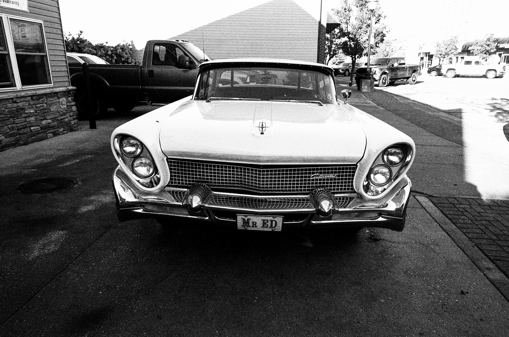

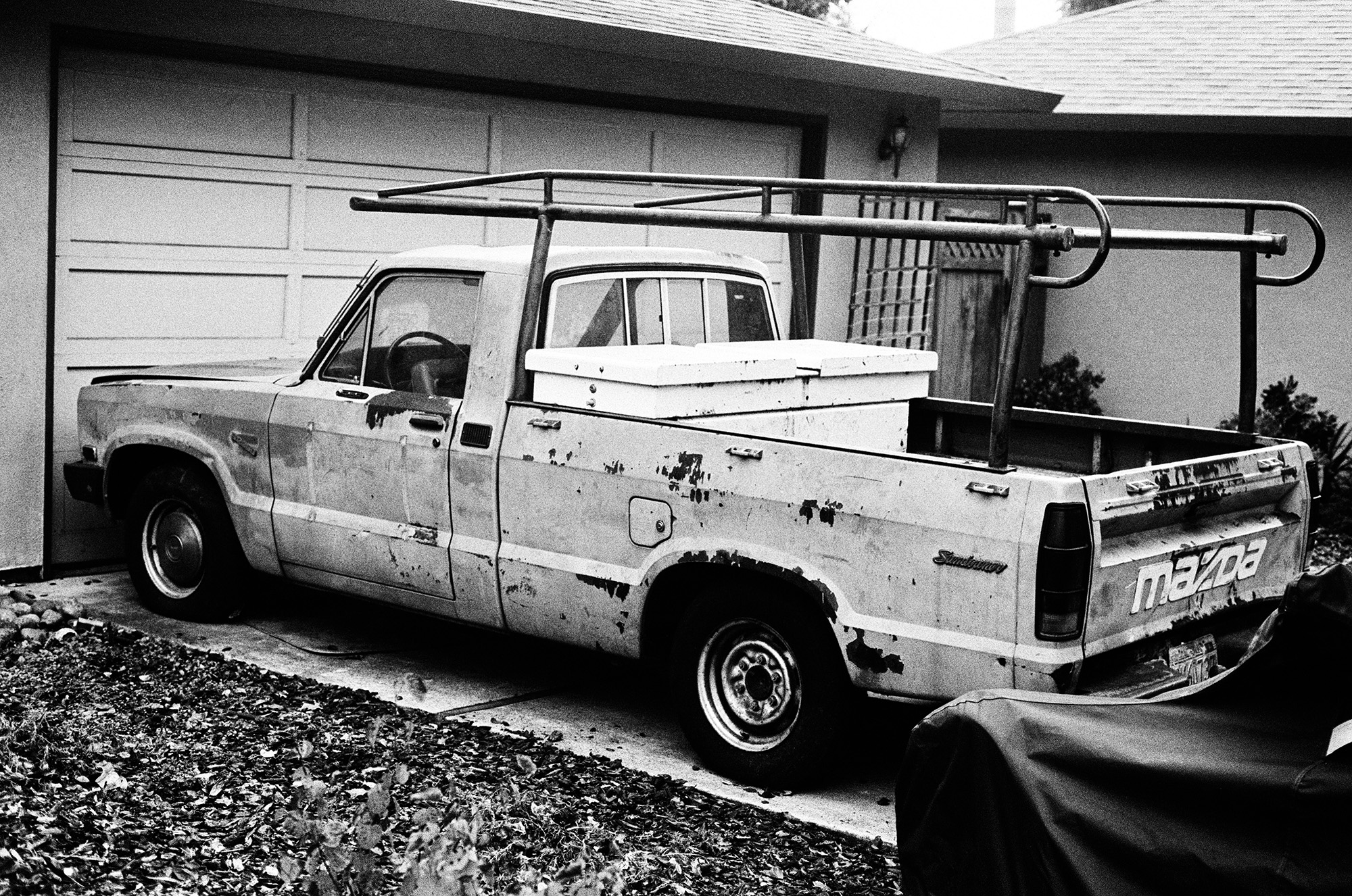

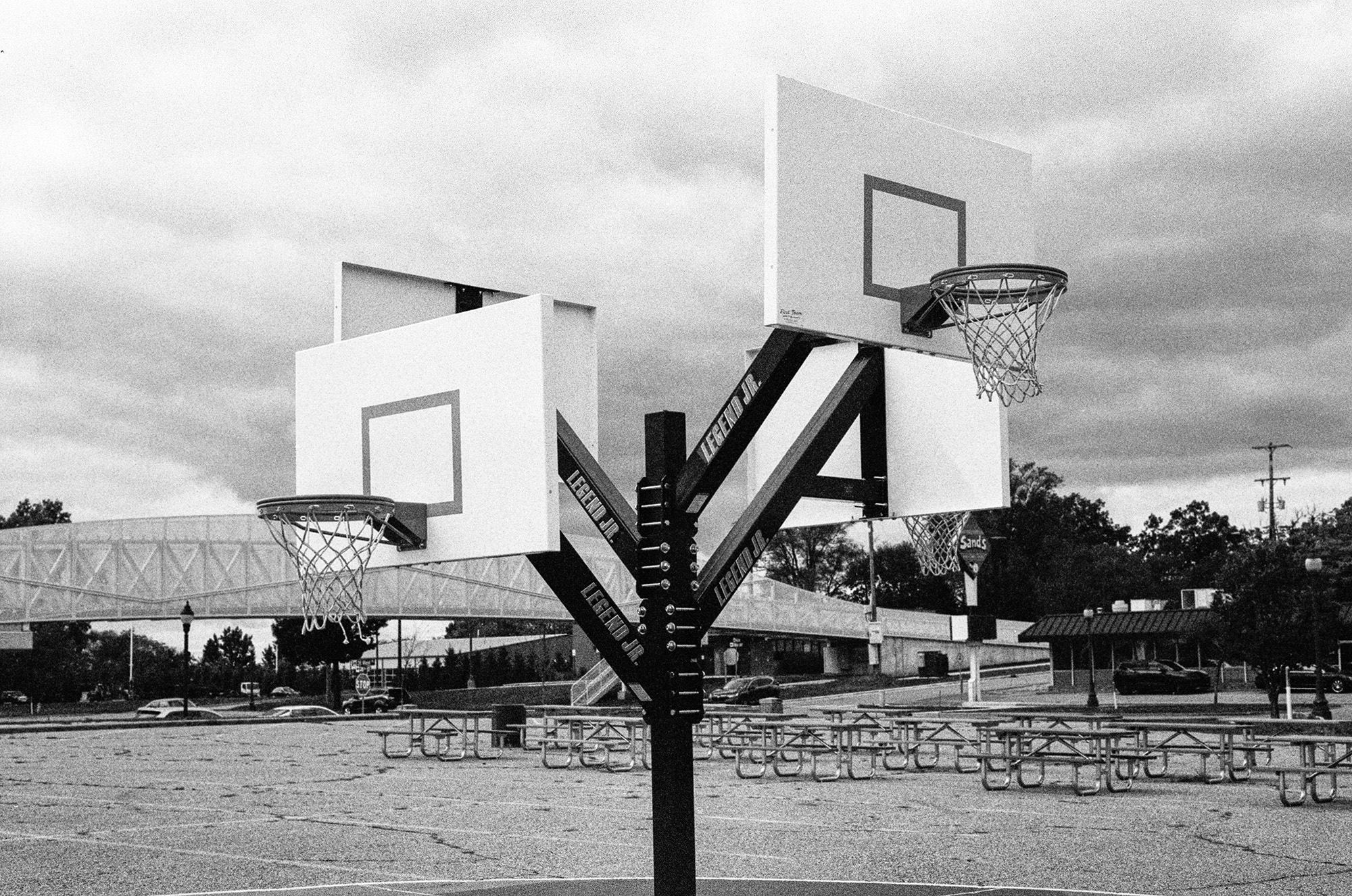

next test: FPP Derev pan 400 (99.9% confident this is Svema Foto 400) in 1:25.
Another one I am very satisfied with, and qualifies for push and lower dilution trials
while information's definitely being lost in compression- Foma Ortho 400 in 1:25 Rodinal is one of the grainiest 400 speed examples yet, and definitely qualifies for lower dilution tests
currently- still trying more 400 speed films in 1:25, but I'm also starting the low dilution developments- just did Hp5 in Rodinal 1:12, and will try more lower dilutions and more qualifying films. also planning on trying Adox FX 39 in the spring- want to do Dektol too, but don't know when
Another one I am very satisfied with, and qualifies for push and lower dilution trials View attachment 412765 View attachment 412766 View attachment 412767View attachment 412768 View attachment 412769

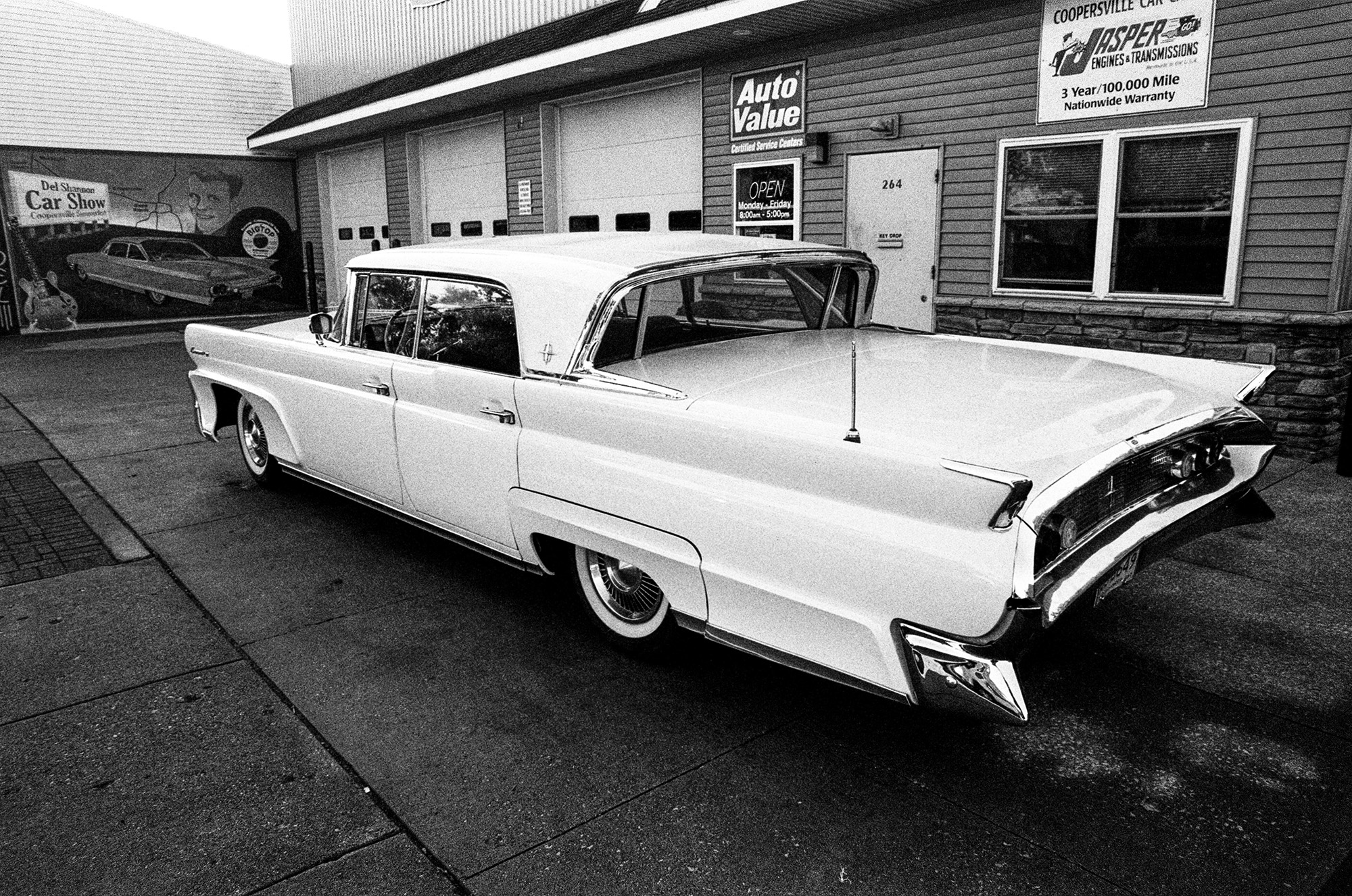

Main street Coopersville, MI my home town. My father was born there in 1924 on our farm. The last picture with the sign Del Shannon car show says it all. Chuck Westover (Del Shannon) taught my mom how to drive a 39 Ford with a stick shift by taking her out in a wheat stumble field and she learned from there. My folks and Del Shannons folks were very good friends.

Those pictures of yours are high contrast, which helps them look even more grainy. I don't worship grain, but I don't hate it either.

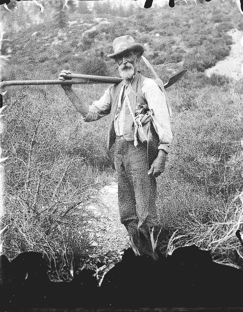

Reticulation gives what appears to be coarse grain. I never had it happen to me but have seen some examples.

The reticulated prospector
