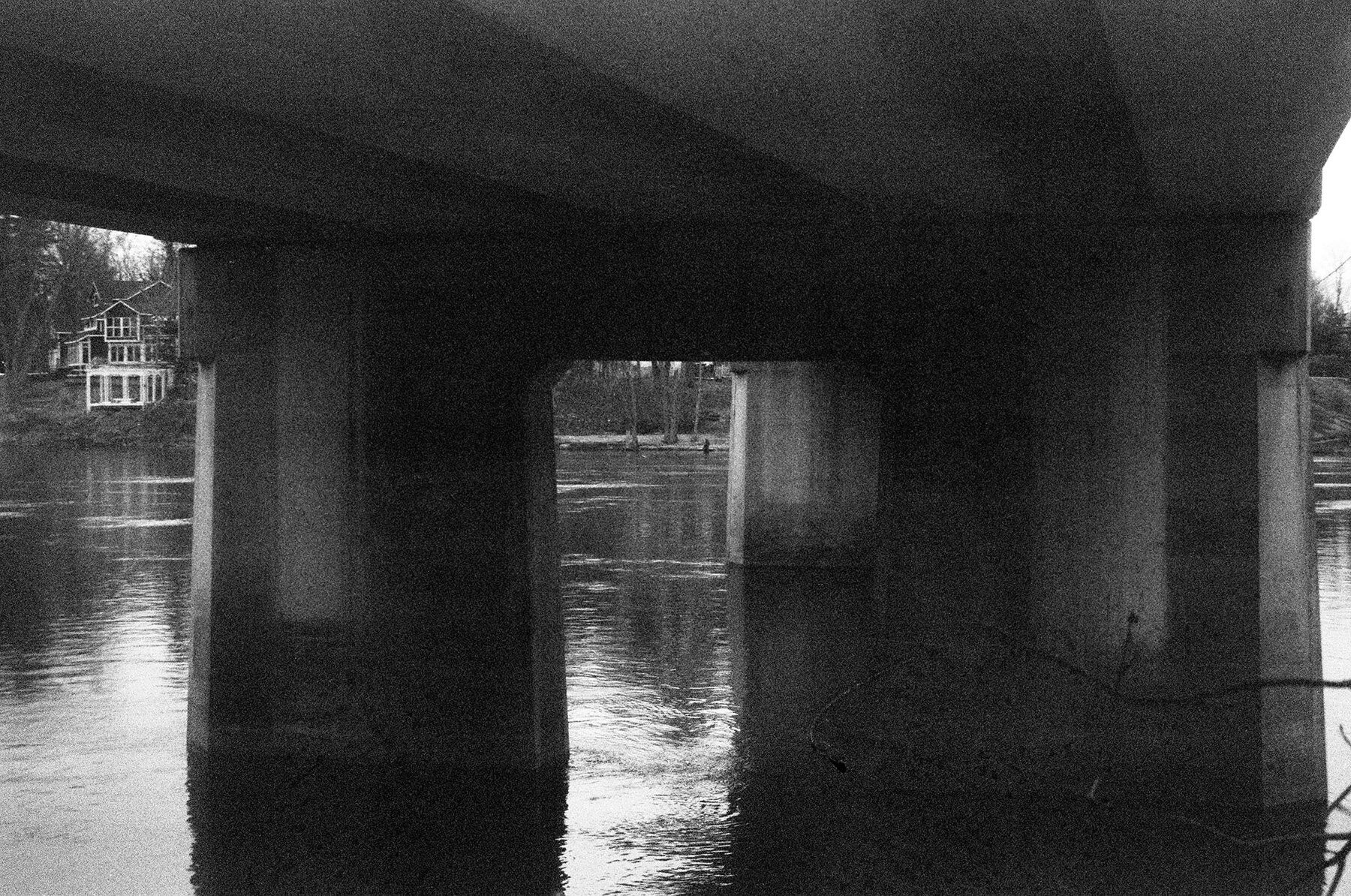

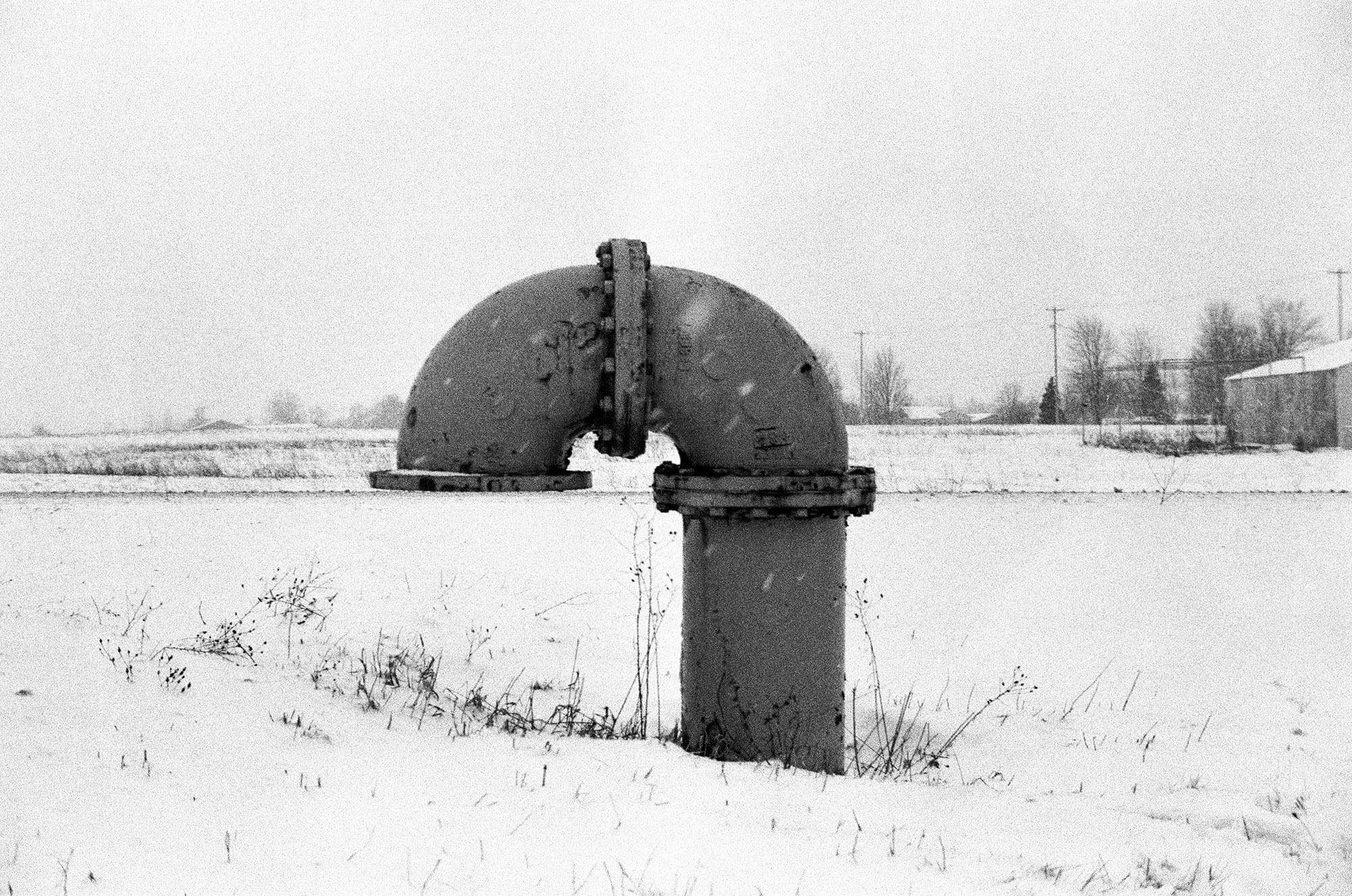

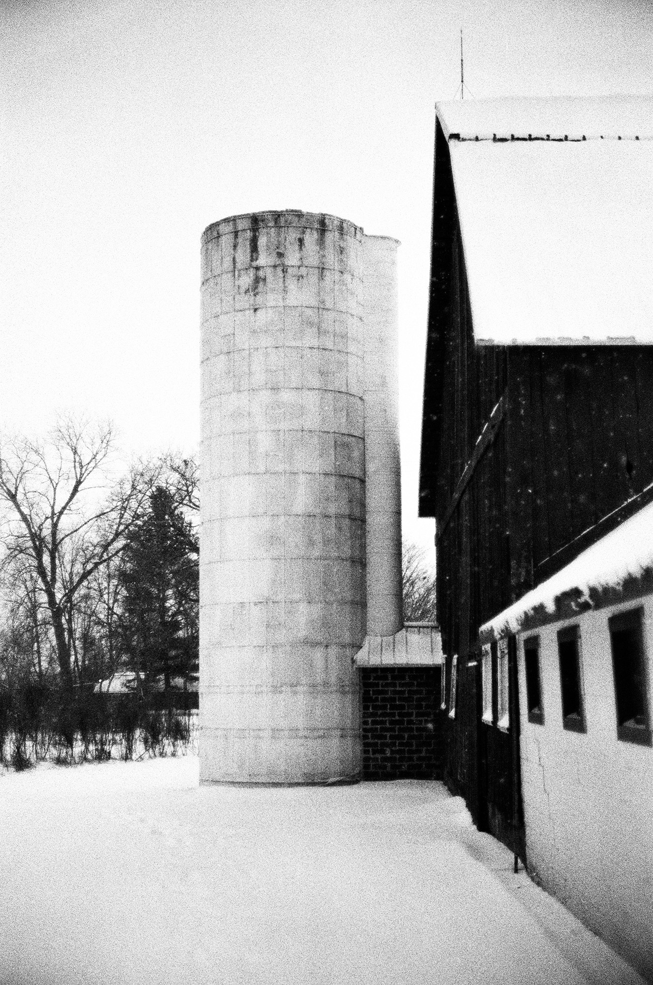

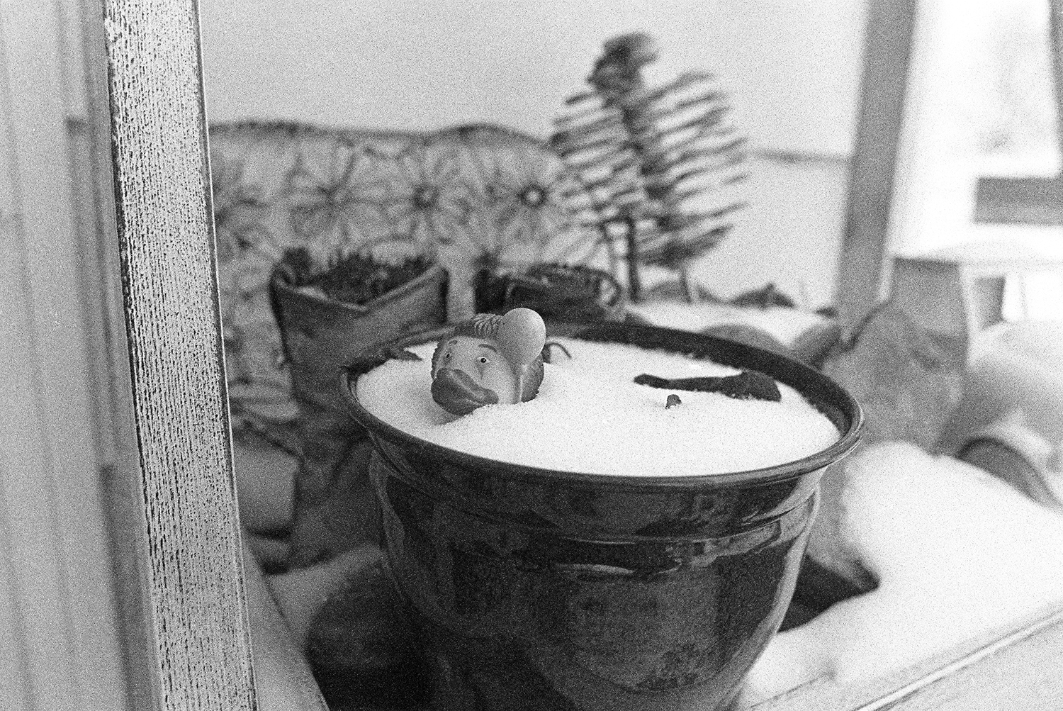

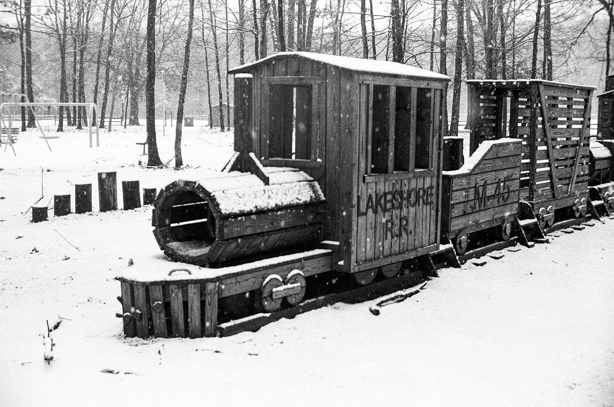

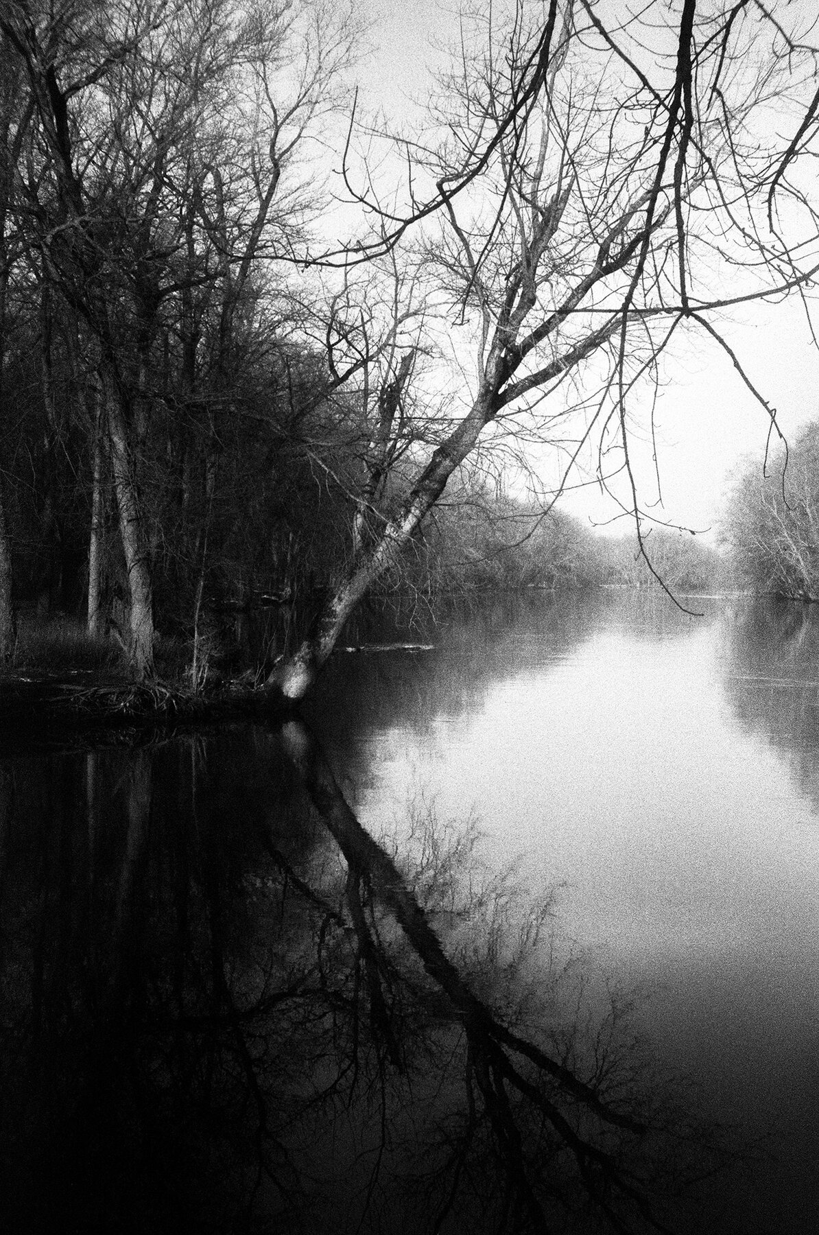

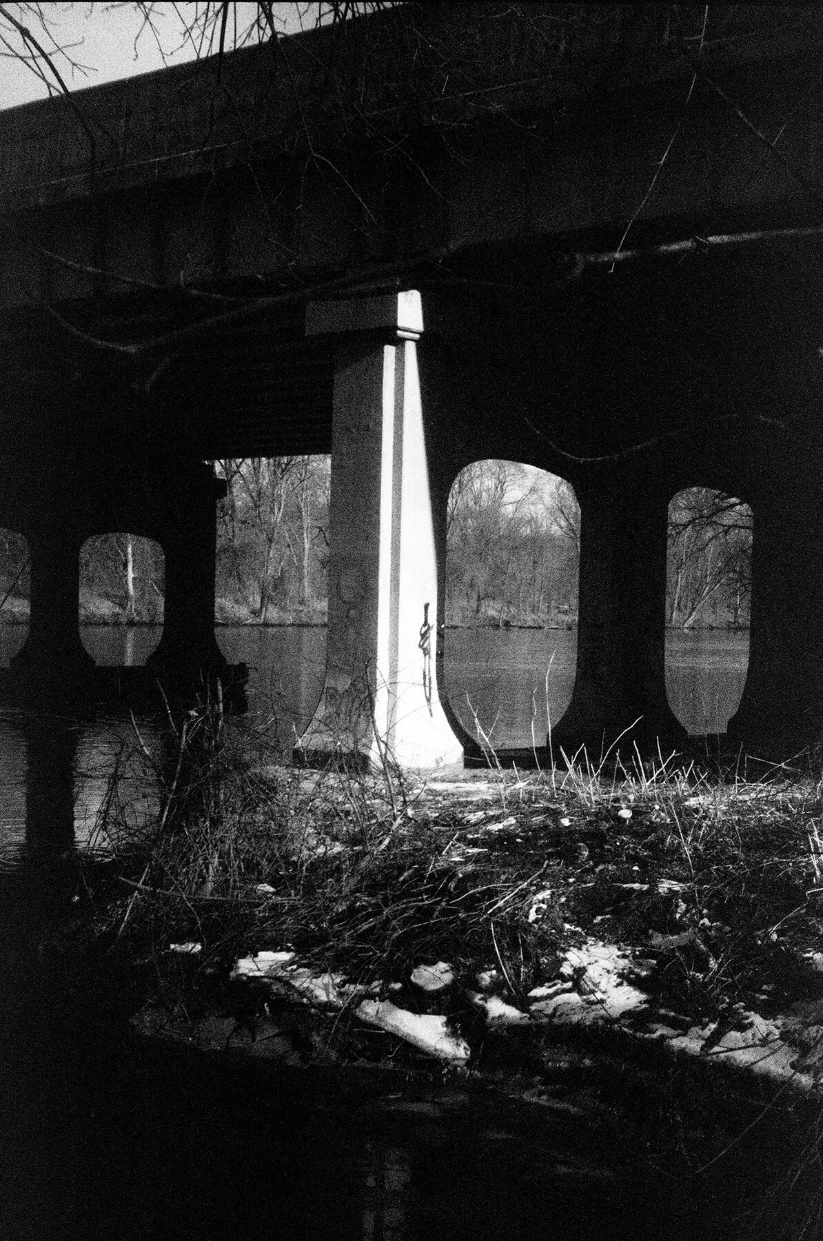

PT. 1:

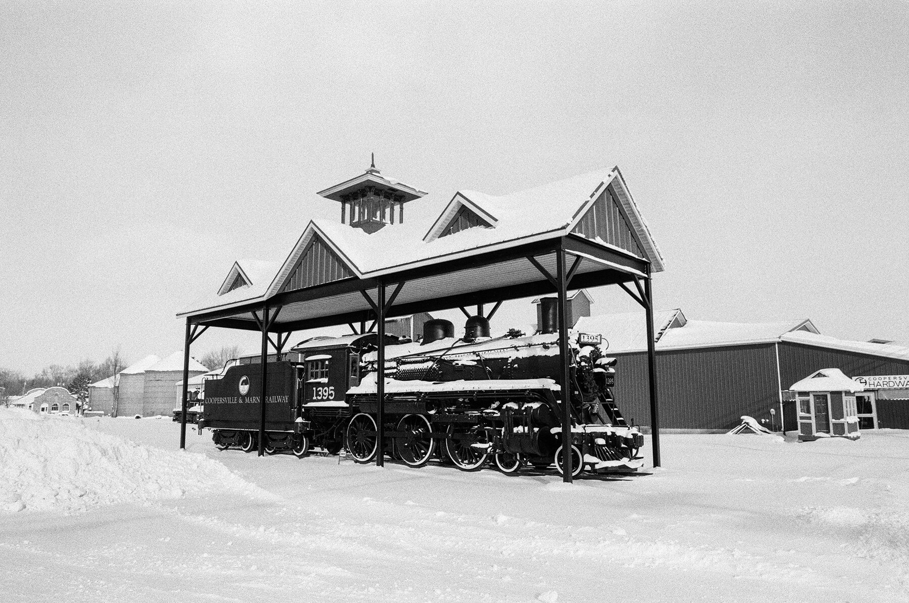

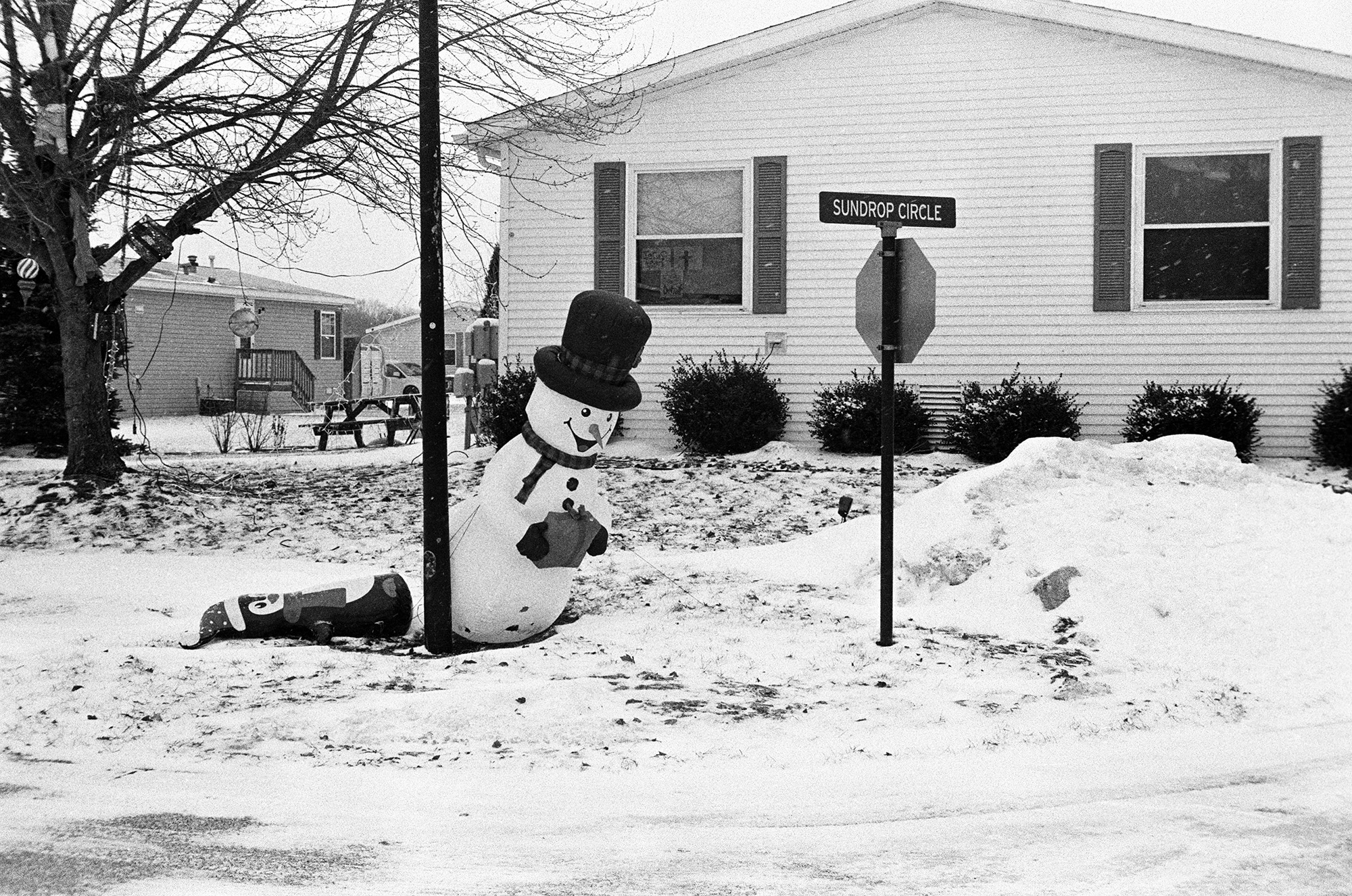

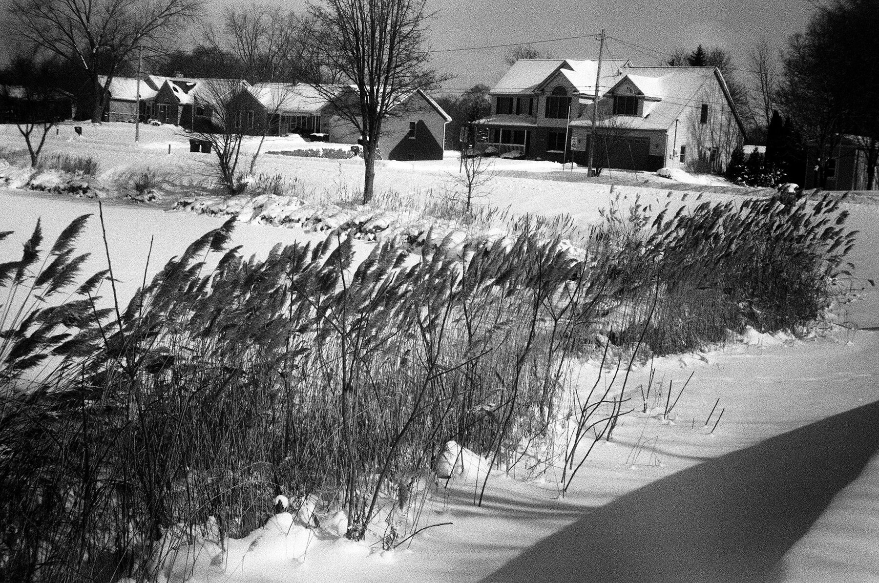

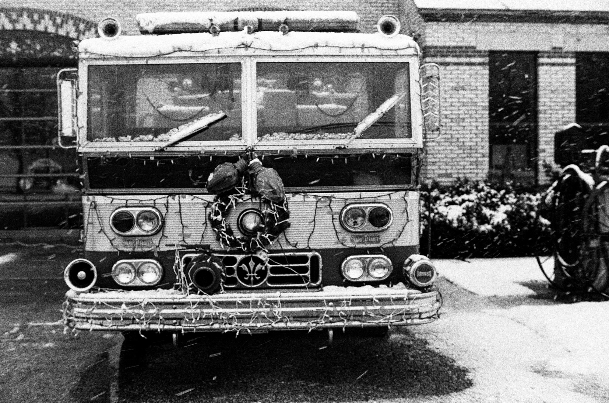

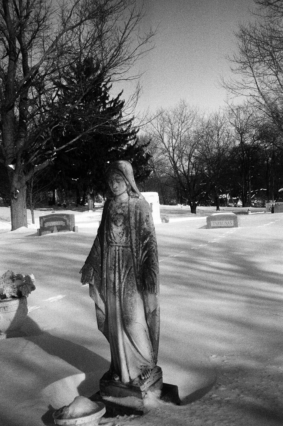

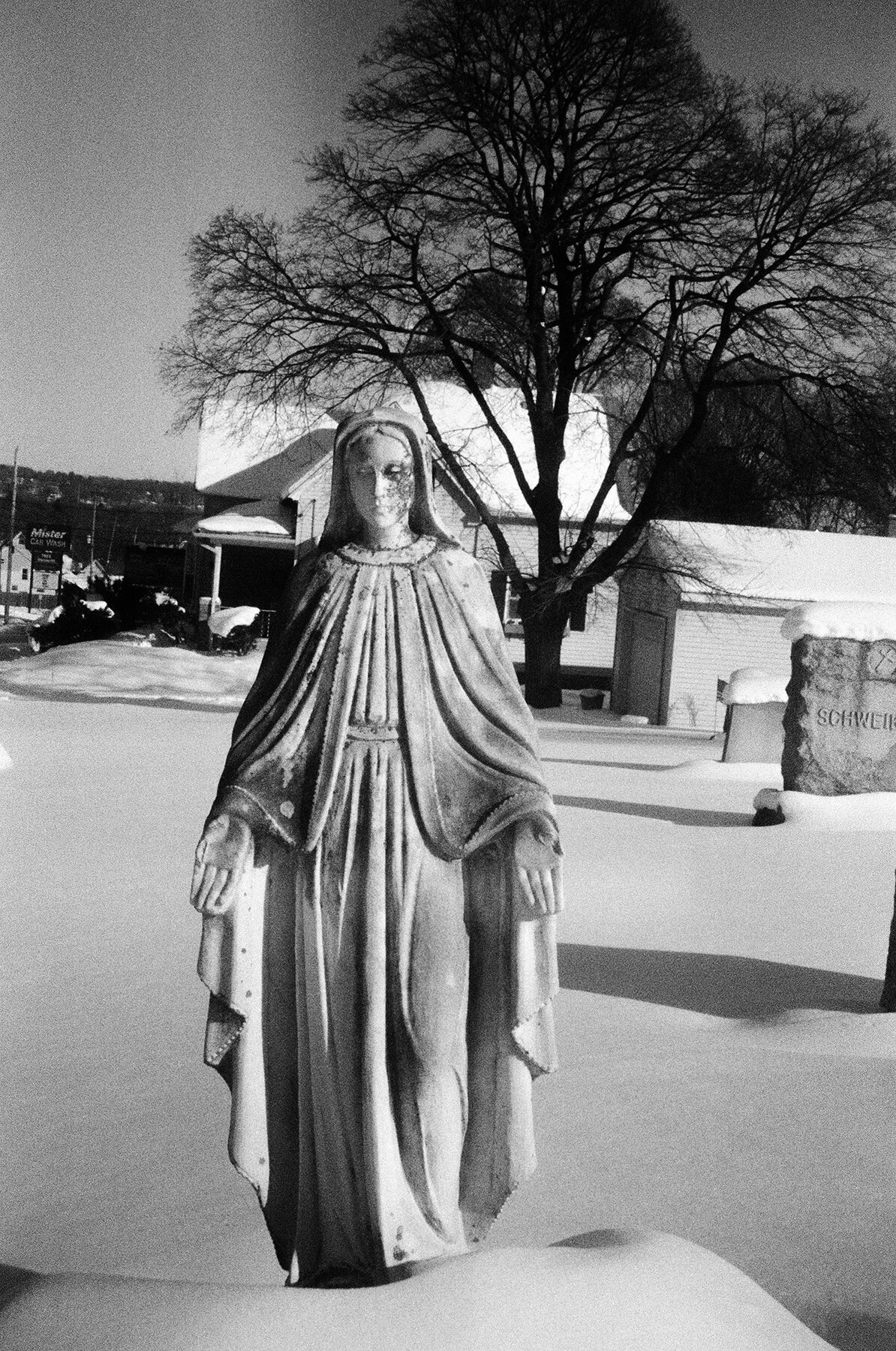

HP5, Rodinal 1:6, 1 min, 45 s. 68ºF, Petri 7s
(The perils of shooting at f 1.8...)^
Rodinal 1:3! That's nuts. Great pictures.
Well it certainly is to a Scotsman like me 😎 Actually if the same size prints looked similar on a darkroom print I'd say that Rodinal 1+3 looks OK but I do wonder what, if any, improvement there is on 1+25/50

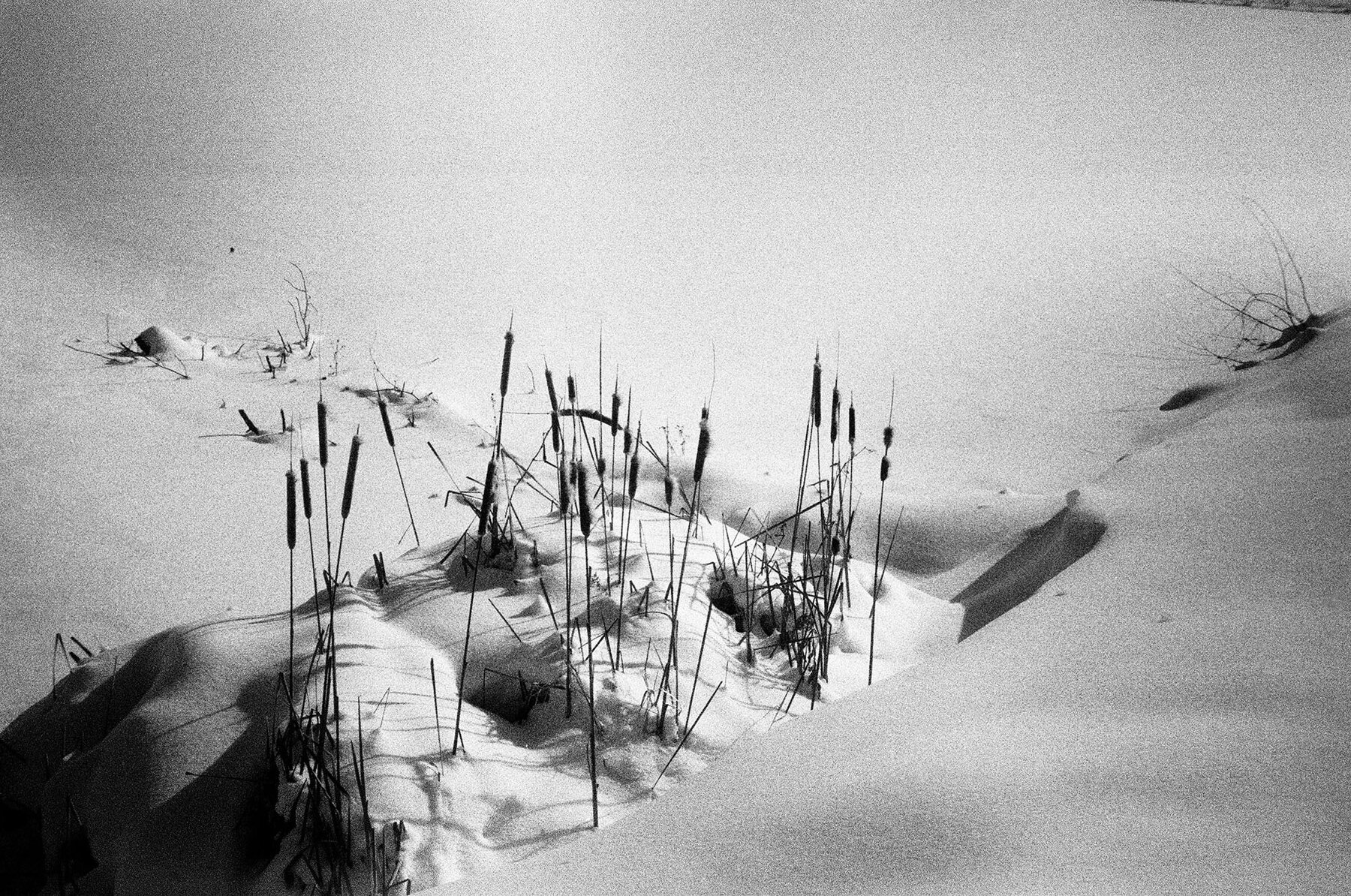

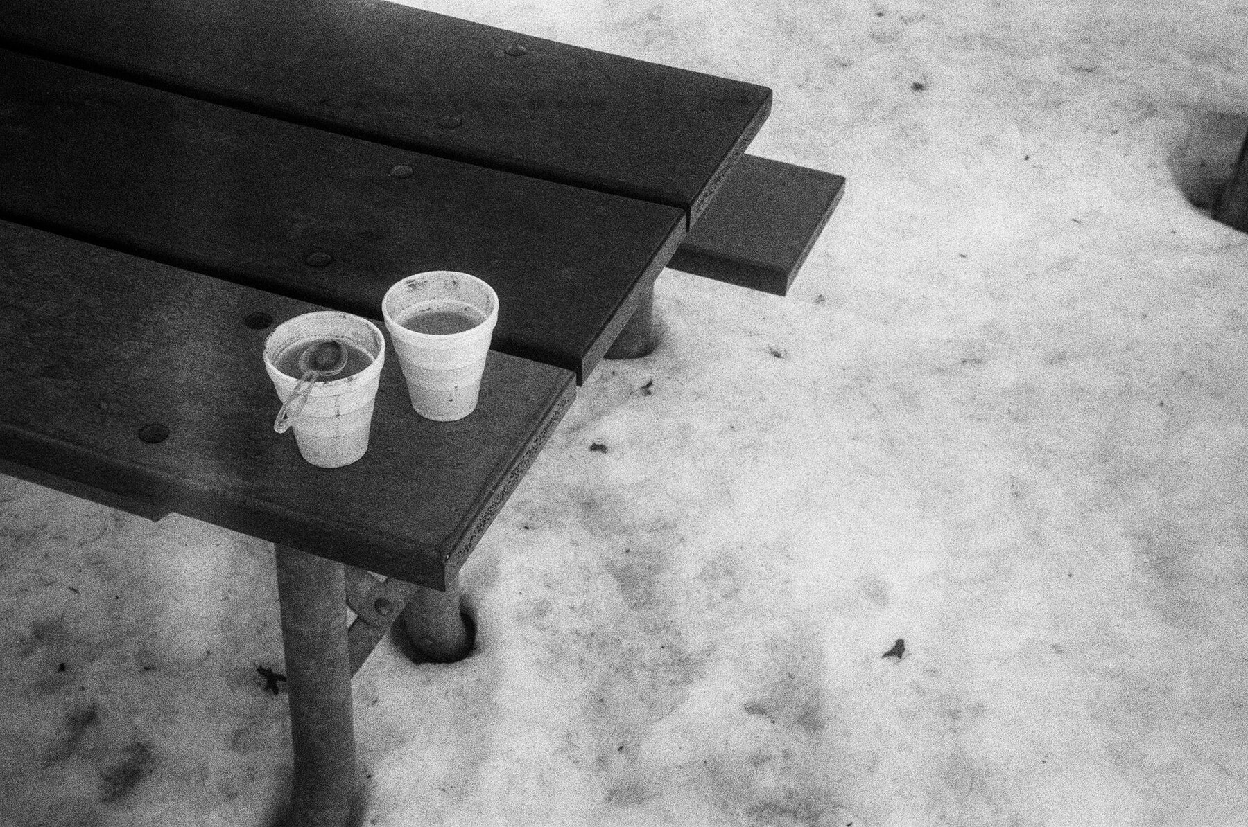

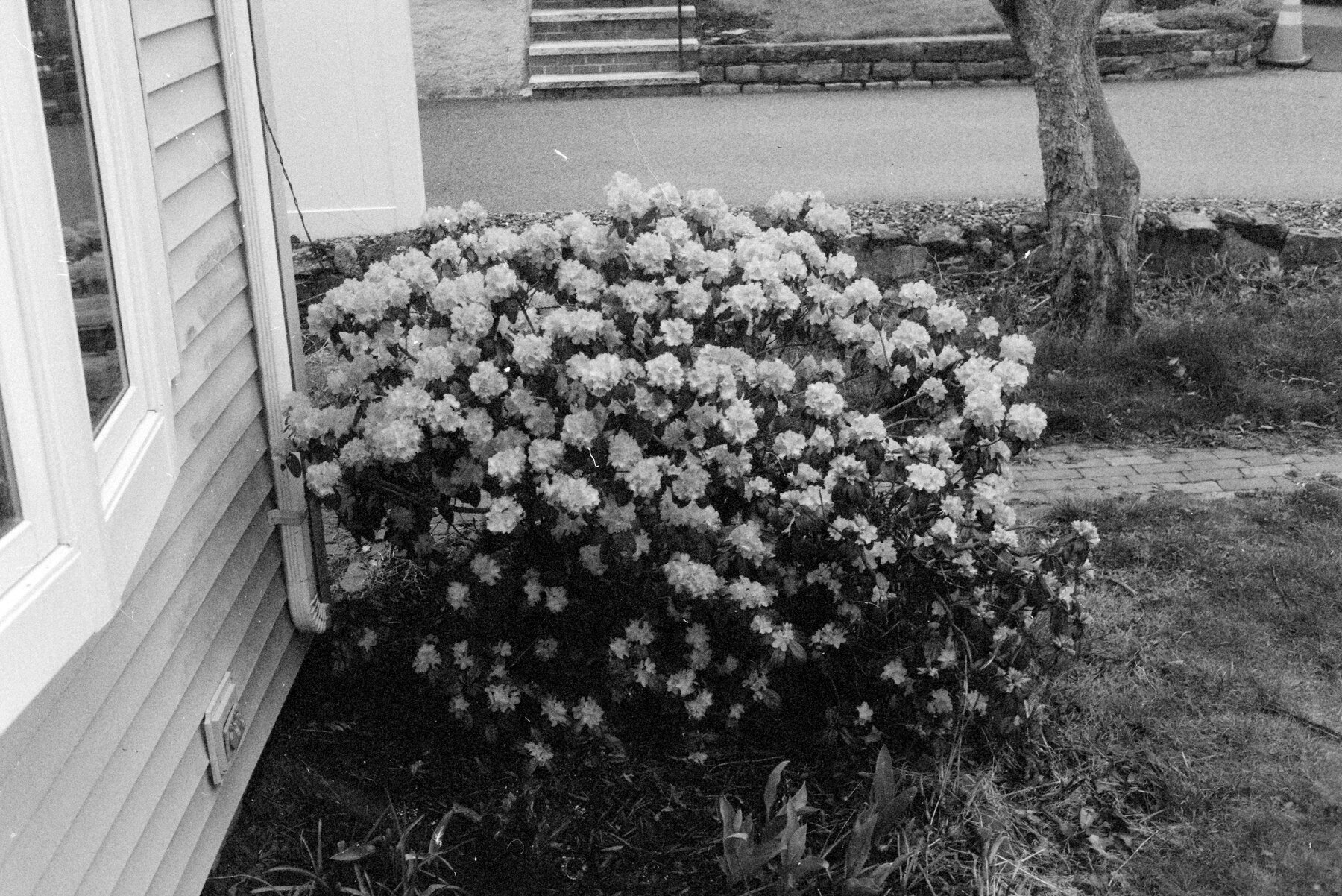

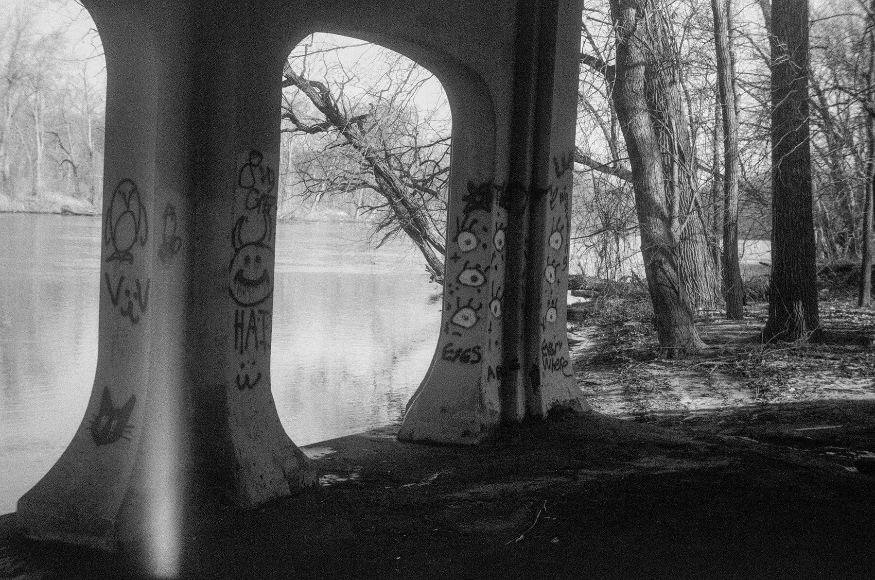

Kodak SO-078 developed in Kalogen 1+50 for 12 minutes.
This isn't quite to the level of some of the photos here, but it's pretty chunky. Definitely seems like a high speed film in Kalogen could be a good candidate. I think I've got a bit of orwo n75 left in the fridge somewhere so maybe I'll give that a try
