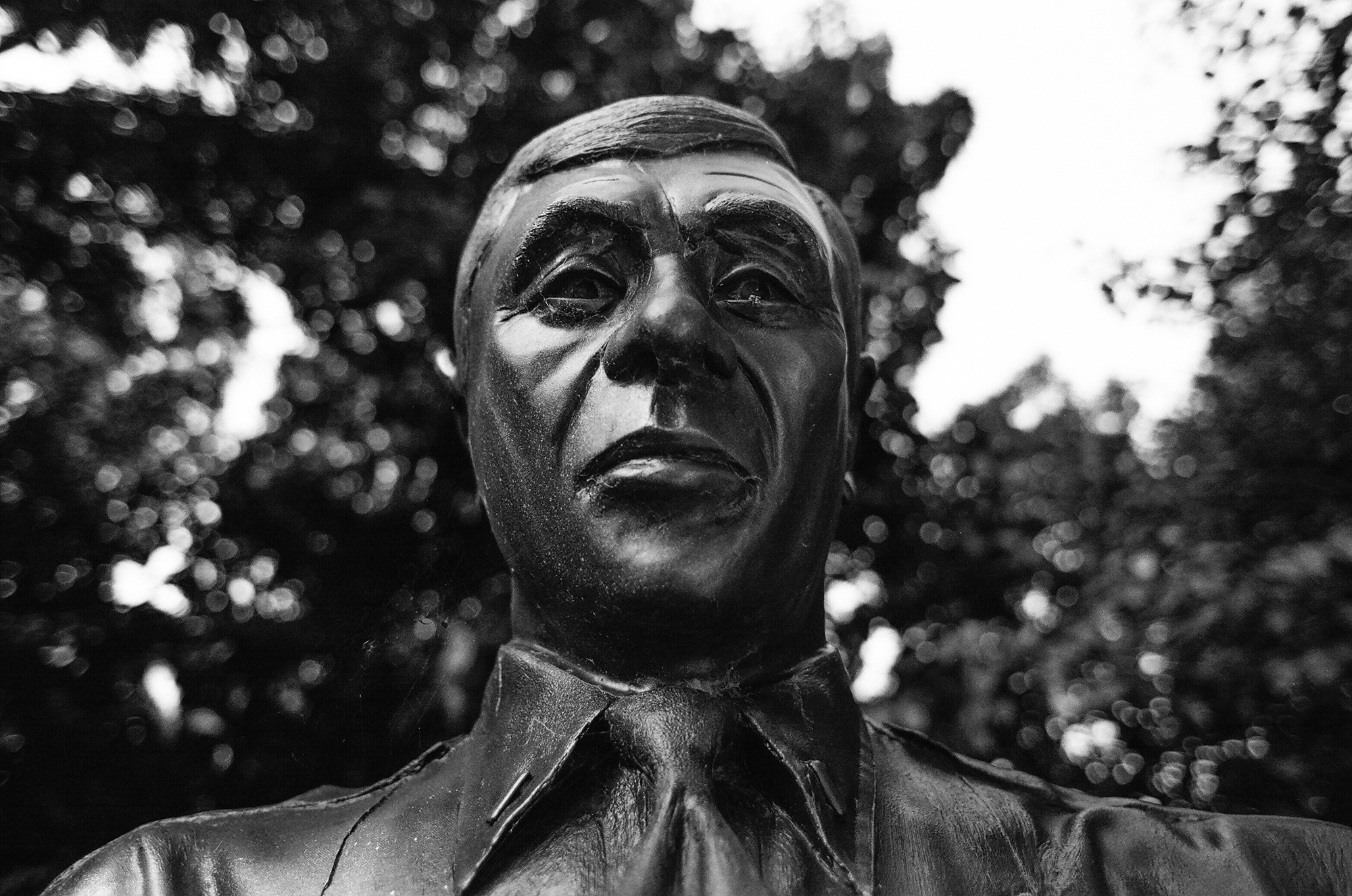

I'm experimenting with fresh TriX (in 120) developed in D76 1+1.
I had heard TriX is extremely grainy but I'm surprised at how beautiful and well contained the grain is. I wonder if modern iterations of TriX have been revised resulting in more contained grain.
Gorgeous combo by the way - I can see why it's considered a classic.

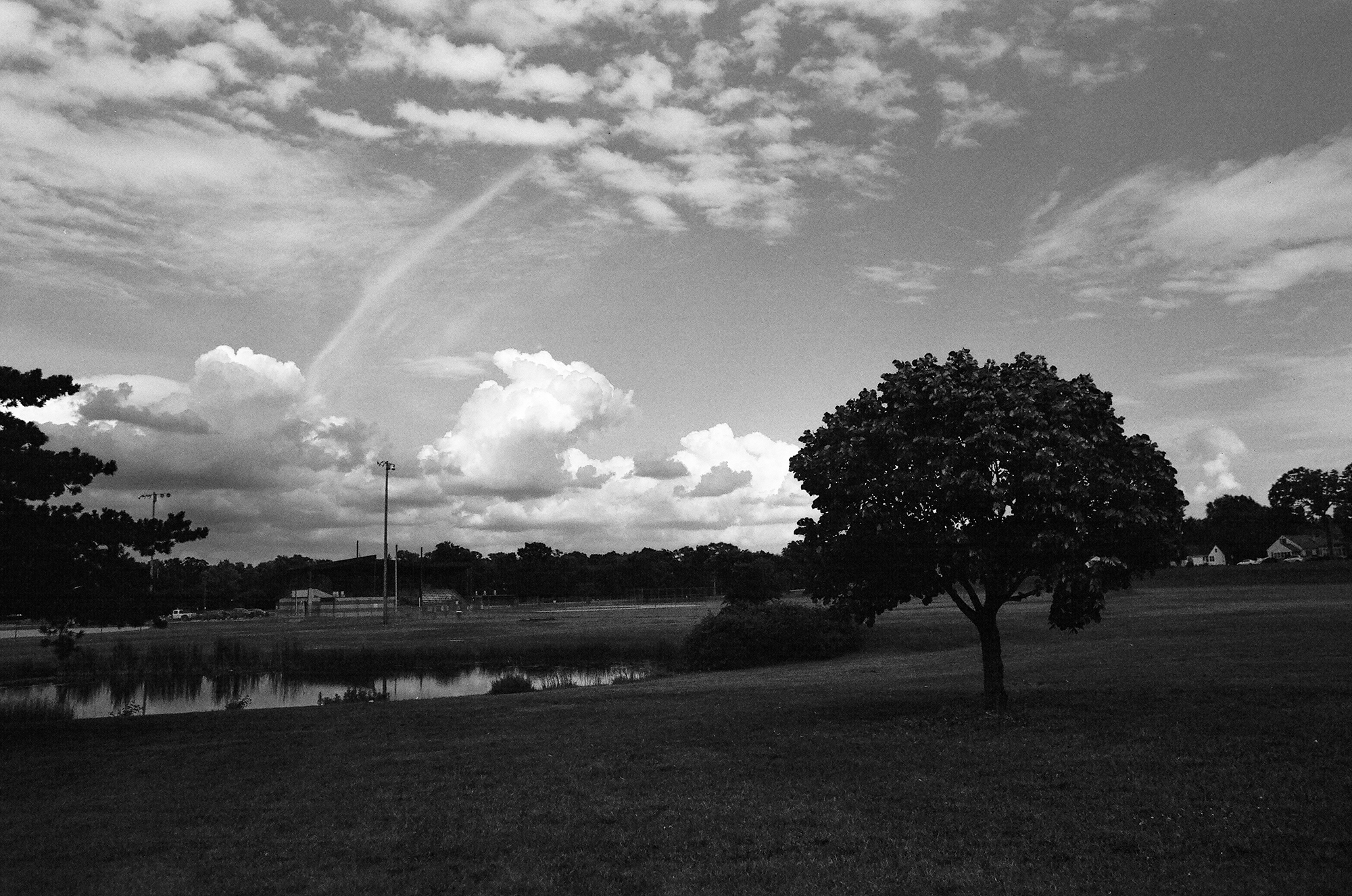

Modern Tri-X is less grainy then, as an example, the mid 1970s Tri-X that I used for most of these:

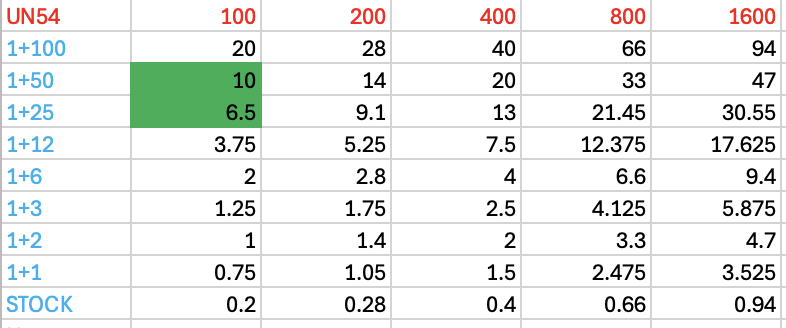

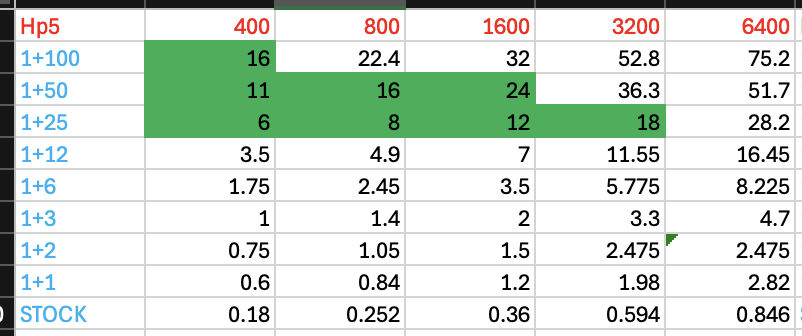

here's where my calculations are at for Rodinal- based on differences from established film dev. times, info from this forum, and comparing dev times from other films, here's what I've established:
push times: +1 multiply dev time by 1.4, +2 double dev time, +3 multiply dev time by 3.3, +4 multiply dev time by 4.7.
for lower dilution times, this video proved to be an incredible source:
So based on this, and differences in times from other films, here's how I calculated the lower dilution times:
1:12- 1:25 time multiplied by .58
1:6- 1:25 time multiplied by .3
1:3- 1:25 time multiplied by .2
1:1- 1:25 time multiplied by .1
(stock time taken from the video- haven't decided if I want to go that far or not)
did similar calculations for fx 39 dilutions, but I'll share that when I get there

(green times are ones taken from the massive dev chart).

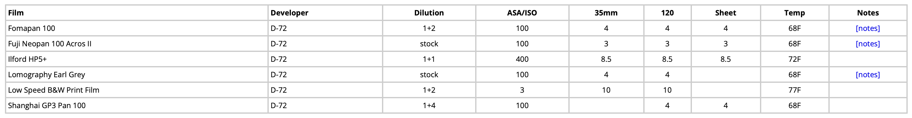

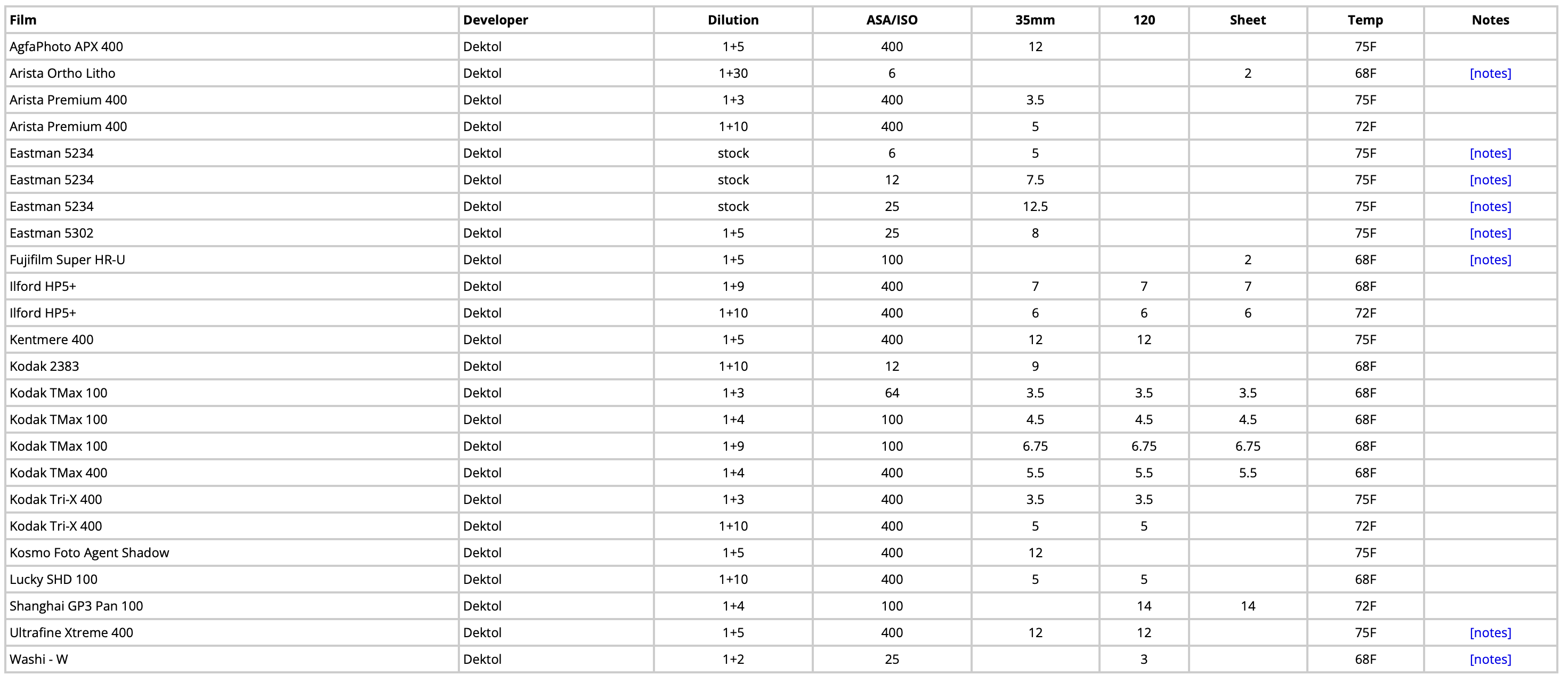

also- looking into Dektol/ d72 films most (even Kodak films) don't have listed dev. times. so unless you guys can point me to some resources to find dilution and dev times I don't know if I'lll try it.
I've only had a brief look at the video, but what I take from it is exactly what I'd expect: times don't scale very well if you hug the edges of the process envelope. Here he had been doing clip tests with minimal amounts of undilute rodinal and found that the results were totally different when he scaled up to a full roll and 300ml. In a similar vein, I expect you'll run into trouble if you try to extrapolate a time you based on the difference between 1+50 and 1+25 to extremes like 1+1. Times get so short that the dynamics of wetting the emulsion and diffusion of the developer into it as well as prolonged development by droplets of developer clinging onto the film after dumping it become major factors. Uneven development is one clear risk, but I expect the gamma/contrast will also not scale as expected.
Not saying it can't be done or you won't get an image. Just that it's not a very solid way of determining a development time suitable for normal photography. For sake of the experiment, of course, this can be a lot of fun, also if you try to make sense of the actual result you get. It can be interesting for sure.
yeah. I don't have any scientific means of checking my results, but so far, 1:12, 1:6, and 1:3 have all worked (I'll post them eventually). but I am prepared that uneven development could be a factor, especially if I try this with 120 film. and yeah, the tray development didn't really help me determining full scale times. I'm also not doing this in (mostly) one go- I am taking my time and checking my math and making changes as needed to my calculations.
I'm expecting 1:1 to work, but I'm predicting 1:3 is going to be the upper limit for reliability.
