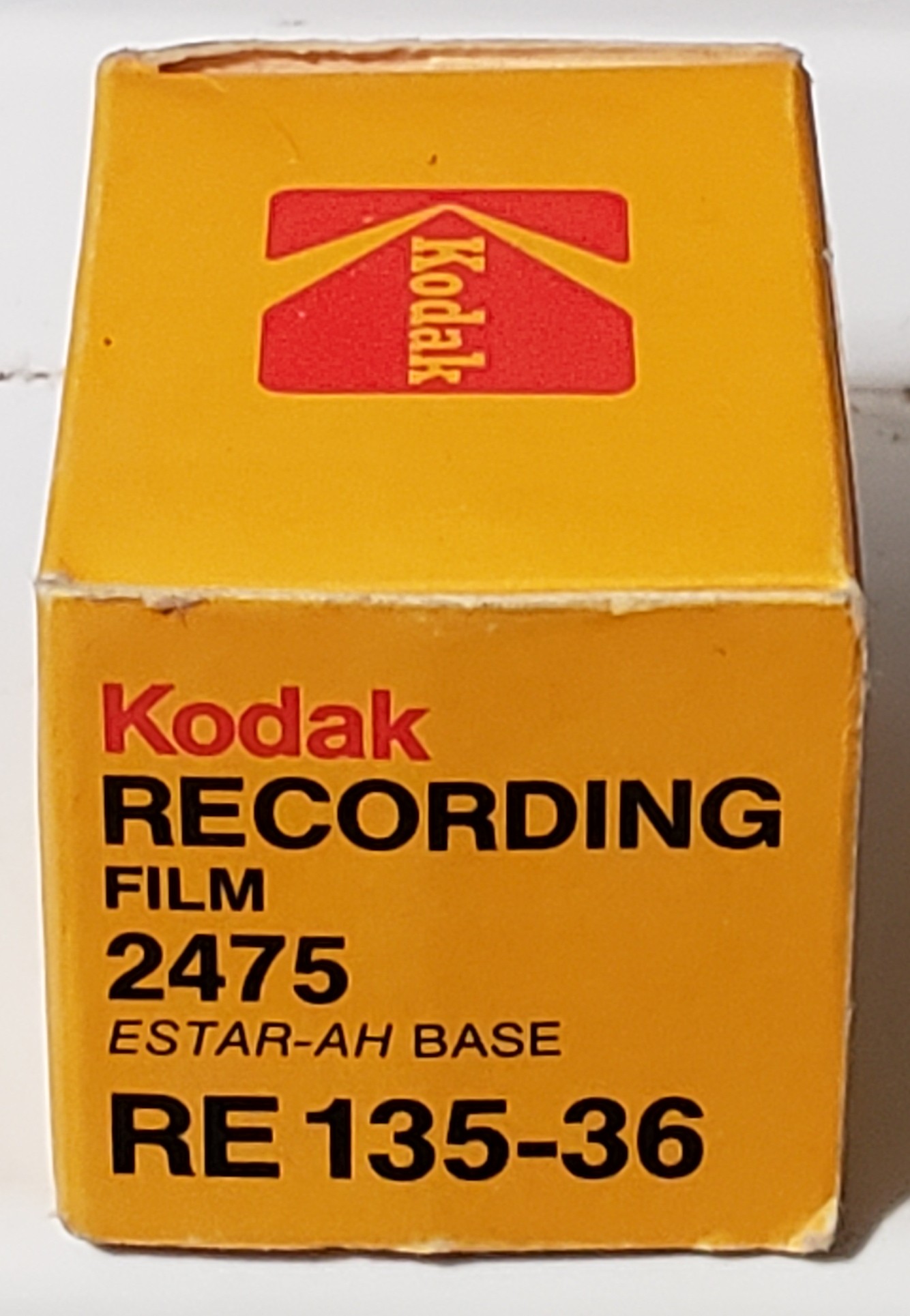

Don't think its still manufactured but back in the day Kodak Recording Film 2475 was the grainiest commercially available film. Curly ESTAR base.
Developed in Dektol or Rodinal.
Wow all outdated but some still available!
