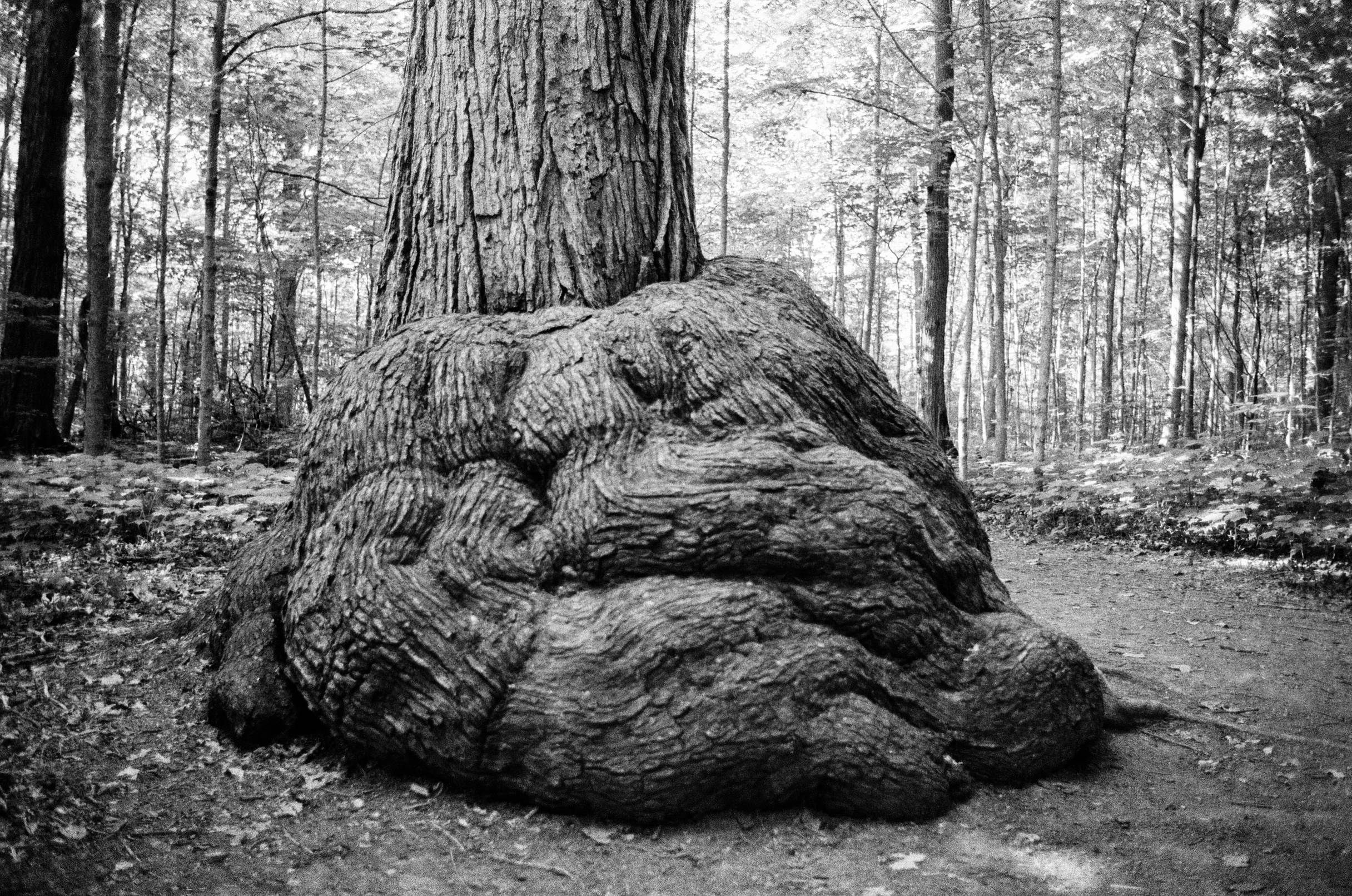

Fomapan 400 is really not that grainy. That is, unless it's severely underexposed or overdeveloped or negative-scanned improperly. This happens a lot I think, based on what we see on social media: the film is cheap which encourages people to use it to 'experiment' (which often involves exposing it, developing it, and scanning it without a lot of care).
Here's an example in 35mm. Rodinal 1:50, exposed with the internal reflective meter of a Canon Eos 3. 40mm f/2.8 pancake. Exposure compensation set to +1.3 EV (so 'exposed at 160EI'). Negative scan.
1:1 detail from the original negative scan at 5000 dpi

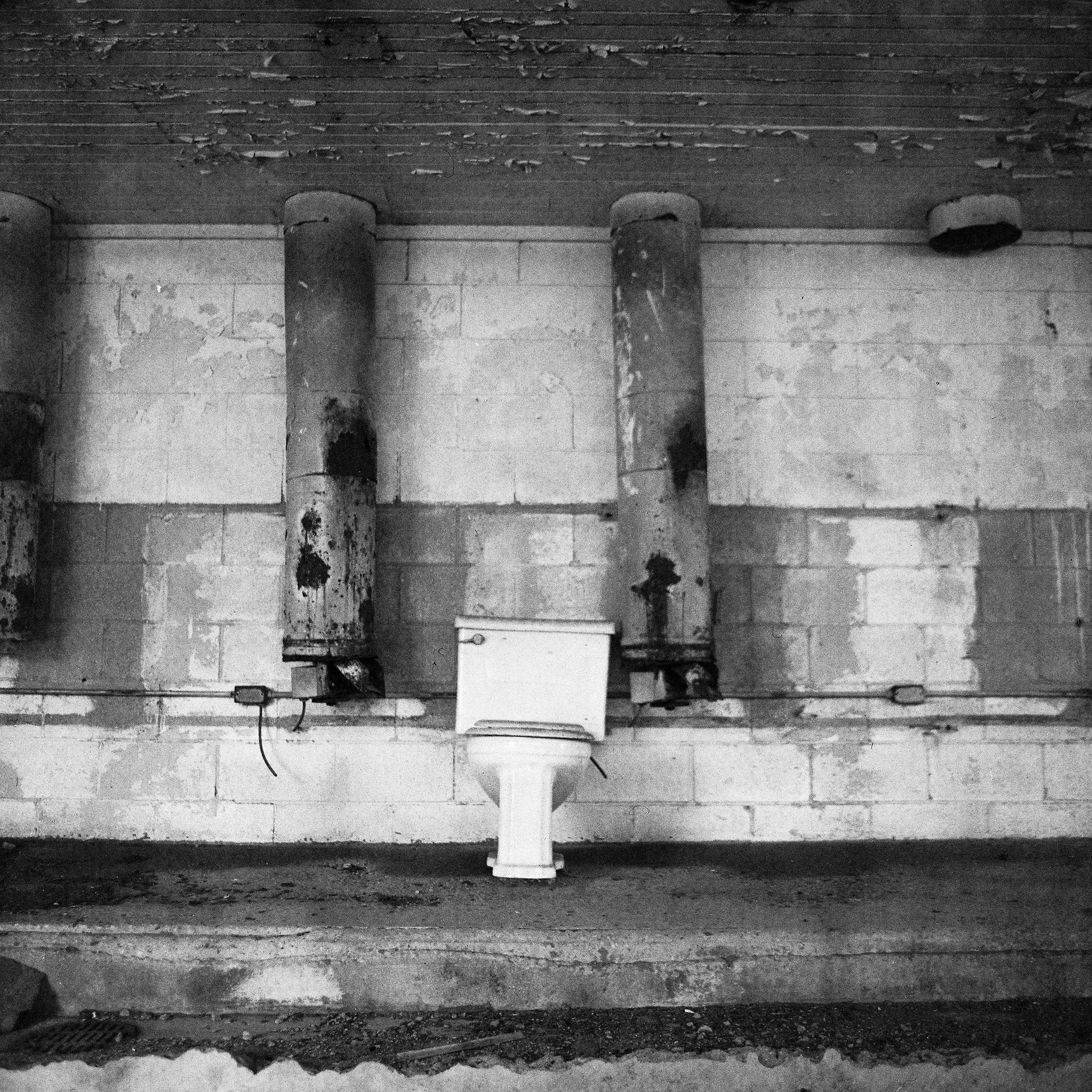

Foma Retropan 35mm in Rodinal
That looks really nice! I still think Fomapan 400 is pretty grainy when shot at box speed though. Don’t get me wrong, I love the look of it, especially enlarged on paper.
This is Fomapan 400 auto exposed in a Konica C35, semi stand developed in Rodinal 1:100.
That's because shooting it at box speed it's underexposing it. Foma 400 just about reaches 320 ei at pretty high gamma (~.65 or so) in specialised developers such as Fomadon LQN or Microphen.
Yes it looks great wet printed, even less grainy than when scanned.

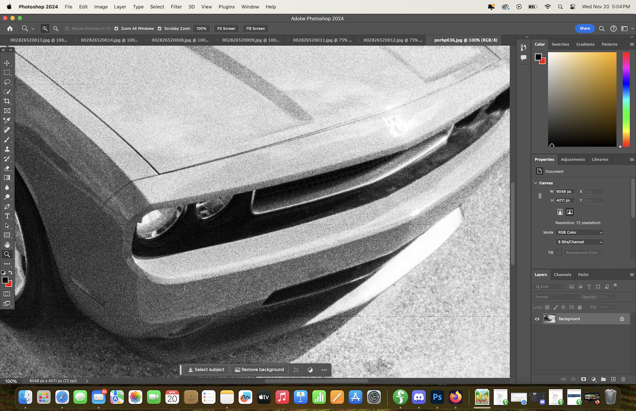

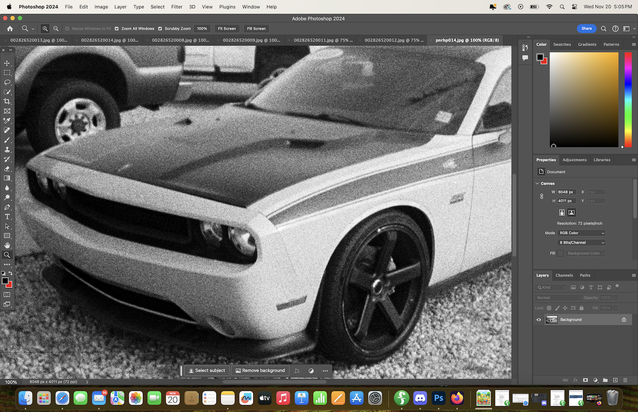

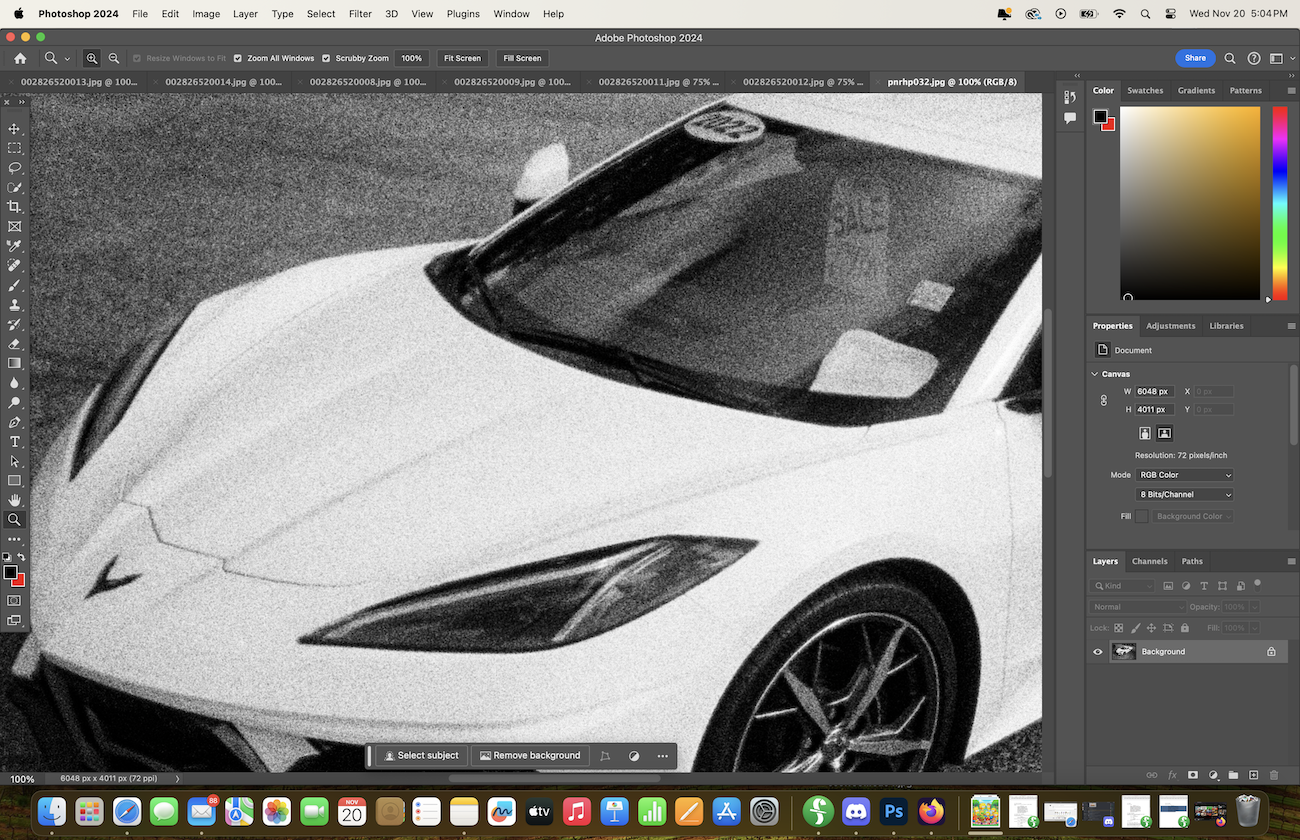

OK, over the summer, I did try a foma 400 and hp5 in 1:25 Rodinal, I just don't know when I'll share some results yet. but... for the sake of comparison, I also did another washi f bracket test, but this time used d76 1:1. this is a trio of uncorrected scans, iso 400-100
Tried HP5 in Rodinal 1:25- you can definitely see the grain when you zoom in on the uncompressed files
(note, I did use a Vivitar PN 2011 [aka a plastic point and shoot])

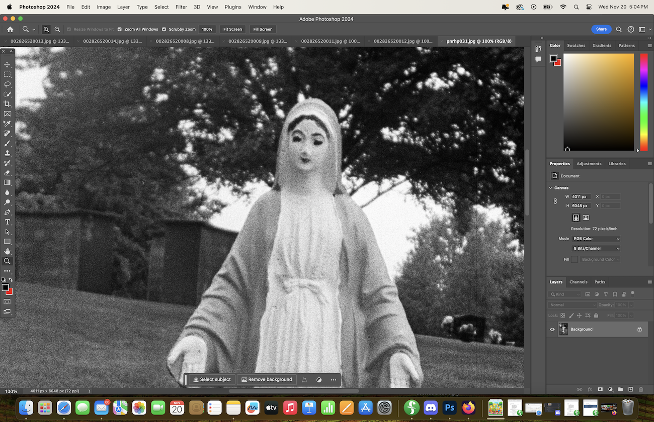

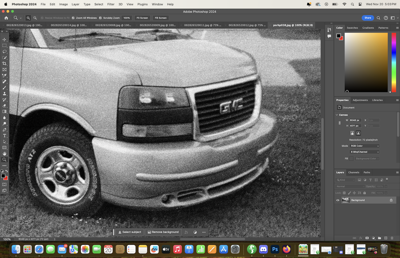

How much of a crop/zoom in the examples? I regularly process HP5+ in Rodinal, it never looks that grainy. The grain is crisper, though. I rate it at 160, not box speed. Are these prints or negative scans?
these are scans, here's 100% zoom in photoshop, though there is going to be significant detail loss compressing these for upload

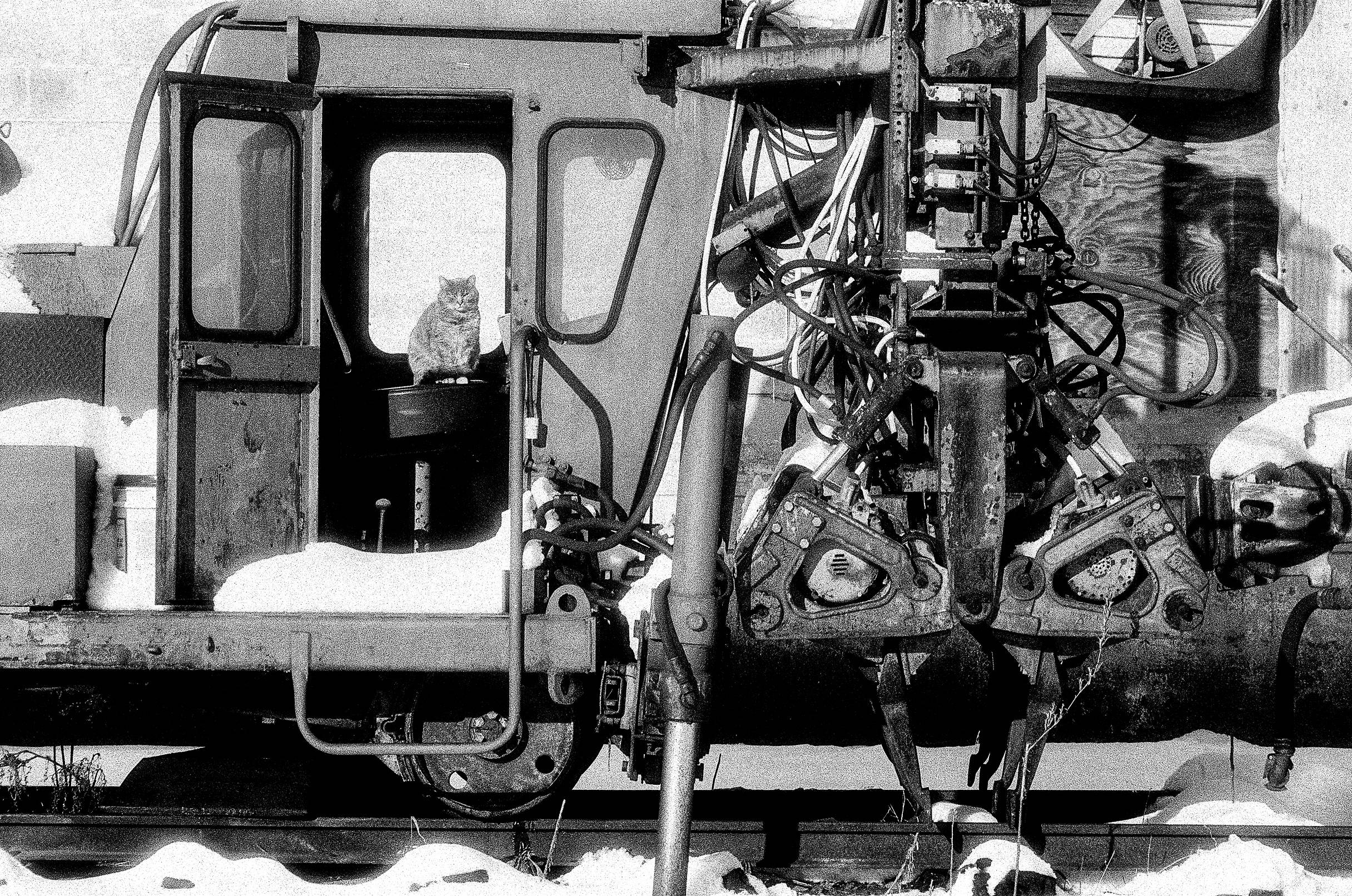

Grainy films are Orwo N74 and N74+, but with good sharpness and good anti halation layer. They are sold as Bergger Pancro and Lomo Kino Berlin. Developed in Adox XT-3, the results are still grainy. I you choose Rodinal instead, the grain will become worse (not tried, I don´t use Rodinal).
Canon 7s, Jupiter-9, Bergger Pancro 400, Adox XT-3 stock. 10 Min.
