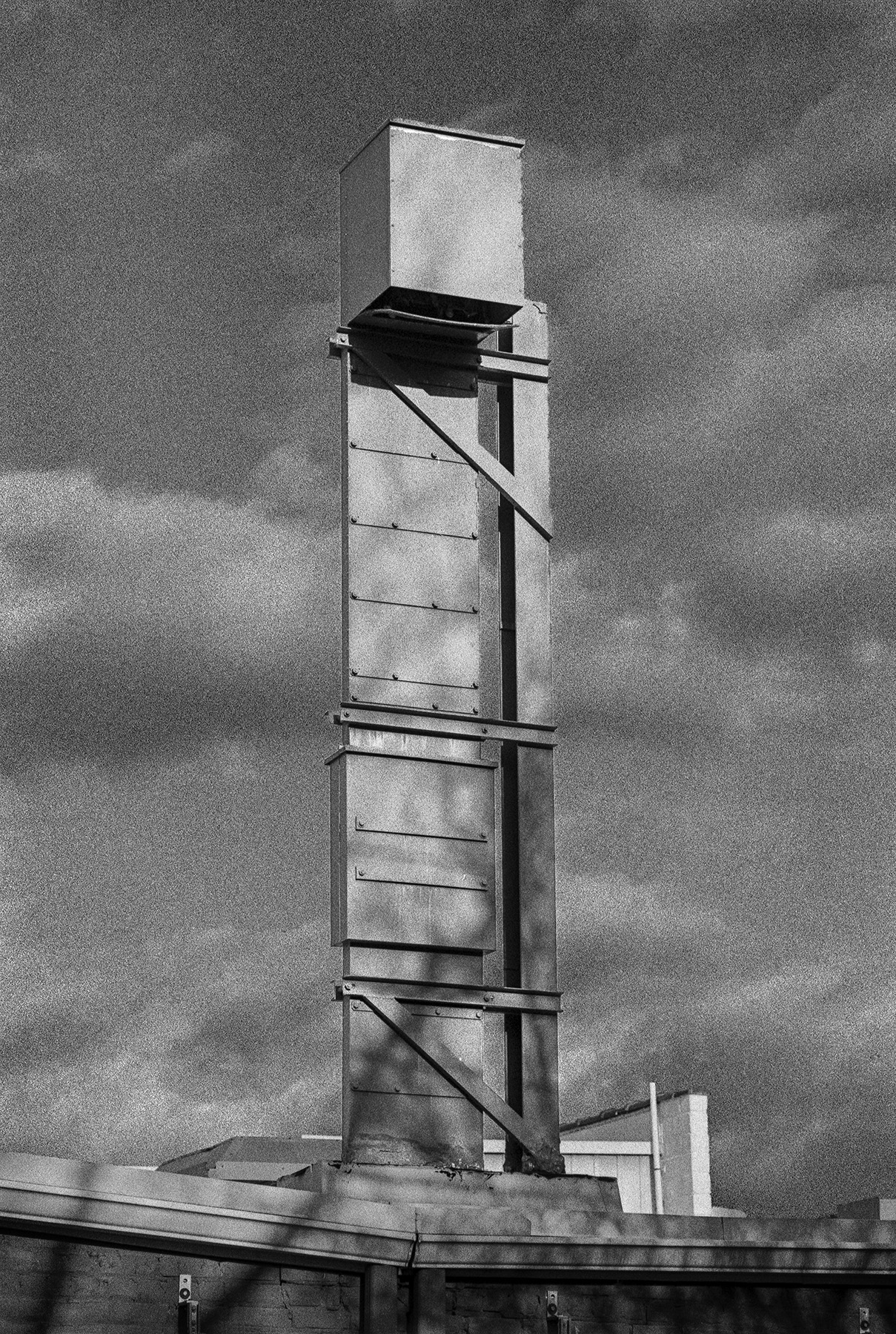

I had a fellow teacher that shot color at high ASA values then developed it hot and scanned it to convert to B/W. Grain was very apparently.
Here is one with regular old HP5+ and Adox Rodinal normal development (that is enough for full dynamic range on a normal scan). However - lighting was late afternoon and soft coming through trees in the alley, so contrast was increased selectively in areas, something like localizing a contrast 4 or 5 paper. The increasing of contrast in the execution of the final print, whether digital or wet process, will articulate grain, in my experience. (I have no idea what that thing is, an industrial area of Richmond, VA.
Edit - also, processing is at 73 degrees F, all solutions and wash tightly controlled within a degree.
What a wonderful effect—looks absolutely beautiful with that subject!

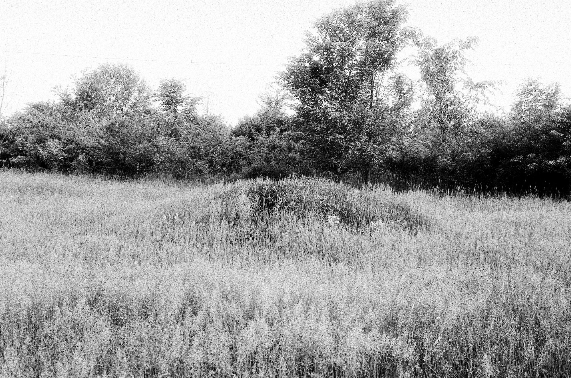

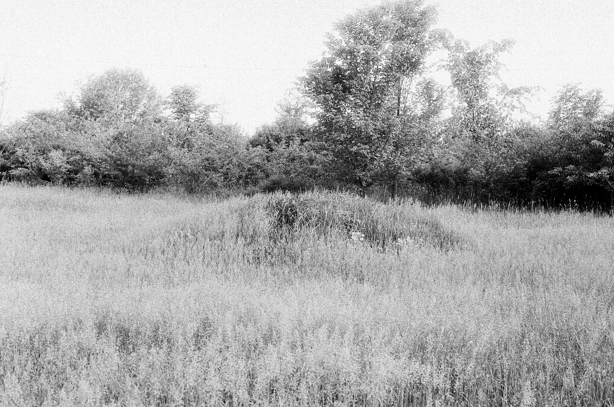

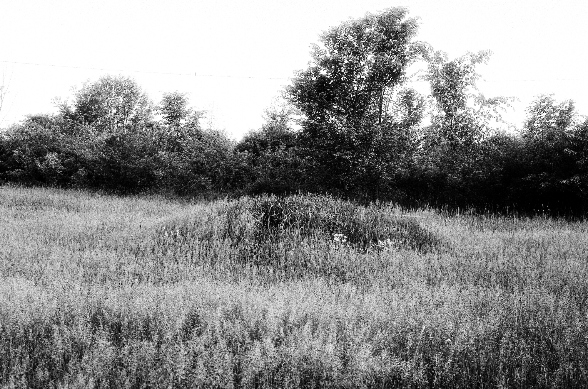

Test one has been completed:
Film Washi F. (also served as a secondary test as I did a bracket test to see how the film would perform from iso 400-100)
here's some raw, uncorrected scans, Rodinal 1:25.
^400
^200
^100

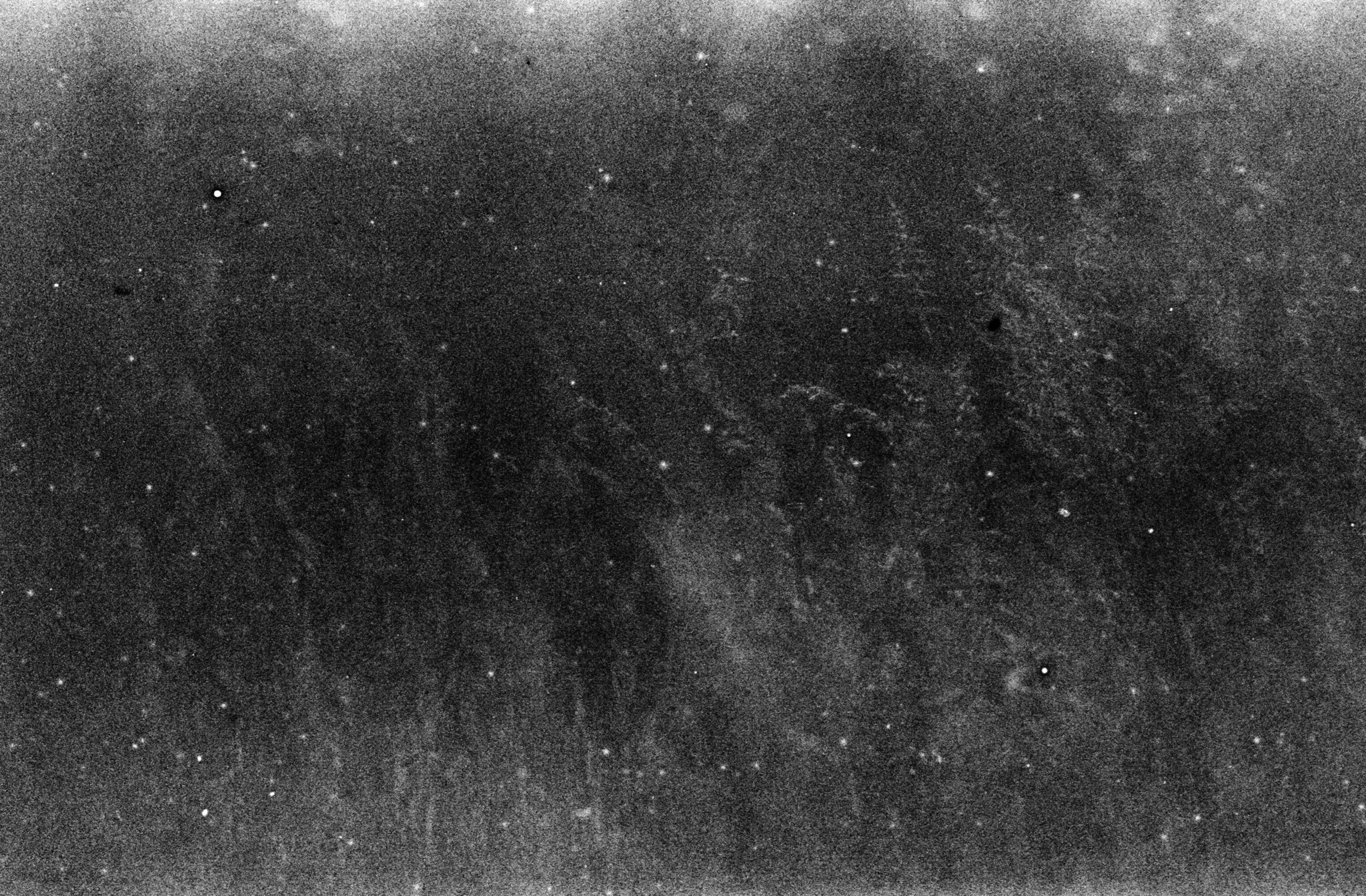

Just for fun, here is Svema 125 expired in 1992, bought from Ukraine on eBay last year, shot @100. The actual film speed now is around 6. The photo is of some grass waving in the wind, but you can barely see this over the character of the expired film.
And here is a tree.
A much less grainy image could be derived by shooting at 6 ISO, though you could probably still see those odd flecks in the emulsion.
^400View attachment 372656
^200View attachment 372657^100

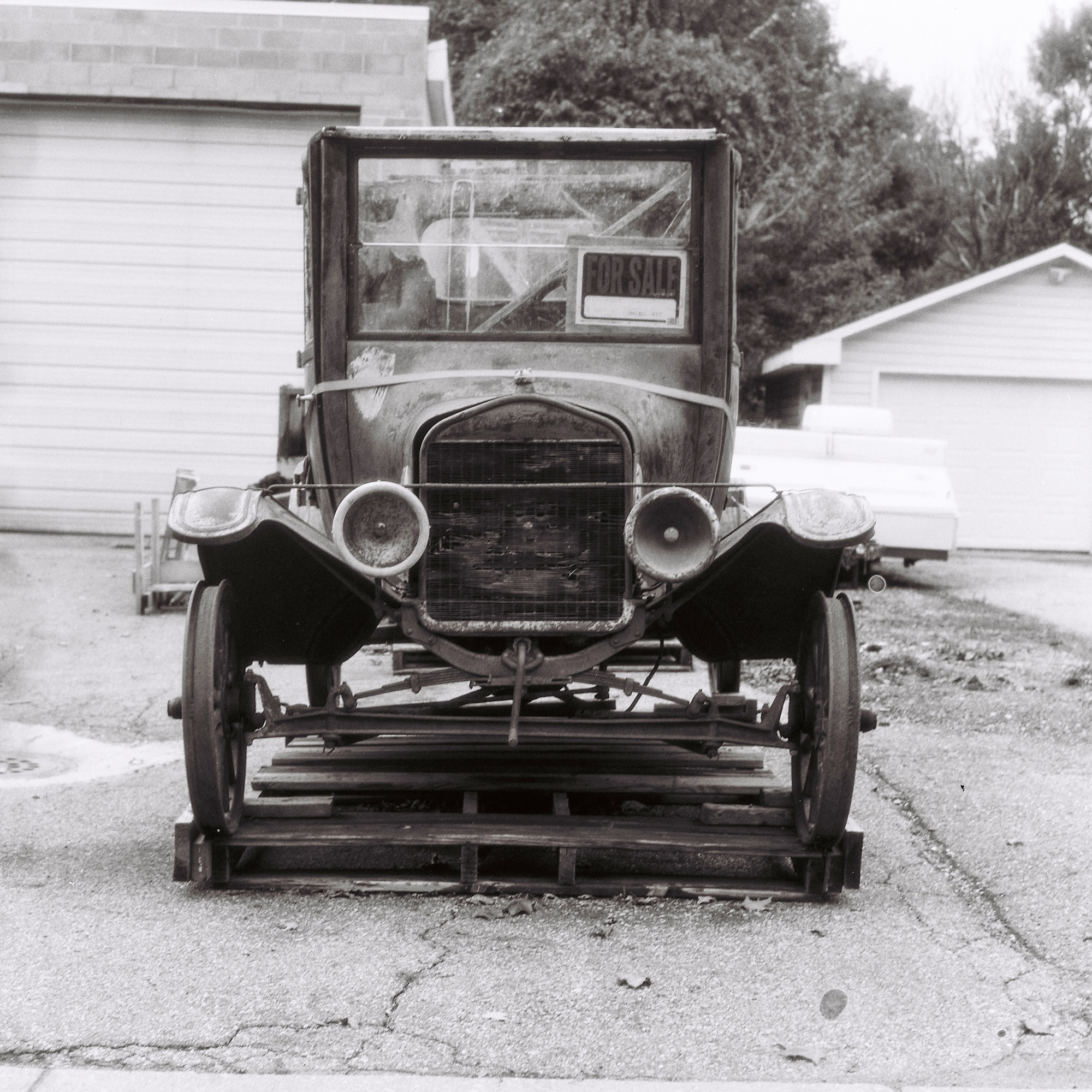

But I will say, I'm almost certain Washi F is really Foma's Xray film, and that said Xray film is also Foma's Ortho film- hence the 400 iso and lack of anti halation. So here's one from my Foma Ortho test roll- developed in Xtol stock
