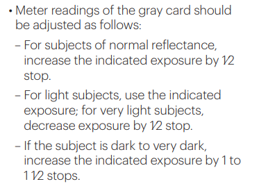

Kodak Gray Card R-27 brochure.
And some directions on use:

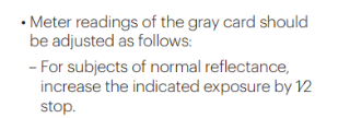

Stephen Benskin
Jan 7, 2005
2,745
Los Angeles
With all the arguing about palms, there's something that went by without notice. Kodak's direction on the use of the gray card. And thanks to @snusmumriken for pointing out that orientation affects the results. Palms also reflect a lot of infrared.
