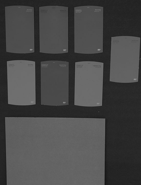

I happened to be in Home Depot and selected twelve swatches that looked like they would be close to my existing gray cards. All were Behr Dynasty Marquee line: dawn gray, imperial gray, dawn, gray, imperial gray, antique tin, ocean swell, euro gray, lengandry gray, and the Ancestral ppi-24-05. I was just doing this out of curiosity to see if any matched the gray cards I have been using for years I thought reading with spot meters under constant illumination at the same angle would be interesting and see if my light meters agreed with each other. And since the original post was looking for a cheap gray card it might be an answer. You might want to do it more scientifically and give us all a better answer
OK, went to Home Depot and found all of the colors, with exception of 'dawn' or 'gray'. Arranged them on a piece of foam core, and photographed them collectively along with a genuine Kodak gray card, under cloudy overcast.
  1. I measured the Kodak gray card as the basis for exposure, then used the Minolta Spotmeter F to see how much tonality deviation from the Kodak card, to determine amount of exposure error if that card was the basis of exposure (rather than the Kodak card).
    An error of -0.5EV means the card is darker than Kodak 18% gray card, and using that as basis of exposure would result in +0.5EV overexposed shot.
  2. I used Lightroom to balance Kodak card to absolute neutral (due to the cool lighting for the photo, which resulted in setting of 5700K as 'neutral'), and the Kodak also served as the Color Temp control patch.
    Then I used each of the Behr cards to determine the Kelvin temp needed to render that card neutral, and recorded the values.
Here are the results of the Behr color samples as surrogates, with deviations shown from the Kodak control patch
Top row
Ancestral: -0.5EV, +150K cool
Antique Tin: -0.7EV, +800K cool
Dawn gray: -0.6EV, +750K cool
Ocean swell: -0.8EV, +1100K cool
Bottom row
Euro gray: -0.1EV, +550K cool
Imperial gray: -0.9EV, +650K cool
Legendary gray: -0.4EV, +850K cool
The best surrogate for exposure was Euro Gray, the best surrogate for neutrality was Ancestral.
Here I show correct WB (1), +150K too cool inducing slight warmth (2) and +1100K too cool inducing considerable warmth (3) caused by choice of the wrong color sample paint choice.

Interesting to render your photo into grayscale, removing the color tints...(which may or may not be helpful)...😆
It is quite interesting when color saturation reduction resolves it all to neutral tonality, the color patch which best matches the Kodak gray card tonality is the Ocean Swell sample, which induces 0.8EV error in metering!
A further step down the rabbit hole would be to get a Zone VI modified meter and take readings of your samples and compare results......😝
