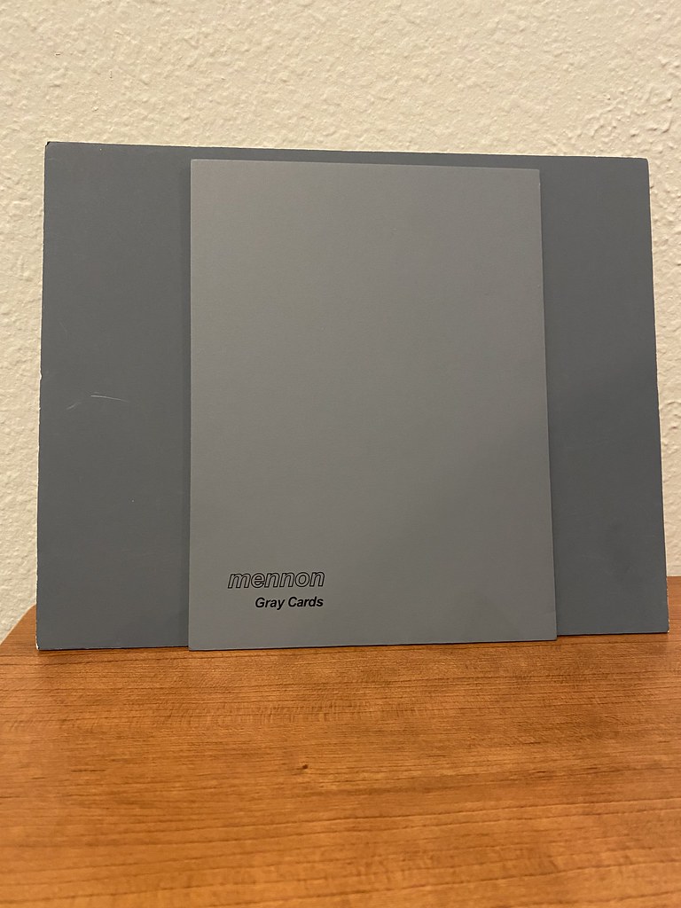

After searching around for a fiber based gray card that didn't cost a fortune, I found these Mennon cards for less than ten USD. Like watches that need to be synchronized or meters that should be adjusted to match, 18% gray seems to be a moving target,
I'll probably stick with the Mennon. They're new, smaller and I only use them occasionally.
Thanks, this has been a very informative thread.
Yeah, gray cards are like watches; but those two examples posted by madNbad seem like an entire time zone or two apart.
The Kodak card is the one against the wall and I’ve owned it for years. The $8.95 Mennon set of two cards, 6”X4” and a 8”X6” arrived today,
