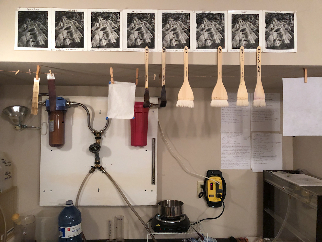

Here are my paper developer test 5x7 prints from a 4x5 negative on MGIV FB at 'normal' contrast and max black time that still live above the sink area. Developers used were Forte, Selector Soft, Zone VI, Ansco 130, Ansco 120, and 12/15, with the last two getting selenium toning tests as well.
Ultimately chose 12/15 which I felt worked best with my images. Hint: warm Glycin is happy Glycin. Have no data to prove this, only experience.
Point being, if you don't test, how will you ever know?
The image can be seen better at the following link from when I had a very short burst of uploading images to the APUG gallery a whopping 19 years ago: https://www.photrio.com/forum/media/users/murrayminchin.4262/
Had never mixed my own developer until challenged to compare Selectol Soft with Ansco 120. Once that hurdle had been jumped, I mixed up some Ansco 130 because it might have been better. No way to know without testing.
Ansco 130 had too much snap/sizzle/contrast, but I'd heard about Glycin's mysterious image and keeping qualities so decided to play around a bit and came up with 12/15.
Worked for me...
