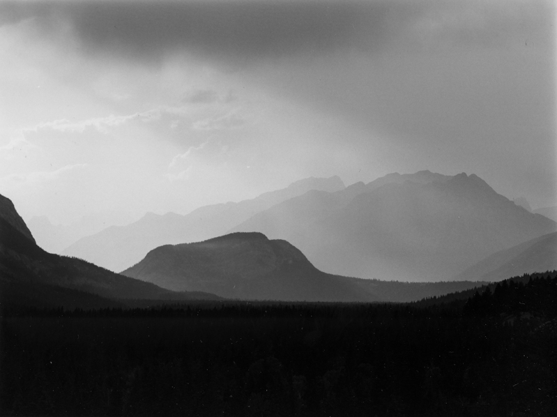

Tonight I mixed up some developer using one of the 130 kits minus Glycin. I mixed DuPont Defender 54D formula, and added 5ml of Benzotriazole to make the tone cooler. All I needed extra from the remains of the 130 kit was a bit of metol and sodium carbonate.
The prints look nice, no greenish cast on Ilford Multigrade IV RC like the Multigrade developer can sometimes give. I have not done any comparison to any other developer, but it gives nice clean blacks. It's a good use of the 130 kits where the glycin has gone bad I think.
Here is a quick and dirty flatbed scan of the print. Obviously the tones are much more subtle on the print.
