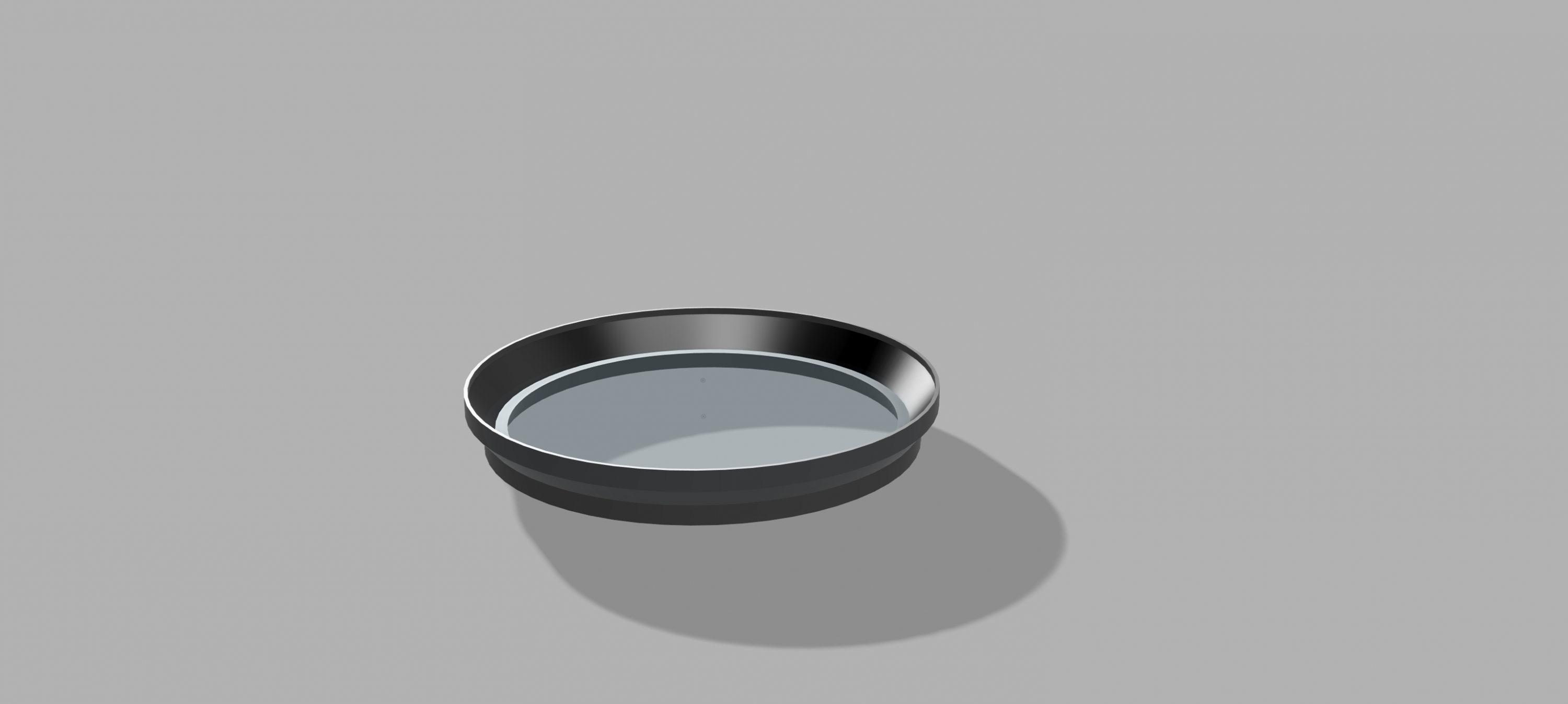

Sorry to reawaken this old thread, but I've got a unicolor film drum II that I'm trying to revive (all the parts broken, ofc). I already made a piston seal model in fusion360 that I'll print in rubber like elastic resin, and now I noticed that the cap died on me as well. Is there any chance OP would be willing to share the STL file they used to print theirs? Happy to share my piston seal STL as well!

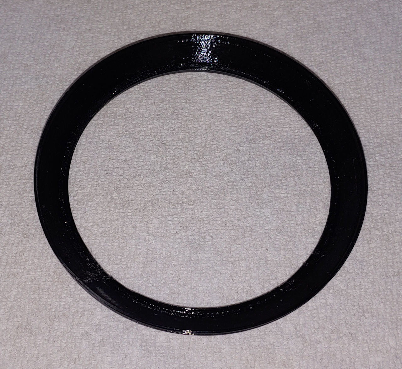

Sure, post your piston seal and I'll give it a try. I have several flexible filaments I can try.
and the STL file is attached
  • Unicolor Film Drum II piston seal v1.zip
I printed one and it was a tad small, does not quite seal. I have a NIB unidrum. I took the seal off and it is about the same size as the drum inner diameter ( slide fit ). Your part seems to be 91.5mm, The drum is closer to 92.5mm. I am printing a new seal at 92.5mm, will let you know how it works out.
92.5 was still too lose. I remeasured and will try 93.6 next
93.75mm seems to work. I printed this one and it's water tight. Will need to run some film and see if it holds. I find that developer and fixer seem to leak more easily than just water.

Can you post a dwg for your seal, I want to pull one of the faces out a bit.
seems like I can't export to DWG since I'm using the free maker's license. I can do f3d smt stp or usdz, lmk what works for you
Can't use any of those. I'll get around to redrawing sometime. As it is the seal works, I did go to a full 94mm.
I wanted to pull out the inner tapered face so that it will push out the sealing ring just a bit more.
Maybe the PDF of the drawing works?
  • piston seal drawing v2.pdf
uops forgot to update to 94mm
  • piston seal drawing v3.pdf
I think that will help me redraw. But it is working well just bump out to 94mm. I did this just doing an X-Y scale, so everything increased in thickness and size a little bit. The seal I'm using is printed with 40D COEX TPE filament.
Hi,
I just processed 2 sheets of 4x5 in the drum using the 3D printed rear seal. It was completely dribble free. The 94mm seal for some reason wanted to resist going in when it was in my film tent, all the other times I tried it, never had an issue. Perhaps just afraid of the dark.
I redrew my cap to get rid of the faceting that was on the original. I printed this version and it is water tight on my drum.
