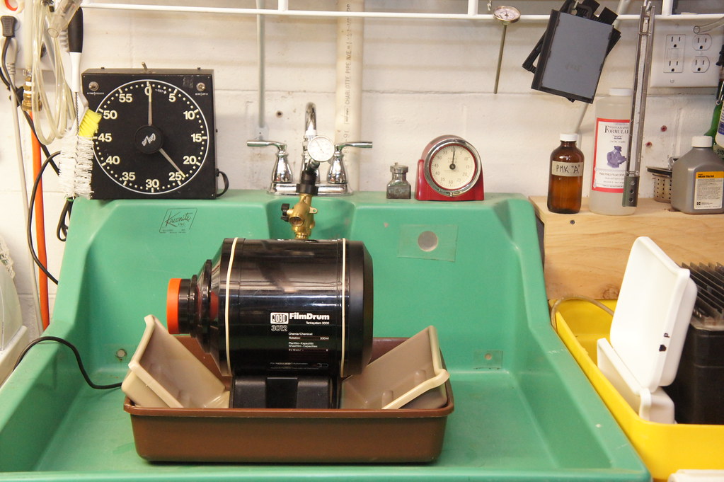

OK I used the Unidrum and Unidrum II for decades to process high quality 4x5 and 8x10 sheet film negatives. I bought a sheet of brake pad material from the local auto parts store, and it only leaked a teeny bit. I use the Unirollers too, I simply put a 5x7 Paterson tray on each side of the Uniroller, which sits in a plastic dishwashing tub. So spillage is OK with me. Last week I received two more black 8x10 Unidrum II"s, I have two I've always been using. BTW you have to have the black rubber "thingee" which always in missing for these. So on the internet I learned to go to Harbor Freight, and bought a single black bungee cord, which can be sliced into the "rubber plug thingee" which separates 4x5 film sheets, and keeps the sheets from riding over each other in the soup. So really I would not use the Unidrums without the "rubber thingee". But I have plenty now including extras. Once Unicolor mailed me extra thingees but they have disappeared over the years. Hurray for Unicolor! Still works good after all these decades. "Poor Man's JOBO". LOL
3012 Metric 9x12cm JOBO Film Drum on Unicolor Uniroller by Nokton48, on Flickr
Uniroller works with JOBO and Paterson tanks too. I've been buying spares for everything

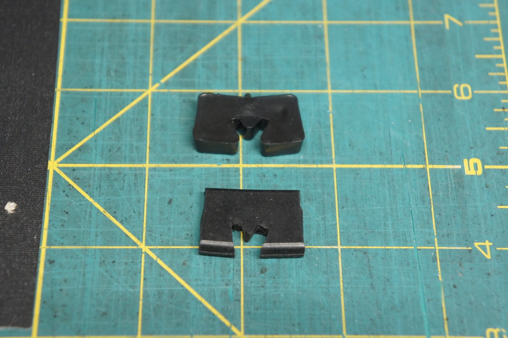

What is this "rubber thingy", --maybe you could post a picture?
The Rubber Thingee by Nokton48, on Flickr
On top is the original Unicolor Unidrum II "Rubber Thingee". One time Unicolor mailed me a few spares in an envelope. Now they are almost always missing. On the bottom, is the "rubber thingee" I made from a chunk of neoprene bungee cord, from Harbour Freight. I cut out the slots with a utility knife. This rubber piece keeps the 4x5 films seperated from each other during development. Otherwise these will "walk over" each other and will be ruined
