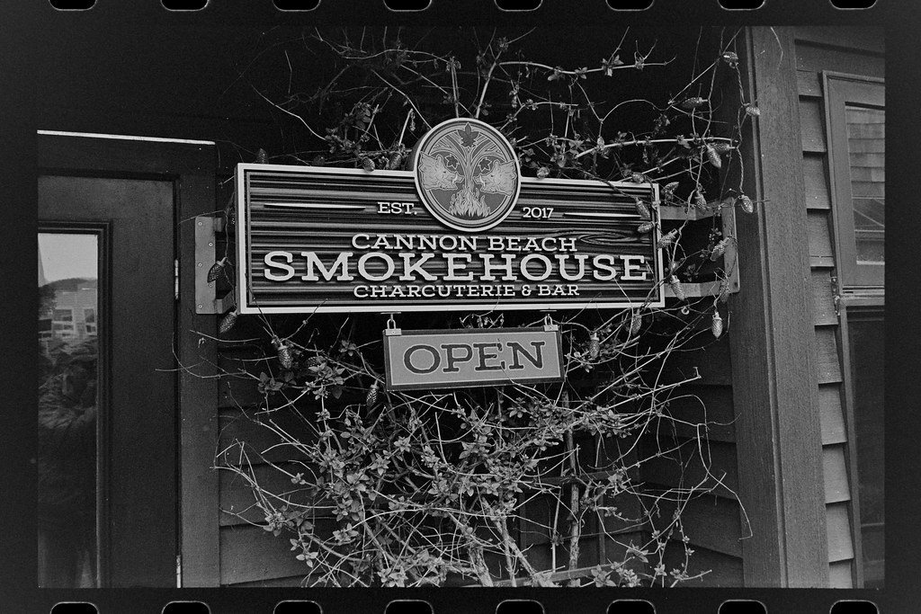

MadNbad, here's a question I don't think I asked originally: On your #84 what is the colour of the walker and arrow in pic 2 Both look black to me but being unfamiliar with U.S. road sign colours I thought I'd ask
Thanks
pentaxuser
The background is a medium brown, a light earth color not as dark as mulch and the pictogram is white but often greenish from a light coating of moss.

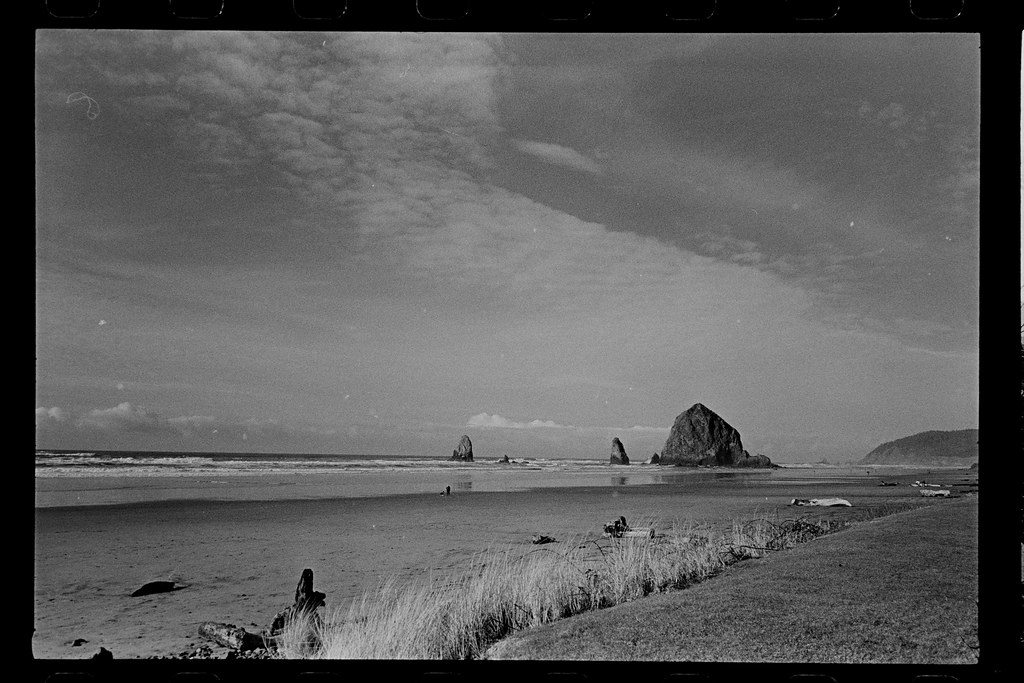

Leica M4, Voigtlander Nokton Classic 35 1.4 SC V2, 010 filter, Tri-X @ ISO 200, Rodinal 1:50:

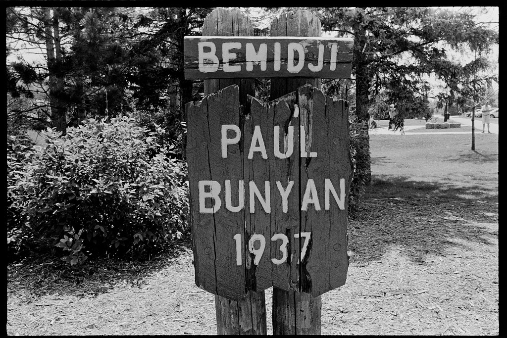

My wife and I took a road trip from Oregon to Pennsylvania in June. We spent a week visiting family that hadn't all been together in a decade. It was more of a dash than a real road trip, 6500 miles, nineteen days driving and on road for twenty five days, I brought the M4-2 with a 35 1.4 Nokton Classic SC V2 and a bunch of Tri-X. As it turned out, I took surprisingly few photos. Here are a few:

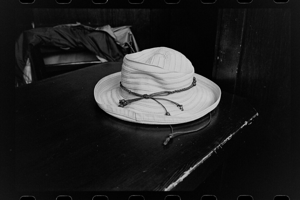

M4-2, Voigtlander 35 1.4 Nokton Classic SC V2, Tri-X @ IO 200, Rodinal 50:1 20C 10 minutes
