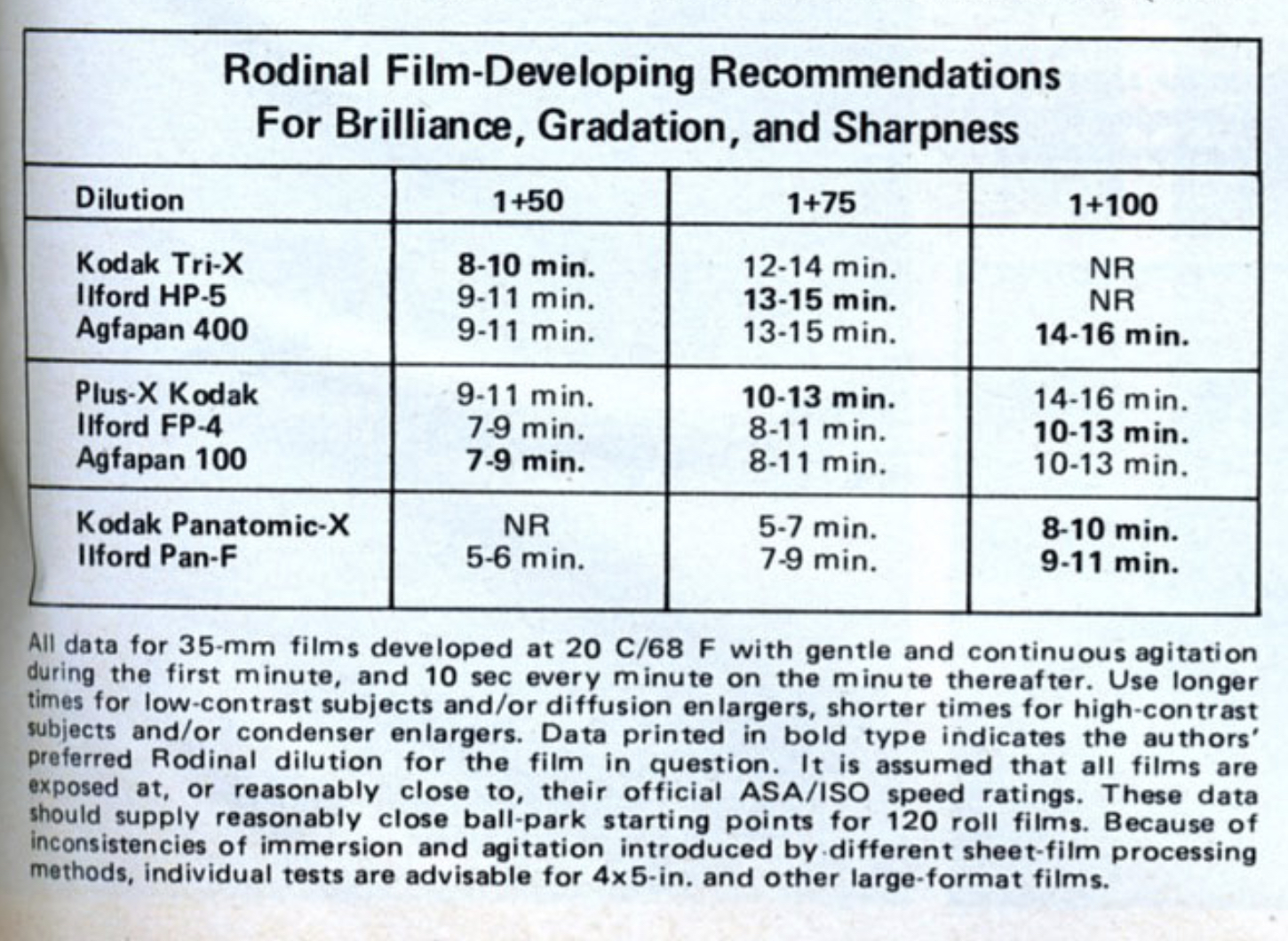

Even though the films aren't quite the same as they were back then, I find the times in Bob Schwalberg's famous Rodinal article good starting points.

You'll find the whole Popular Photography 1979 article here:
I found the times for FP4+ at 1:75 a tad under what I liked, so I added a little. Did not try Tri-X at these times.

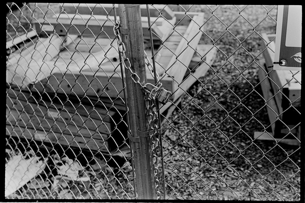

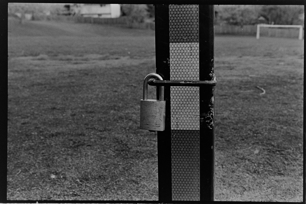

First of all, thanks to everyone for the advice. Put the 50 1.5 Nokton on the M4 and used the 398 to meter. Wandered up to the park and exposed two rolls of Tri-X on various mundane objects, street signs, tree moss, shrubbery, ect. Mixed a fresh bath of Ilford Rapid Fix and developed the rolls in Rodinal at 1:50 for about nine minutes. Set the timer for eight and a half minutes, filled the tank, gave it six gentle agitations then started the timer. One inversion every minute after that. Stop, fix, modified Ilford wash and Photoflo. They're hanging to dry and the very first thing I noticed, they look good. Not nearly as dense as yesterdays batch, a little thin in the shadows but I have to wait till tomorrow to scan. One of the things I love most is no matter how long you have been involved in photography, there's always something new to learn.

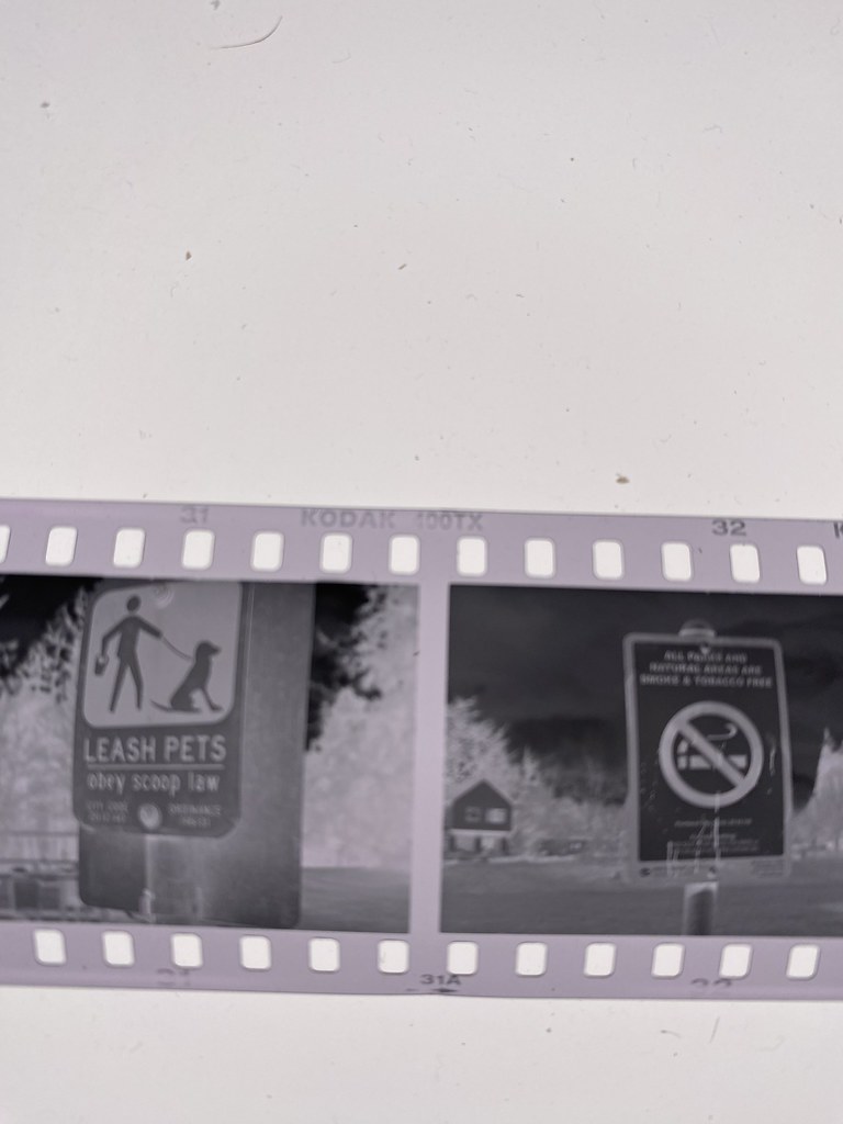

The camera is tethered to the computer and the image is viewed in the Sony Remote app. The captures are imported to Apple Photos and the RAW Power plug in is used for the conversion. I give the capture a +1.7 EV and except for very minor adjustments to exposure or contrast, I pretty much leave it alone.

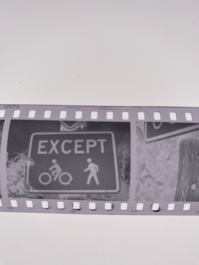

Those are nice, under-exposed (I think) images :smile:.
May we see the negatives?
MattKing
Apr 24, 2005
55,061
Delta, BC Canada
Now I'm unsure :smile:
The edge printing - an unreliable indicator - makes me think that those negatives are under-developed.

That's a start. If 13 minutes is too much and a little less than 9 is not enough, I'll try 10 or 10 1/2 minutes for the next rolls. After years of being pretty much dialed in with TMax and HC-110, this is actually somewhat fun or at least making my brain work. Thanks for the help!

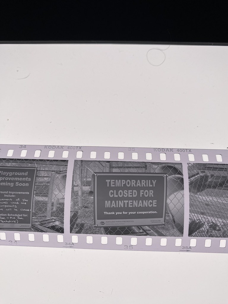

@madNbad those are getting better in terms of development. Couple of comments
  1. The light conditions are different in these latest samples - they differ somewhat from those in your first batch (the one developed at 13'). These recent ones seem to have been taken during lightly overcast conditions. I would have increased development a little from 9'
  2. Most of these are underexposed. Are you still using a yellow filter? If so, did you dial in 1 stop for the filter and 1 additional stop to account for Rodinal speed loss? Dial in 100 if using your rangefinder's internal meter and try again (I'm assuming it's not a TTL meter?). Also make sure your meter is not tricked by those bright milky skies. Point the camera at the ground level features, expose, recompose.
  3. If possible, ditch the filter for these tests, a variable less and you gain a stop. Tonally a yellow filter won't do much (imho) in these light conditions
  4. The first negative you posted is actually probably fine if scanning is the purpose ('Temporarily Closed ...') the other ones are underexposed
  5. There seems to be some un-evenness in development. Try inverting (gently) for the entirety of the 1st minute, or at least for 30 or 40 seconds. Then 1 inversion per minute.

I use either a Sekonic 398 incident meter or a Gossen Digisix with the incident dome in place. The meters are dialed to ISO 200 to compensate for the filter factor. I have been developing the film according to the time recommended for box speed (ISO 400). We have a small house with no practical place for a traditional darkroom or even a room I could make light tight so I use a Photoflex Popup dark tent and my developing is at the kitchen sink. I came back to home developing several years ago after disappointing results from the local lab. It was mostly TMax 400 in HC-110. I became intrigued by the concept of using both an older formula film and developer combination which is what has led to this point. There is a lot of conflicting information too. Some say hardly any agitation but your suggestion makes more sense. When I started this thread was to learn and how to achieve consistent results. With all of the input so far, I think it’s getting closer. As for overcast conditions, this is the Pacific Northwest, natures gray card. Thanks for the help, I’ll try your suggestions, check back later.
