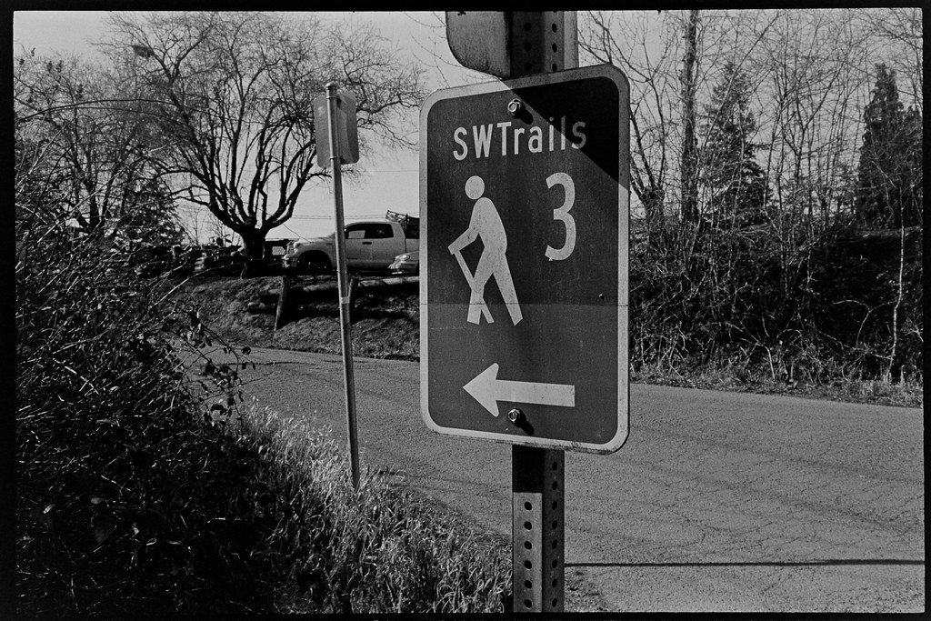

madNbad, your most recent set of pics look pretty good to me. I especially liked the one with SWTrails that had me on it with a walking stick😁
If you fine-tune the times again I'd be interested in seeing what the improvements are

We live at the western edge of the Portland city limits and the trail system has been built by volunteers. Down the hill from that sign is a path that leads through a wooded marshland. Occasionally, it’s hard to believe we’re only a fifteen minute drive to downtown.
This adventure with Rodinal has been quite the learning experience!

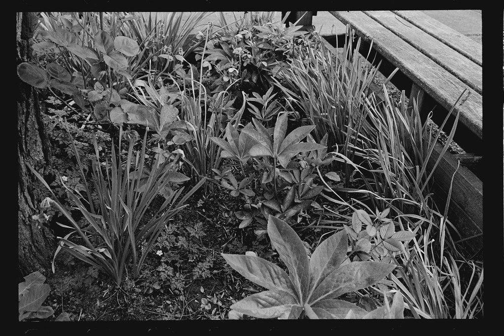

Swapped out the yellow filters with UV. Set the Sekonic 398 to ISO 200 to compensate for the Rodinal. Was going to wander out but so far today we had snow showers, rain, blinding sunshine and it all seems to change just about the time I’m ready to head out.
Once again, thanks for all the advice. Made a few small changes, switched to just a UV filter but continued to meter at ISO 200 to compensate for the Rodinal, changed the developing time to ten minutes, developer mixed 50:1 at 20C, continuous gentle agitation for the first minute, three inversions every following minute, Foma stop for thirty seconds, Ilford Rapid Fix for seven minutes. Edges are clear, and the markings are easily read. This seems to be heading in the right direction!

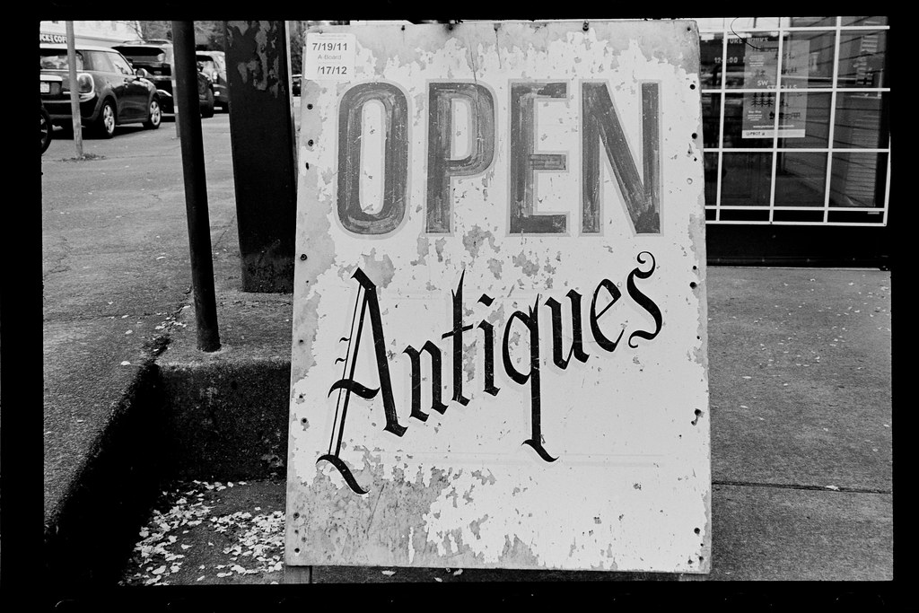

As an aside, when I was metering the Antiques sign, a young man was walking past and apologized if he had interrupted my metering. He mentioned I might want to step into the shop and check out a 4X5 kit they had for sale. Itt was a very complete kit, then he pointed out it was a Sears Tower.
Isn’t a Sears Tower 4X5 a re-branded Busch pressman?

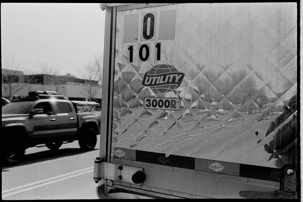

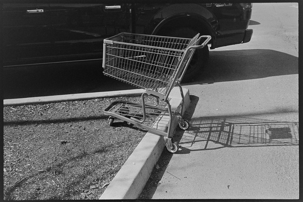

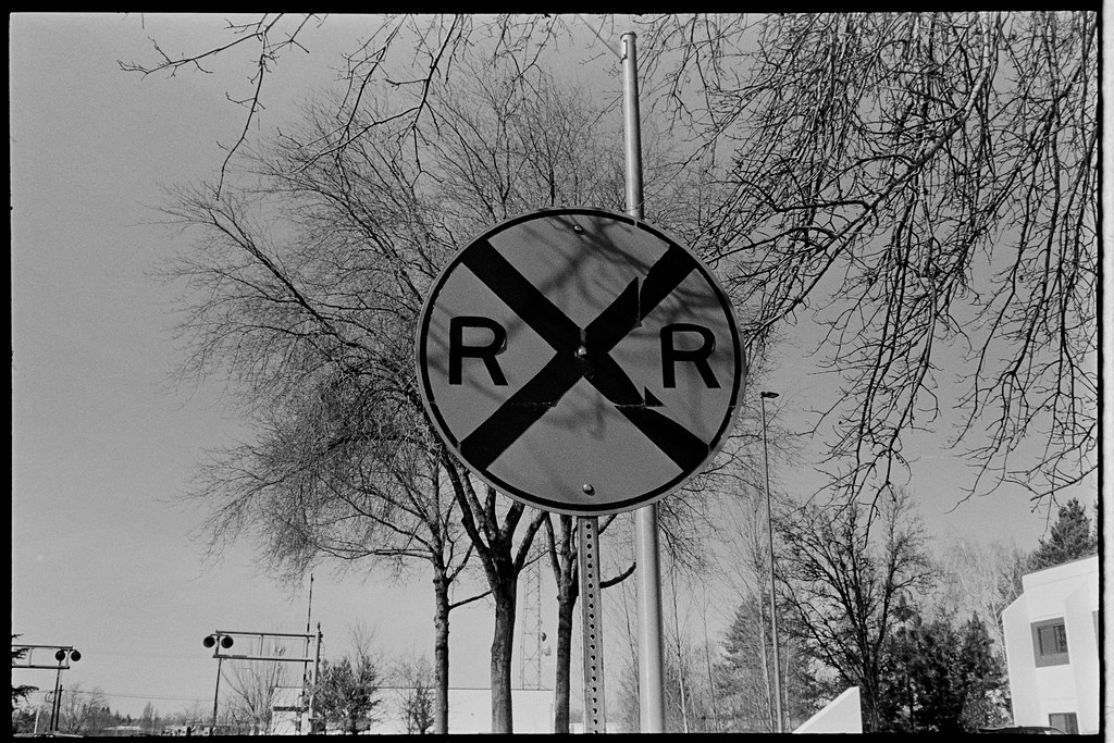

Starting to get comfortable with Tri-X and Rodinal @ 1:50:
I have seldom seen such nice results with TriX/Rodinal, especially qua grain. It seems to me the 200 ISO plays the most important role there

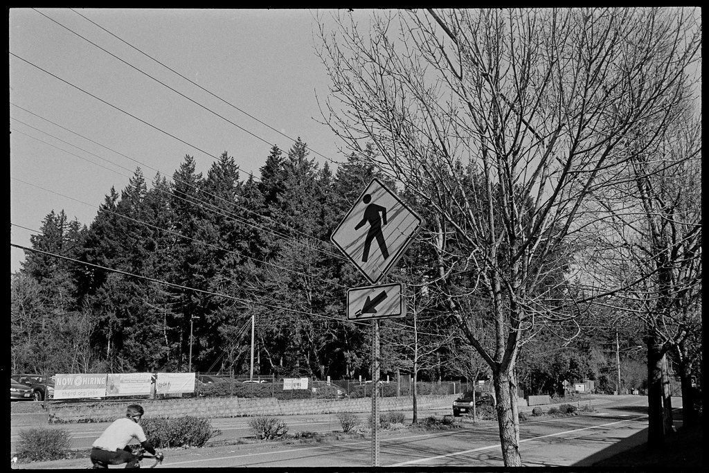

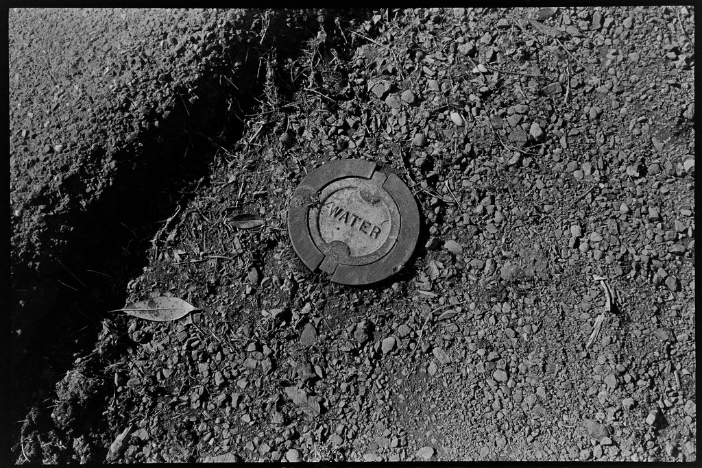

MadNbad, here's a question I don't think I asked originally: On your #84 what is the colour of the walker and arrow in pic 2 Both look black to me but being unfamiliar with U.S. road sign colours I thought I'd ask
Thanks
