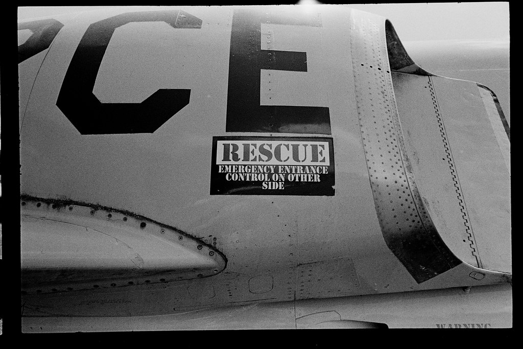

Yeah, I could just put in a search and get about a billion responses but I wanted to ask the forum members if they have a preferred dilution and time. For Tri-X I’ve been using HC-110 Dilution E (1:47) and it works well. I do have a small bottle of Rollei One Shot R09 that I use at 1:25 for seven minutes per the bottle instructions. I haven’t tried the 1:50 for fourteen minutes yet and I know D76 or Xtyol are preferred but I’m not interested in having a gallon of developer sitting around for my single reel 250 ML tank. The R09 gives a bit different look than the HC-110 and am on the wait list for Adox Rodinal. The one time developers work for me, having a small house and only exposing a few rolls a month. I’m more interested in a negative that scans well, since with no darkroom, printing isn’t a priority. Any suggestions are always appreciated.
Tri-X in Rodinal is a fabulous combination. I now shoot it at 400 and develop with (1+50) for 13 minutes at 68º F.
The big issue with Rodinal, particularly at (1+50), is agitation. When I switched from the usually recommended 30 seconds continuous plus four inversions at one minute intervals regimen to just four very gentle inversions to start and just one very gentle inversion at one minute intervals the apparent grain was reduced and the impression of edge sharpness was increased.
1:50 works well for me too. The op didn't mention whether they were shooting 35mm, MF or LF, so this 1:50 is my dilution for 35mm. That could be changed a lot for 120, it really depends on the look you want. I usually do 1 inversion every minute, you can do 1 every 30 seconds and pump up the grain a lot.
