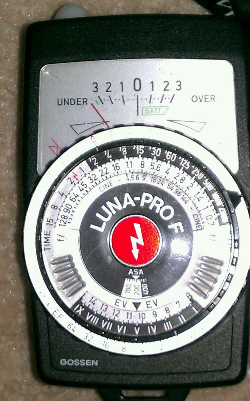

My Luna Pro does have a Zone scale, but alas, doesn't have 1-degree metering.
It also takes the Profi-Spot attachment, which will give you 10º - 5º - 1º metering capability and built in dioptre correction. Mine works a treat.
did you compare for one EV measured with a 1° pentax, what combinations does the Pentax show with the luna?
I did the comparison for IE 100 and the Grossen, it has one stop difference.
Going very slightly off topic, combine the Profi-Spot attachment and the Profi-Flex attachment, I have the possibility to have various narrow metering capabilities, as well as off the ground glass for what is effectively TTL metering on my view cameras.
The 7.5º and 15º attachment is not bad, but compared to the 10º - 5º - 1º attachment, not in the same league. I have both of these attachments, both have their plusses and minuses.

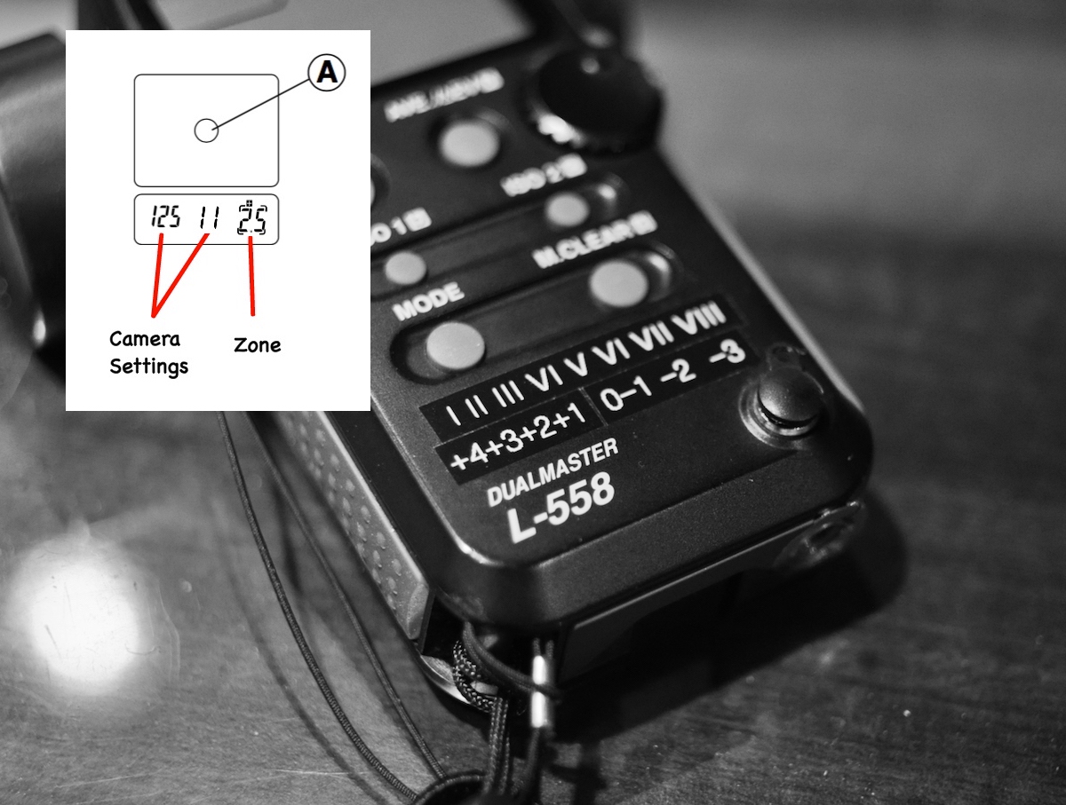

I find it mind boggling that Sekonic has been making some of the finest 1-degree spot meters since the 1980s (and even the newest model that just was released, the L-858 @ $600 USD) provide no easy way to "Zone Meter."
Like... what??? What did they think you were going to do with the spot meter?? Average a bunch of numbers into the same reading you would get had they given you a 10 degree view meter (like my old 206??).
Anyway, I have a L-558 on the way and the reason I got it, even though it has no 'Zone Meter' capacity is that there is a workaround that I'm going to use.
It is simply the mater of re-naming the zones and using the meters jog wheel to set "Filter Factors" that will be surrogates for the metered zones.
My new zones as follows
Zone 0 becomes Zone +5
Zone 1 becomes Zone +4
Zone 2 becomes Zone +3 (onset of texture)
Zone 3 becomes Zone +2
Zone 4 becomes Zone +1
Zone 5 becomes Zone 0 (middle gray)
Zone 6 becomes Zone -1 (skin)
Zone 7 becomes Zone -2
Zone 8 becomes Zone -3 (highlight)
