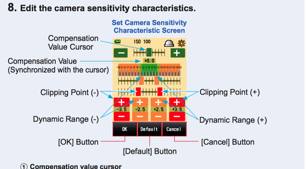

This is from the L 858 manual. Looks like just what I wanted. A Zone indicator (red/green band indicator). But, I still can't tell from the manual if I can input my own film H&D curve values or if the software only accepts digital sensor 8bit output to create the curve. If it only accepts Y-axis values to 256, it won't be hard to scale any of my H&D curves to fit that. I just need to figure out if the Sekonic software lets me enter my own values. The meter itself, apparently, does not let one enter the values to make the curve.

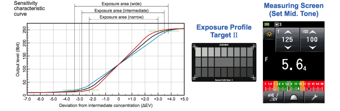

The L858 will accept H&D film curve values and display and correlate a high, middle and low zone as you spot meter. . According to the manual, you can enter them right into the meter, without the "profiling software." Assuming one already had the H&D curves.

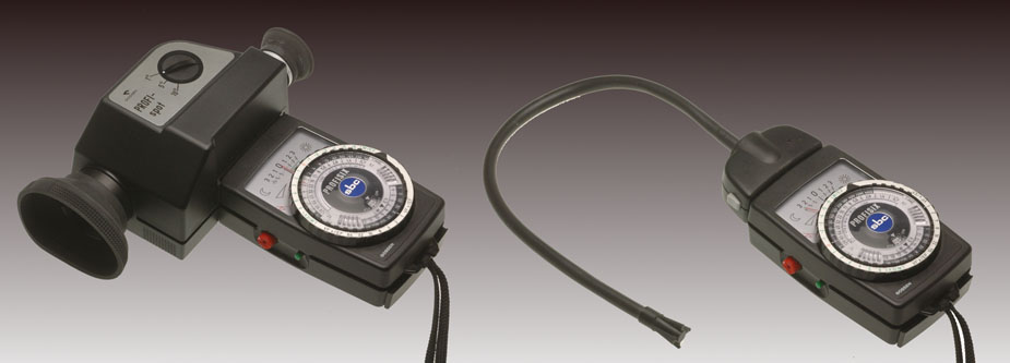

It also takes the Profi-Spot attachment, which will give you 10º - 5º - 1º metering capability and built in dioptre correction. Mine works a treat.
Going very slightly off topic, combine the Profi-Spot attachment and the Profi-Flex attachment, I have the possibility to have various narrow metering capabilities, as well as off the ground glass for what is effectively TTL metering on my view cameras.
The 7.5º and 15º attachment is not bad, but compared to the 10º - 5º - 1º attachment, not in the same league. I have both of these attachments, both have their plusses and minuses.
Mick.
I also use the Profi-Spot and 7/15 adapters on a couple of SBCs. The spot attachment works very well, find the dark shadow and meter, adjust the dial to -3, set the exposure, find the highlight and how far it is from +3 determines development. Only downside is the size of the assembly. I'm sure internal baffling could be improved, but I have not seen it as an issue with my photography.
The SBC is really a versatile meter, alone and with the attachments.

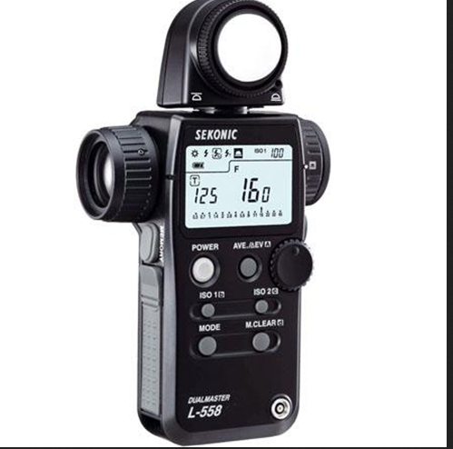

I ordered a New-in-Box Sekonic L-558 and I'm going to use the meter's 'filter-factor' Jog Wheel to base my film exposure on the low scene values.
Basing B&W negative film exposure on low values is called "Zone Metering" in my nomenclature and has been confused here with "THE ZONE SYSTEM." Basing B&W negative film exposure on low values is the ASA and ISO standard of film speed determination. Sorry for the confusion and mentioning the word "Zone."
Sekonic L-206
Seconic L-558
