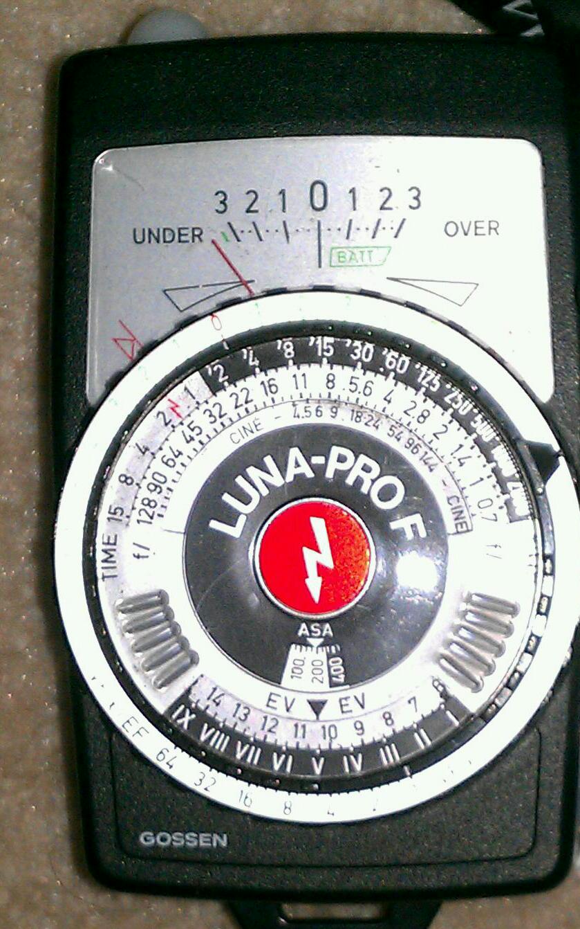

My Luna Pro does have a Zone scale, but alas, doesn't have 1-degree metering.

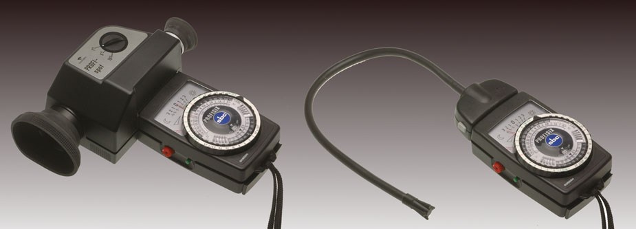

I use a Gossen Luna Pro SBC which has filter compensation and a Zone System scale. It also takes a 15 degree and 7.5 degree spot meter. It works to very low light levels.
It also takes the Profi-Spot attachment, which will give you 10º - 5º - 1º metering capability and built in dioptre correction. Mine works a treat.
Going very slightly off topic, combine the Profi-Spot attachment and the Profi-Flex attachment, I have the possibility to have various narrow metering capabilities, as well as off the ground glass for what is effectively TTL metering on my view cameras.
The 7.5º and 15º attachment is not bad, but compared to the 10º - 5º - 1º attachment, not in the same league. I have both of these attachments, both have their plusses and minuses.

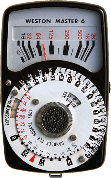

I have a Weston Ranger 9 with a factory zone scale, and a Soilgar with a paste one scale, don't recall where I got the zone scale, In the 60s I used the Ranger 9 when I took Minor White's summer class, by that time he was using a Pentax meter with a factory scale. But has other say, no real reason for a scale, easy to figure once you know zone V.
