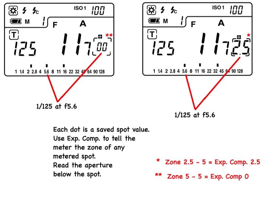

I got the meter today and, as I expected, you cannot really figure out exactly how the buttons alter the display from the verbal descriptions in the manual.
With the meter in my hand I was able to figure out how it can show the proper spot reflected-light reading to expose B&W negative film for large format photography.
First I put it into some mode where I can see the analog aperture scale at the bottom. That is what I will use to read the camera settings. (With Time on the bottom, in LF photography, the correct time could scroll off the scale (below 4 sec) and you won't be able to read the correct exposure with this method)
In the reflected spot mode, find the darkest areas of the scene with the viewfinder circle. Since our eye can be fooled, I choose a number potential candidate values and record them to memory. For fun you can also spot and save some high values too.
Each value shows as a dot on the aperture scale at the bottom.
The correct film exposure for the scene will be BASED on the DOT FARTHEST TO THE LEFT on the analog aperture scale at the bottom. However, you still cannot read the exposure because the meter thought that dot represented a middle gray value. You have to tell the meter you want that dot to represent the shadow.
For me I like using the EXPOSURE COMP because it clearly shows the zone you will be basing exposure on. After testing the meter it seems the spot is still too big to really get a very low value. My testing shows that for a typical outdoor scene (rocks, water, trees, etc) that I favor, an EV value of +3.0 tells the meter the dot farthest to the left is the correct exposure. It can be called Zone II or just +3.0 COMP. The good thing about using EXPOSURE COMP is that it shows in both the viewfinder and the main screen in pretty big numbers. So you won't forget you are spot metering based on the lowest value. You need to set it back to 0 for incident.
Just to review.
1) Calibrate you meter ISO setting and EXPOSURE COMP so that the lowest values of you typical scenes JUST have density in the negatives based on the lowest spot reading in the scene. You can set it any way you want. That is, you can set box speed and the appropriate EXPOSURE COMP, or an EXPOSURE COM of zero and a special exposure index ISO. There will be a thousand different ways to do this. Check your work, repeat the test if needed and don't make a mistake.
2) To Use the meter: Spot and save a bunch of low values from your scene. Each reading will show as a dot on the analog aperture scale at the bottom.
3) Set the camera shutter based on the shutter speed indicated on the digital display.
4) Set the aperture on the camera to the aperture indicated by the dot most to the LEFT of the group of dots. That is your lowest scene value, weather you eye detected that as lowest or not. The dots on the right are highlights if you saved any. Their distance from the left-most dot is the SBR if you need to record that.
You can use the filter factor function, instead of EXPOSURE COMP, like I thought in post #1, but you need to keep your finger on the button. I did not like that. Also, if the JOG wheel is tied up setting the fiter factor, you can't move your exposure value dots right or left on the analog aperture while in the ISO 2 mode.
Just to review.

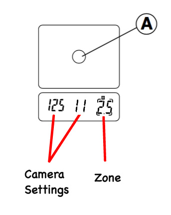

Now that I have had a few days to use the Sekonic L-558, I can give a review.
1) It seem smaller than I imagined. This is due to its light weight. This is a positive.
2) I'm used to a lot of equipment doing something when a button is pressed. But the Sekonic freezes the value when you RELEASE the button. I need to get in the habit of releasing the button carefully, otherwise the metering circle jerks away from the target. It is also a little odd to use the thumb rather than index finger to take the reading (I see you can swap the button function on the newer meters to address this).
3) Oddball Exposure Compensation value sign convention. A more POSITIVE value of this number causes the meter to display camera settings that would give LESS exposure to the film. The meters of most cameras with which I am familiar give MORE exposure to the film when the Exposure Compensation is (+).
Maybe Sekonic wanted the Exposure Compensation to match the FILTER FACTOR function behavior. In the FILTER FACTOR function the number represents a filter factor where a POSITIVE filter factor does give LESS exposure to the film.
ic-racer
ic-racer
Feb 25, 2007
16,802
USA
The spotmeter viewfinder displays the camera settings for the selected metering zone.

What are you doing!?
Baseline calibration of the meter, shifting its value away from a calibrated mid-line either up or down [+/-0.0] (ISO1 + ISO2) is not the same as filter factor (ISO2 [+/- 0.0], applied after metering, and is a known and precise value (not a guess) of whatever filter you are using e.g. for a C-POL, typically between +1.5 and +2.0, but smaller increments are often a better ideal based on experience).
Calibration value for the meter is not changed. The system (camera, film meter, enlarger type, etc.) needs to be 'calibrated' to one's working style, as any meter or camera. That is the use of 'calibration' in my text.
Are you basing your ZS assumptions on baseline calibration of the L558 or by filter factor (which would be invoked by pressing ISO2 after averaging the meter)?
Calibration value for the meter is not changed. Averaging function not used (ignore the "A" in the diagrams). ISO2 not used (original post was before I had the meter).
You may be new to the Sekonic way of doing things, but the way these meters behave and their customisations and degree of accuracy is based on a lot of feedback over a long period of time from many, many professional users; that includes the metering standard being 12.6% incident and 16.2% reflected spot (two separate, unrelated metering systems) and either auto or manual switching of the metering buttons (among many other things, including how readings are averaged that can have a bearing on the outcome in critical situations).
Sekonic user since 1975. Incident metering not mentioned in this thread. Not using gray card.
Ta-da! 'To mimic...' might be another description. But remember that exposure compensation (or, shifting the mid-tone or averaged whole reading left or right to 'fit') and/versus filter factor are two different functions that affect the meter independently. Read the instructions that came with the meter.
Exposure compensation and filter factor alter the indicated camera settings in exactly the same way on my meter.
