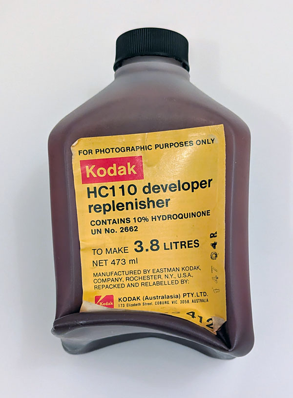

the dedicated replenisher.
You reminded me, I have some 🙂
Has a little bit remaining. I used it direct (diluted) and it worked fine. Can't remember last time but maybe a couple of years ago. Might throw some old film at it for science and a laugh!
Whilst digging that out, I found this...
Now this is old! Looks to be enough for a few films @ 1:100. Another experiment not worth doing but I will!
