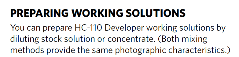

Manufacturers of the viscous varients recommend mixing the whole bottle to a 1+3 stock solution when the bottle is opened
yes? no?
You can. Not you must 🙂.
Essentially, making a 1+3 solution is to make it easier to measure the working solution and avoid having to use a syringe.

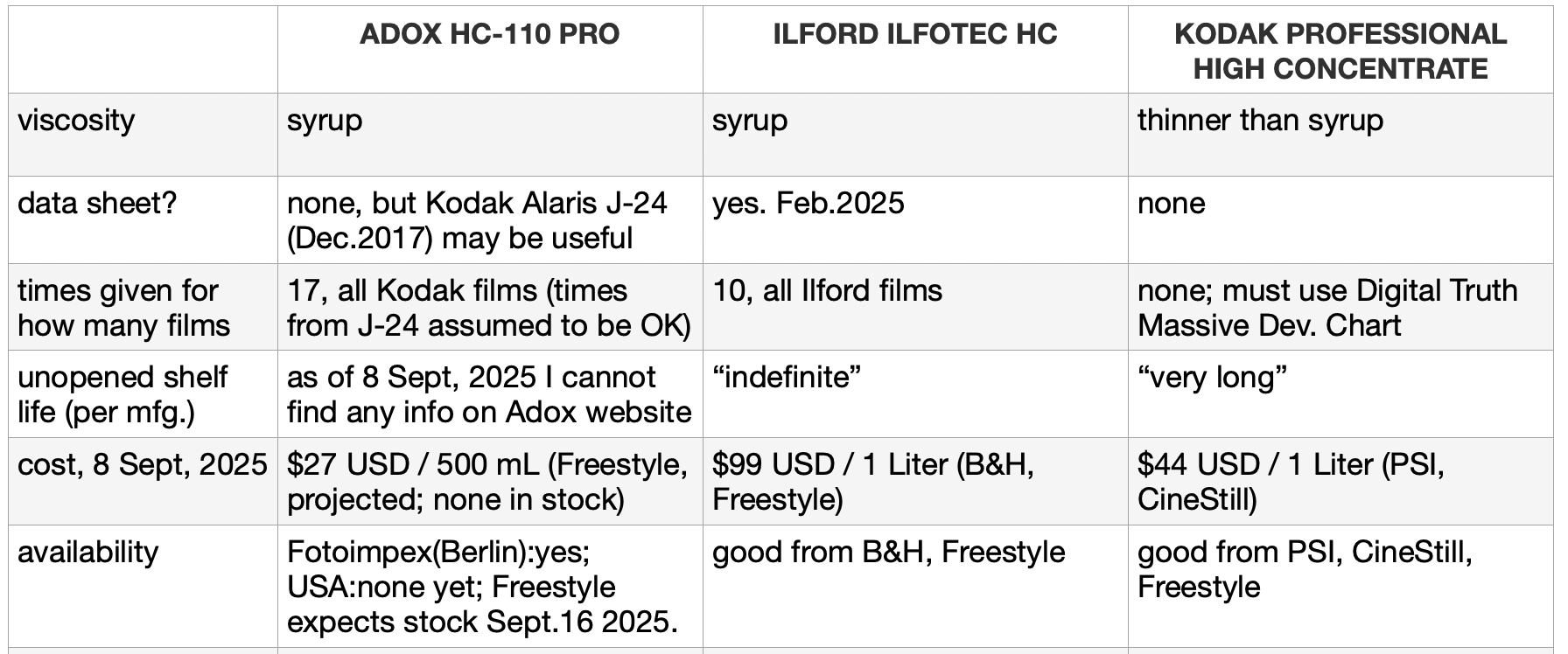

I made this little table comparing three of the HC-110 varients. I know there are others, but these are the three I would be considering. BTW I think B&H might still have some of the syrupy Kodak HC-110 from 2019 available? But my table includes only the current, thinner version from PSI (Photo Systems, Inc).

I could not find any downloadable PDF data sheet documents for ADOX HC-110 or Kodak Professional High Concentrate. However, I'm sure those products come with some kind of instructions and (hopefully) some recommended times for some selected films. If anyone knows where the maufacturer's product instructions can be viewed online, I would love to look at them.
Only information available regarding development times for Adox HC-110 Professional is on the bottle.
