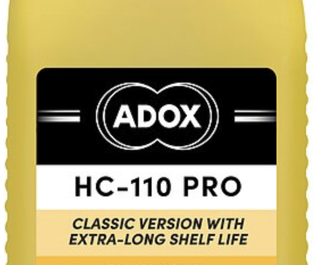

... but when I go to the Freestyle website, I find a product with this label:
(Freestyle shows this product as, "not in stock - due September 16, 2025")
So my first question is this: Is "Adox HC-110 Pro" the same exact product as "Adox Syrup 110" -- or not?
The claim of "Extra-long shelf life" is one of the things that make me want to try some version of HC-110 developer. But what does that really mean?
So far, I have not been able to find a data sheet for HC-110 Pro from Adox. Their English website which shows the "ADOX FILM DEVELOPERS" does not even mention a "110" developer. And I cannot find a data sheet from either Fotoimpex or Freestyle. The description from Fotoimpex says it has "a basically infinite shelf life" -- which I assume is for the unopened bottle. But I am particularly interested in the working life for the stock solution (1+3) in full air-tight bottles.
Has anyone seen any official document from Adox that quotes any actual numbers for shelf life, especially once made into the stock solution?

Your pictures make me think their legal team recommended they drop the HC-110 name.
If you look here under downloads for MSDS Adox syrup 110 film developer it brings up the data for the Pro version:
This suggests that Syrup and Pro are identical.
Also it may not be a requirement to state that diethanolamine sulfite is included.
I am not familiar with the listing regulations but this explanation would fit what is known.

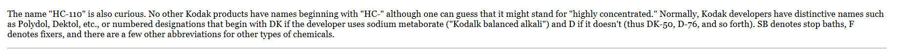

The variation in name might have something to do with the current licensee for Kodak branded photo-chemicals no longer using HC-110 as their product name:
I guess I'm just totally out of touch, because I never heard of your well known resource, either. ;-)
The Kodak data sheets for HC-110 also describe it as "highly concentrated".
It has been around since 1962 - almost as long as me :smile: - and I've always understood that its name and its singular nature relates to its concentration :smile:

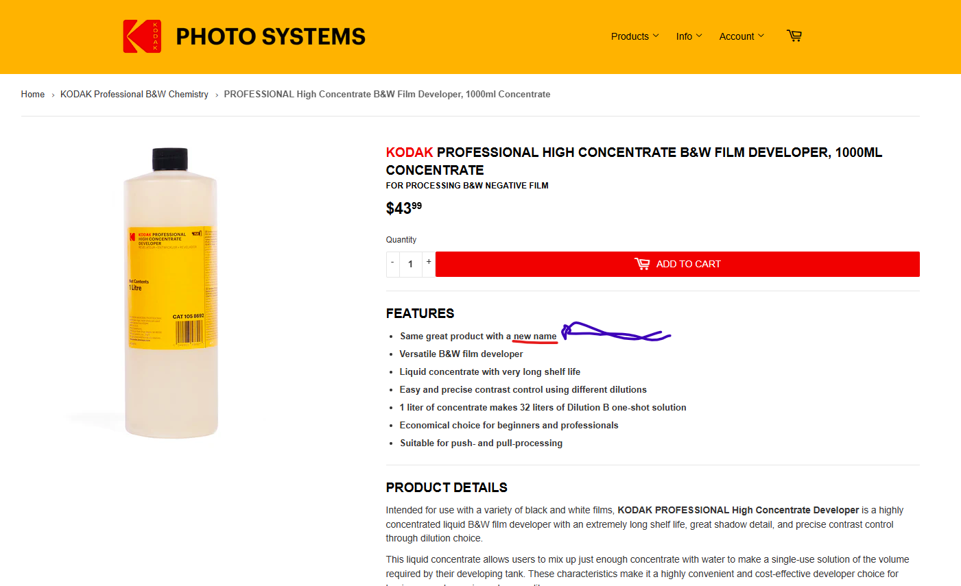

I did find a data sheet for Kodak HC-110, J-24, from Alaris dated Dec. 2017. So far, I have not found a data sheet for the new renamed version.
I am still trying to get my head around the similarities and differences between the several variations of HC-110 developer.
KODAK PROFESSIONAL HIGH CONCENTRATE B&W FILM DEVELOPER
I'm guessing this is a more liquid and less viscous variation? I am basing that on this sentence in the Description on the Photo Systems product page.
"This liquid concentrate allows users to mix up just enough concentrate with water to make a single-use solution of the volume required by their developing tank."
Neither Photo Systems Inc. nor CineStill Film provide a link on their product page to anything like a data sheet or instructions for use.
