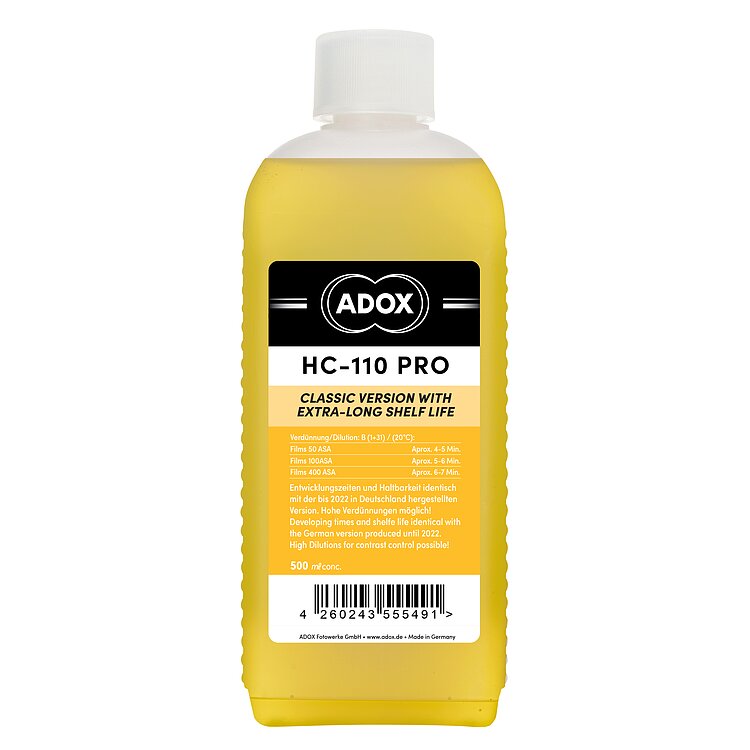

I see that Freestyle is stocking this Adox syrup-style revival of HC-110. That's good news for me.
Mirko,
Would I do better to decant the syrup into glass bottles for long-term storage? I primarily use HC-110 for developing masks so my usage tends to be very slow.
Thank you.

This is never a bad Idea however given the longevidity of the Syrup in combination with our oxygen blocked bottles the effect is small.
My ancient bottle of HC-110 syrup still works perfectly even 1/5th full. But I should probably buy a backup bottle of the new Adox product next time I place an order with Freestyle. I tend to HC-110 mainly in relation to developing contrast masks, highly dilute.
I just developed three rolls of Kentmere 200 in the new Adox HC-110 syrup because I had used up the last of my 15+y/o Kodak HC-110 and the times were exactly the same. This syrup is not quite as thick as my old Kodak developer and was actually easier to draw up with my syringe. Overall I'm pretty happy with this developer, not so much with your FX-39II.
Robert, what dilution and time/temp did you use for the Kentmere 200?
I used Dilution E (1:47) for 8min at 68 in Paterson tank gentel inversion once per min.
Thanks. I use 1:49, and I did one roll at 8.5 min at 68f. I based that on it being about 150% of the time indicated for 1:3. However, I couldn't judge the results accurately because I'd accidentally overexposed the roll. But it's good to know I'm on the right track.
Manufacturing the original HC-110 “syrup” is complex due to its thick consistency, which requires extra time for pumping and filtering. Therefore, the ADOX product is more expensive than the alternatively available thinner variant - as an upside, boasting a basically infinite shelf life.
