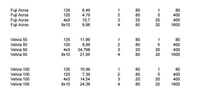

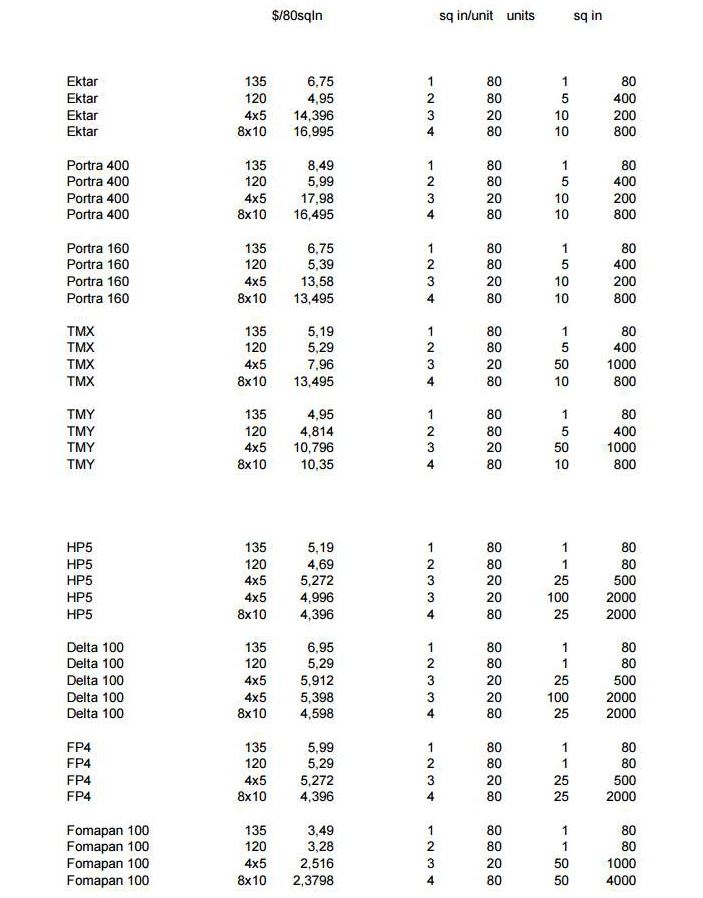

Today (B&H) TMY 8x10 sheets are priced $8.5 each. In 2017 I gathered US film prices in all formats, and a sheet was $10.35, funny it's like this after those price increases:
(For the record, 2017 film prices for different formats, second numeric column from left is price per 80sq in)
View attachment 241759 View attachment 241760

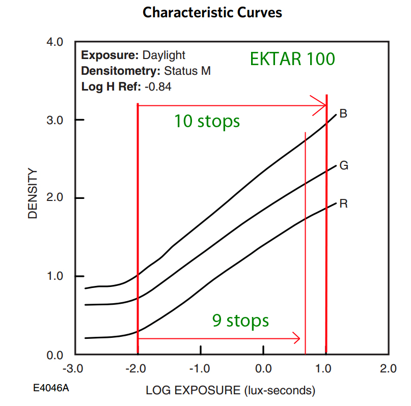

Essentially, the published curve set for Ektar .....seems to suggest that you get about 7 stops of straight line,
Those published in the datasheet (at least) are straight from H = -2 to +1
This is 3 H units that are exactly 10 stops, isn't it?

Ektar : No way you get 7 stops linearity if you expect clean dye curve independence; crossover will set in one extreme, shouldering the other. I'd say realistically, no more than one stop either side of what you'd normally expect from a mid-contrast chrome film like Provia or E100. One of the hardest conditions to correct is split lighting under deep blue sky where the sunny area fine, but you get an exaggerated cyan blue in deep shadows. I have a flashing filter containing a diffuser sheet, a strong warming filter, and an ND amounting to about two stops, and use this to flash the exposure using an 18% gray disc, so effectively a Zone III warm flash involving mainly the shadows. In other cases a warming filter alone works, depending on the exact scene hues affected. Of course, if the color temp is affected all across the board, like under an overcast sky, simple warming filtration at the time of the shot works. Trying to post-correct it might become a nightmare because there will be a range of values already cross-contaminated. It's very difficult to un-mix mud once it's made, if you will excuse my personal term for that predicament. The published curves only take you so far, and then you need to understand in a practical manner the dye idiosyncrasies. But those curves themselves do give a strong clue just how different this film is from traditional color neg films. Most people who see my own Ektar prints don't even believe a color neg film was involved. And it's not just a matter of saturation. Lots of previous CN films have been souped up to deliver certain hues more brilliantly, but always at the expense of something else. Ektar is quite a step ahead in terms of overall control, though not a perfect replacement for chrome films by any means, yet in other ways, even better. For example, the extra margin of exposure range is truly helpful. And married to current RA4 papers, it's certainly easier to tame than printing chromes on Cibachrome was.
There's a pretty high likelyhood we're talking about differences between staying completely analog and actually scanning the film. When scanning, if you know where the inflection points on the curves are for each color channel is, it's pretty straightforward to deal with and straighten each color channel back out so that it is more or less linear depending on how precise you measured each curve. It's not perfect, but it looks a whole lot better than not doing anything about it and having "mud" (in your parlance), and more importantly extends the amount of recoverable latitude. Again, not perfect by any means, but is the difference between delivering crap scans to a customer and actually delivering something they won't complain about.

Ektar : No way you get 7 stops linearity if you expect clean dye curve independence; crossover will set in one extreme.
Drew, Ektar has 10 stops sensitometric linearity, at least 9.
It is true that from +4 overexposure colors shift slightly to yellow, delivering some nice warming effect to highlights, I guess that this nice effect is by design, not a flaw, as Kodak would easily avoid it if they wanted, anyway this can be easily corrected in the hybrid if you don't want it.
Kodak graph speaks on its own:
