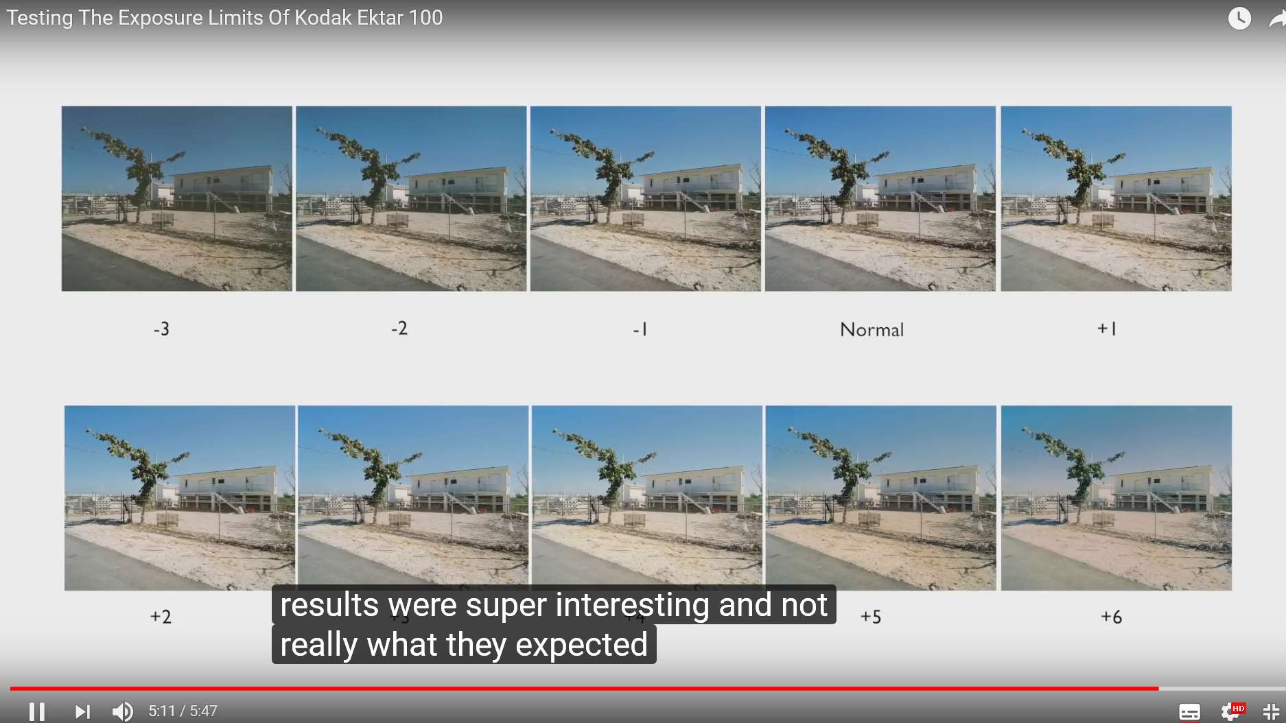

Bellow you may learn what Ektar exactly does, of course the +6 overexposure test image has color shifts (that can be corrected), but in an average metered +6 overexposure you may have areas at +9.
Anyway, this youtube video is exactly consistent with what I found.

For urban legends saying that "it cannot be overexposed" that +4 overexposure result is quite disturbing :smile:

Typical half-baked web nonsense. First, he picks a lens with serious falloff, which tells me he doesn't have a clue how to do an objective test. No standardized chart or lighting, no color temp meter, no actual printing, and worst of all, an untrained eye. Just a lot garbage-in/garbage-out rushed want-it-by-yesterday BS. The fact that you reposted it doesn't lend much credibility to your own opinion. Any worthy test involves a thousand times more work than that pitiful video.
Bellow you may learn what Ektar exactly does, of course the +6 overexposure test image has color shifts (that can be corrected), but in an average metered +6 overexposure you may have areas at +9...
My view is that graphs in kodak datasheets are totally exact, densities mostly linear in 10 stops and some creative color shifts for +5 and +6 overexposure. Not that weird that you have some shift at +6.
Why would you test for such gross overexposures?
No problem, compare the image centers... no fall-off there.
just a lot of hurried garbage-in/garbage-out BS.
A 10 stops bracketing, not a lab test but a practical test, showing real results in practice.
No need to throw rude words aganist that test, point no you have no other argument to discredit it.
Anyway I can show you a dozen of exposure tests pointing the same, so perhaps you may evaluate again what Ektar does.
I'm not being rude. It is what it is - a worthless shoot-from-the-hip pseudo-test. My argument is that I know what real tests actually consist of, and that isn't even remotely one of them. As for falloff, it means there would automatically be center to edge color shifts, and not just density falloff, as he progressed further and further away from optimal exposure. That he didn't even seem to notice these tells me he wasn't looking at any of the results seriously.
One has to know how mediun works if wanting to take advantage from medium capabilities when situation is challenging.
There are scenes with high dynamic range, and sometimes we want to preserve highlight detail in glares to help volume depiction.
It is important to know at what overexposure/underexposure an spot is to be degradated. If we want to record well some shadows we may have to overexpose other areas in the image, understanding what happens allows to balance an optimal exposure: recording well shadows while not damaging the rest.
Frank, do I have to explain you that? Really? Suposedly you had to be aware...
I don't know in your country, in mine arguing about defecations from bulls (BS) is considered rude and other that I won't mention...
If you personally make a similar 10 stops bracketing you'll find the same.

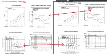

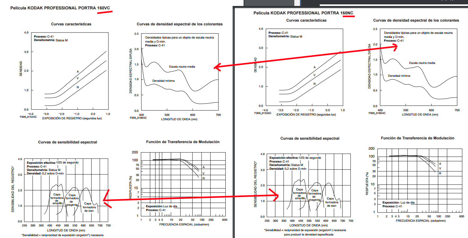

OK then. Show us how you'll do this. I'd like to see you convert 160VC into NC.
My point was that two Porta flavors were less a need as vast majority of C-41 film is scanned and by common digital processing the image can be controlled beyond the different nuances the two flavors had.
Anyway, if you want a NC vs VC matching then you can get it perfect.
The most technically perfect way would be a 3D LUT matching colors in the negatives before color conversion. Scans should be made in reference conditions. ie taking 16bit/c all DR in the scanner with all adaptive enhacements disabled.
See the NC VC graphs:
As Spectral Sensitivity and Sensitometry are exactly matching then difference has to be in the final dyes. So advanced colorimetric Math says that a Perfect match can be obtained with a 3D LUT and that it's a kid's game, if mastering 3D LUT colorimetry.
From that evidence, just applying a bare 3D LUT to the raw scan you would have a totally matching emulation, not mattering the scene kind or illumination source in the particular frames.
To me it was interesting to learn that Spectrums/Sensi. were the same in NC vs VC, and that simple difference was only in final dyes.
"Characteristic curves" in the datasheets show an slightly different contrast that it has to come from the final dyes (rather from halides and filtration) because spectral sensitivity is matching. This allows a perfect matching with a simplistic technical approach.
If spectral sensitivity was different (it isn't) a general perfect match could not be obtained, because depending on illumination and on subject spectral reflectance a different 3D LUT would be required for each particular situation.

You don't walk in the door, load a different film base, flip a switch and watch it go assuming everything is fine. Changing out a subbing layer for mass production coating is not a trivial industrial engineering task, and I don't know why you believe it is.
Production scale chemistry is not 'mix a gallon and we'll correct the next gallon if there is an issue' kind of thing, and what works for a gallon jug of something on a lab bench is not guaranteed to work in hoppers with a hundred gallons of the same chemistry. If something fails during production-scaling, then you're out the cost of an entire batch, and the cost of that batch has to eventually be eaten by all the batches that eventually DO work and can be sold as a viable product.
Have you ever worked in a factory setting, that produced anything?
Yes, me I manufacture industrial equipment, as small company owner.
Do you have experience in establishing quality control for something even as basic as a box-folder?
Yes, the equipment I produce in my company it incorporates complex Machine Vision systems, with some 1 million C++ personally hand written lines, also incorporating several kinds of machine intelligence for QC: expert systems, neural neworks, genetic algortithms and several kinds of less popular machine learning algortihms it won't be worth I mention you, but if you want I can explain you.
Another discipline I master in practice is chemometry, having implememted inline PCA/PLS to predict chemometric content from spectral footprint.
Production scale chemistry is not 'mix a gallon and we'll correct the next gallon if there is an issue' kind of thing, and what works for a gallon jug....
I'm well aware, I deal professionaly with such kind of things.
_______
I only ask you if you are able to mention a single specific emulsion modification that's needed to coat LF. Do you know a single one? What emulsion modification are you talking about ? Let me know it !!!
Because if you can't point a single one... what are you talking about ?
The reason that you are defending the minority opinion is that you are just wrong.
Ok... What emulsion modification are you talking about ? point it !!
You won't be able...
