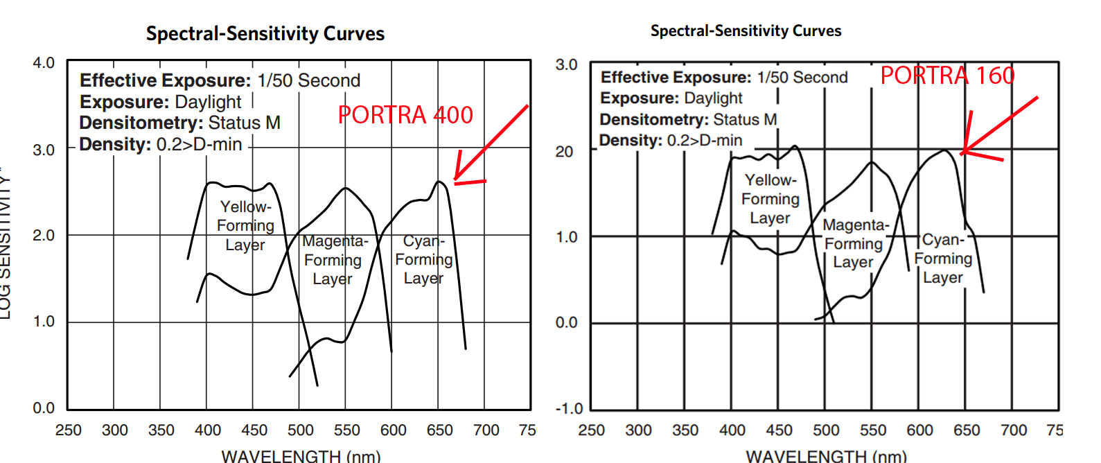

Portra 160 vs 400 cannot be totally emulated because spectral response is different, a 3D LUT (or other) may work in certain conditions but if you change illumination or subject's reflective spectral nature then you may have a mismatch.
Look, Portra 400 has a different spectral sensitivity in the red channel than Portra 160:

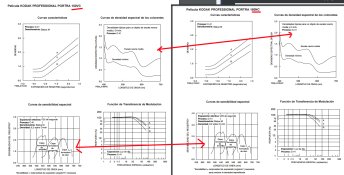

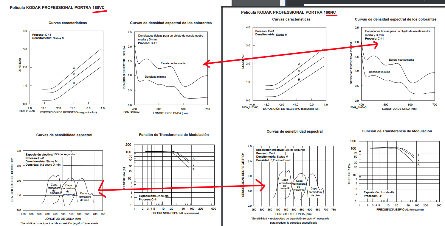

Instead Portra 160 NC and VC had the exactly the same spectral sensitivity, wich allows a perfect match with a 3D LUT
Some colorimetric concepts require math that's not basic.
After first Developer both NC and VC will deliver the same metallic silver densitities in each of the three color layers, at this stage color information is encodeed in a (math ) 3 dimensions real space, 3 optic densities and no spectrum, let's call XYZ those three densities encoding color in that intermediate stage.
1st developer seen as a transfer function is a Surjection in what for each (exposed) spectrum reaching film you have a point in a XYZ. Spectrums are in a Space of Functions, the Surjection assigns an XYZ point in the 3D real space for each exposed Spectrum. It is a Surjection because several spectrums may deliver the same XYZ, but you can't recover the original Spectrum from the XYZ values, let me reiterate that XYZ are metallic silver densities for each of the 3 channels at this stage.
If you consider that Second developement plus scanning is a "blackbox" transfer function, here you have a Bijection, for each point in the XYZ silver density 3D space you have an RGB point in the sRGB space, no information is lost because transfer fuctions are Monotonic in the cross-channel sections, so you would be able to recover the XYZ point from the RGB value.
In the Portra NC vs VC you start from a common XYZ point and you end in two RGB values, one for NC and another one for VC, each of the transfer functions are Bijections, so also there is a Bijection maping RGB in the NC space with RGB in the VC, this means that a 3D LUT will perfectly map NC vs VC, not matering illumination kind or subject's spectral reflectivity, because this only changed the XYZ value that is the same for NC than for VC.
Instead this is not possible in the Portra 400 vs 160, because we depart from different XYZ spaces from different spectral responses.
Those theoric concepts are ususally not much needed in pictorial practice, but we the technicians that work with technical LUTs we need to have those concepts very clear.
There's a rather fundamental problem here: spectral sensitivity provides no indication of colour contrast behaviour. You could change out the couplers between emulsion sets and get wildly distorted colour, but the spectral sensitisation wouldn't change. What those charts show is that the peak spectral response from the emulsions is correct for normal colour photography - not how the dye couplers will actually respond. As you should be aware, the couplers are dispersed long before spectral sensitisation is carried out - they are discreet processes, but obviously the dye sensitisation choice has to match the coupler colour for the film to work correctly. The discrepancy may be because both films use a similar/ identical red sensitising dye, but if it uses (for example) J-Aggregation enabling a green sensitising dye to instead sensitise to red owing to iodide content, differing iodide levels in each set of red sensitive emulsions may be the rather more straightforward cause.
What I'm talking about is the effects of choice and contrast of the couplers themselves & their impact on the 'look' of the film. In fact Kodak have apparently had quite sophisticated computer modelling of colour contrast since the 1980's & there's a whole succession of patents covering varying approaches to digital post-production long pre-dating when 1st generation Portra would have entered product development (possibly even before the Pro- series that pre-dated Portra). By the time Portra came along, digital post-production was well established & yet no fewer than three colour contrast variants were initially launched. As Drew effectively suggests above, a digital model will only sort-of take you in the right direction, before the complexities of the manufacturing process may introduce all sorts of odd subtleties that are challenging to digitally replicate.
All of which comes back to this: as you are assuming that Kodak assumed that people would boost saturation etc in post production by the time Portra 160 and Portra 400 came on the market, why do they still have quite different coupler colour balances and colour contrasts - one more saturated (but less than VC) and warmer, the other less saturated (but more than NC)? As for why they're both less punchyin colour contrast than the old VC, the answer is quite simple: Ektar does everything better in that regard.

Lachlan, I don't say if one film provides a particular contrast behaviour or not...
What I say is that there is a technical Fact: in hybrid processing VC and NC reponses can be mapped to match, so with the right calibrations and the right software we can exactly match VC result from a NC negative and the counter.
There is another technical Fact: Instead with Portra 400 vs 160 there is no software tool that can do that perfectly, a universal 3D LUT doing that it does not exist.
These are Facts.

Lachlan, I don't know why Kodak designed the Portra 400 red channel sensitivity different than Portra 160.
Also I don't know if the 650nm peak in Portra 400 is a designed feature or instead it resulted from the 400 speed sensitization, what is clear is that spectral responses are different in the red.

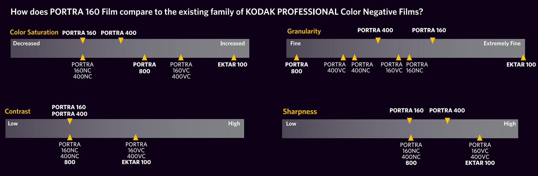

In colour, spectral response matters in a rather different way to BW. It matters in terms of the latitude of the material relative to the colour of the lighting conditions - ie, more cyan sensitivity will help under warmer light sources for example. The couplers formed do so relative to the exposure of the layer in question, so, while light source colour matters in terms of absolute coupler formed (ie under-, correct, over-exposure), the quantity of coupler, colour balance of the couplers, any restrainers added also contribute dramatically to it. As you have done so throughout this thread you are severely underestimating how complex this is, either via a lack of experience or a lack of sufficient qualitative comparators. A blind reliance on LUT's suggests a very real lack of experience in their limitations.
Anyway, this graphic assembled from the Portra 160 sell sheet, should make it pretty clear why the VC films went - Ektar equalled or outperformed them in pretty much every relevant metric apart from speed - and even then, quite a few people overexposed the VC films for more saturation.
It should also make clear that the re-engineering choices seem not driven by hypothetical digital postproduction concerns but rather to offer a broader range of colour choices than previously offered. My own experience suggests that Portra 160 is maybe a hair more saturated than 160NC (and only a hair), but otherwise those charts match what I've found in actual use. It also clearly illustrates that a tiny drop in sharpness may allow a significant drop in granularity in the Portra 160 emulsions (Ektar's structure and lower latitude help it here). It also demonstrates the relationship between granularity, saturation, sharpness and effective visual contrast - all of which are regulated by the specific use of DIR and DIAR couplers etc.
