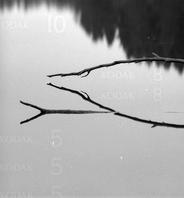

Just in case anyone thinks this is/was an Ilford only problem, this was from a roll of TX that was a few years out of date. This film may have been through an airport machine, I don't know if that would cause this.
This was not your fault or any fault in your handling or transporting the film.
Kodak had a real problem and it's fixed with current stock you can tell by rolls that have the "shiny" paper backing.

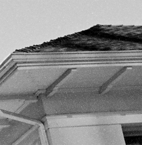

I bought a couple rolls of slightly out of date (like 3-4 months) Acros II from Freestyle a few weeks back and both exhibited the white spot fault
What do you mean by "white spot fault"? The pre-number dots bleeding into the film emulsion? I bought 30 rolls of it and haven't seen that problem yet, but it might not show in the scenes I shoot. I've only shot three rolls of it so far, since I'm shooting mainly Ilford at the moment. Has anyone else seen this on the Fuji Acros sale film from Adorama? JohnW
The fault discussed in this thread… where small white spots show up on the film. Here's a crop from the first and second roll from an Autocord and Fuji GS645w, in that order.
