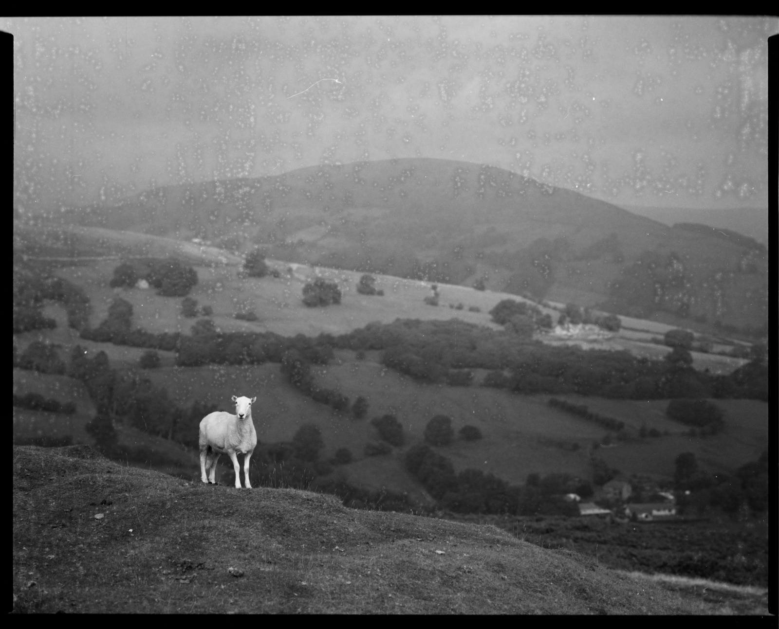

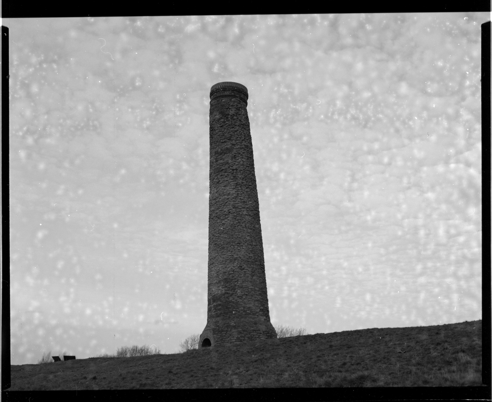

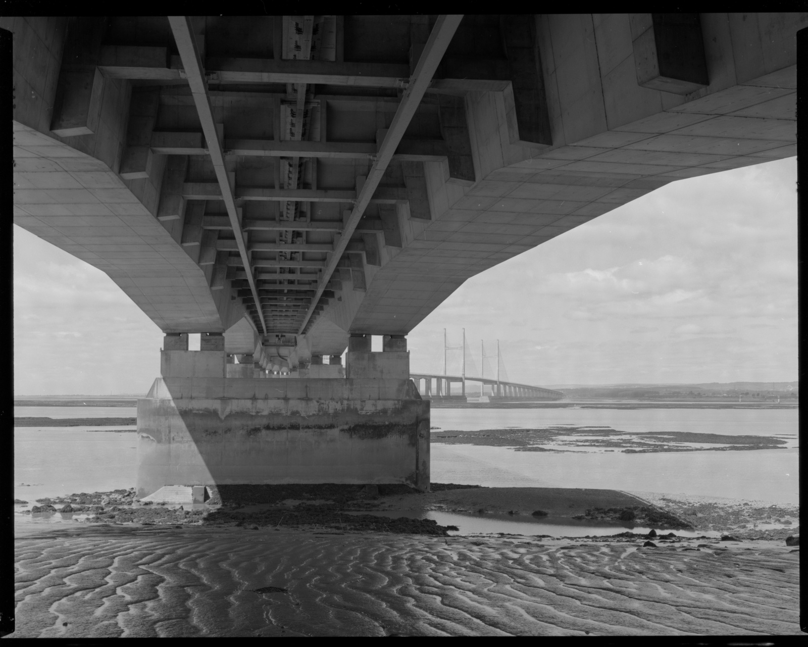

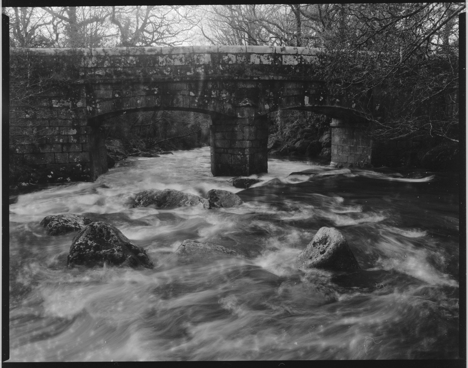

Today I remembered I had a roll of Acros 2 sitting in one of my backs. It's been in my camera bag for ~9months and I haven't shot on it for ~6months. I thought i'd finish it off with some filter test on a scene near me.
Bloody hell.
I have had a slight case of mottling in the past with Delta 3200, 400 and XP2 before. They were there but not noticeable at a casual glance. But my latest case takes the biscuit. Only 1 frame didn't have mottling. Can you guess which one?
I'm not sure but I think this might be the worst case of mottling i've seen. I can only assume repeated transitions from warm, dry house to cold, damp outside caused this.
Bloody hell.
View attachment 306760View attachment 306759View attachment 306758View attachment 306757
It looks to me like even the last one has some mottling, noticeable in the sky...
Yeah, I see that too but it is by far the least mottled. The several shots after this get a lot worse. This was the frame that wasn't in contact with the paper for the long period.

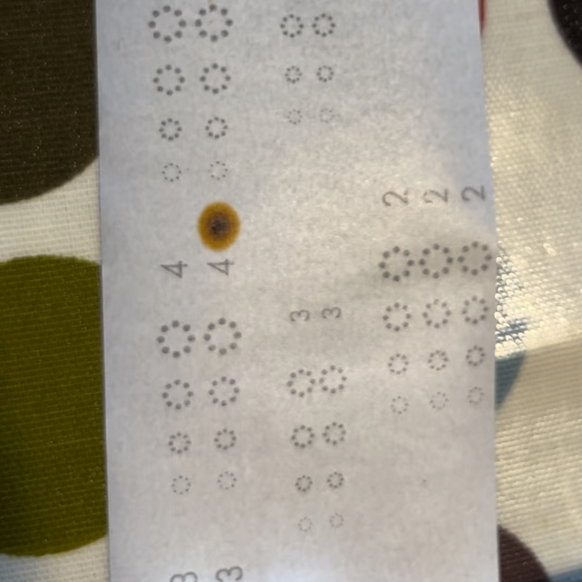

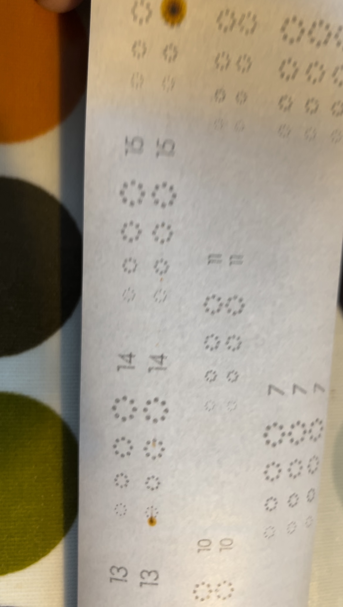

Just developed a properly stored roll today that is a couple of years old. Terrible backing paper issues over almost the whole roll. HP5+
This is the backing paper:
View attachment 324640View attachment 324641
