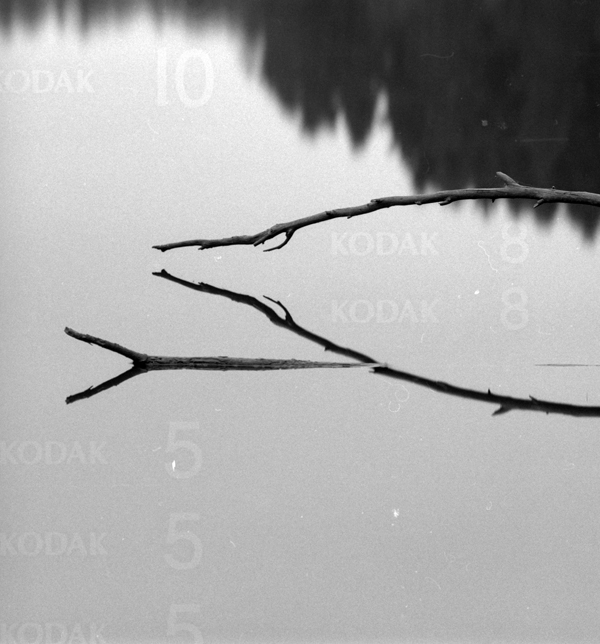

Just in case anyone thinks this is/was an Ilford only problem, this was from a roll of TX that was a few years out of date. This film may have been through an airport machine, I don't know if that would cause this.

markbau, the transfer of the backing paper print image to the photographic image is well known at Apug, and discussed in detail. But it should be differenciated from a paper/emulsion interaction, though the issue is complex.
Interesting too is that Harman admit that it is a new problem.
At Apug we have discussed if a matter that in the long past by leading manufacturers was described as only coming into existence at utmost extreme storage conditions, and not even mentined in magazines etc. now has been become a problem sheer to more awareness and communication in times of internet.

I know it has been discussed for a while but I never took much interest in it until it happened to me. I don't understand what you mean when you say there is a difference between "the transfer of the backing paper print image to the photographic image" and "paper/emulsion interaction," Either way you end up with an unusable neg. I've been using 120 film for about 35 years and only relatively recently have I become aware of this problem. I only posted what I did as it was starting to look like a "let's bash Ilford" thread. I just binned about 10 rolls of TX, hopefully the fresh rolls of FP4 will not have this problem.
Yes, spoiled is spoiled...
But some of us engineering guys like to banter about artefacts and their causes. And then mottling of and the transfer of figures and words into a film image may have very different causes, or different causes but triggered by same circumstances.Thus for us differenciating is of importance.
