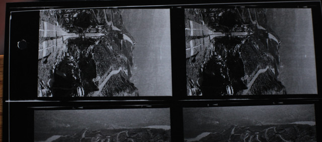

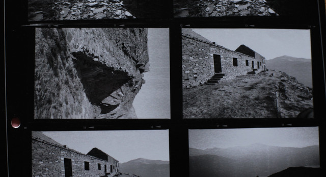

I'll see if i can scan a contact sheet while I'm at work tomorrow. But I haven't been near an airport for a few years.
It's a soft ( diffuse ) mottling/streaking that's most visible in the skies.
Can you see if the mottling is on unexposed leaders? If you can see it there, then it is most likely a film base issue. I had an issue with HP5 sheet film, where there was streaking on the film base. I put this down to me, pre-washing the film... not recommended by Ilford...

120 Delta 100 , 2019 batch.
Contact prints. Check the skies.
The mottling is also visible in the unexposed film before frame 1 and in-between frames, but is faint and hard to photograph. It's like a modulation of the base fog.
