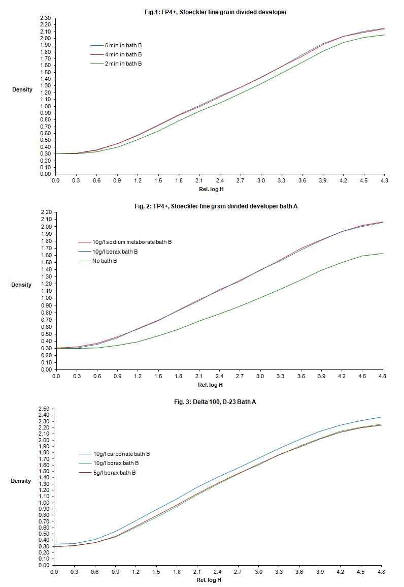

Regarding two-solution/divided development, below are some curves. Some of it is for Stoeckler's two-bath (which was one of the first of these) but the D-23 version(s) including Thornton are only trivially different. Some general results:
-Full emulsion speed (ISO or "box") is reached
-pH and concentration of second bath is largely irrelevant in the context of macro-sensitometry, borax being as effective as metaborate. Carbonate can increase emulsion speed very slightly but also increases fog
-Since the first bath is a fully functioning developer, development time in the first bath is how you control contrast
-Divided development tends to straighten the characteristic curve, and shortens the toe/shoulder
